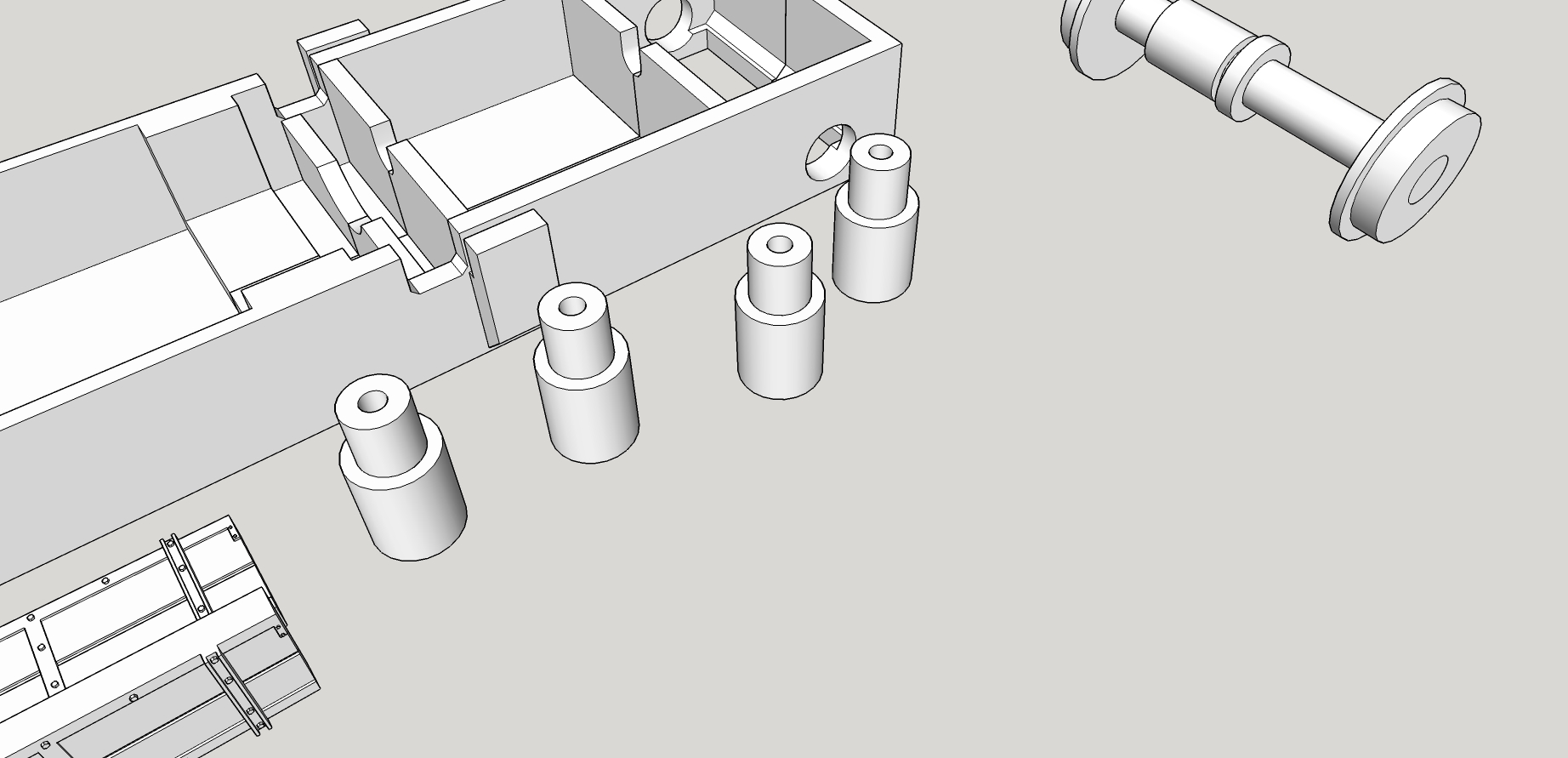

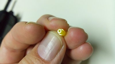

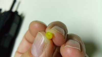

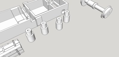

2015-10-27T16:13:00-04:00 2015-10-27T16:13:00-04:00 http://buildyourownsla.com/forum/viewtopic.php?t=4752&p=13600#p13600 <![CDATA[Difficulty printing holes!]]> Projector: Acer P1280
Resin: Spot-A GP
Hi there guys, I don´t know if this is a known issue or limitation of DLP 3D printing but I'm experiencing it for the first time.
I want to print a 3 mm diameter cylinder with a 1,2 mm hole that goes through it but the hole doesn't print right, it prints blocked like there's almost no hole at all. It just shows a bit on each side.
Do you guys have any advice on what should I do to avoid this?
Bellow are some pictures of the problem:
