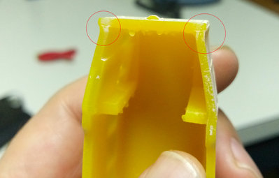

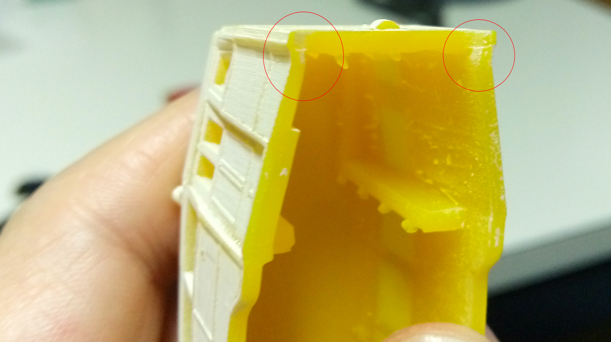

Those globs you see are caused by over exposure as well.

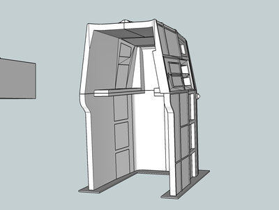

Hi once again guys, got stuck with yet another problem while printing an object. This is the original object:

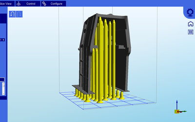

An this is the placement in Creative Workshop (It's slightly angled so that the top is facing the vat):
And now the problem, as you guys can see the sides are curved near the top where they meet the face, this happened with this project and others that I oriented this way. I know I could try other orientations but this is the one the gives the best results overall. Any ideas/sugestions on how to avoid this:
