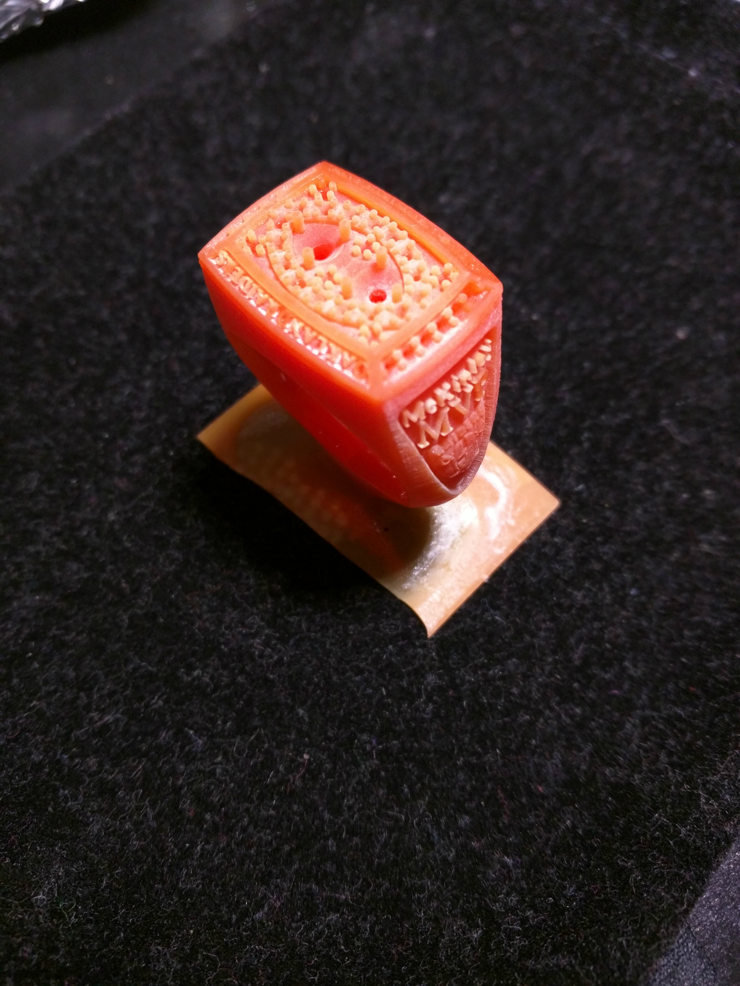

2016-06-21T11:48:14-04:00 2016-06-21T11:48:14-04:00 http://buildyourownsla.com/forum/viewtopic.php?t=5113&p=14881#p14881 <![CDATA[Re: Makerjuice Waxcast.]]>
Here are some pointers that may help:
Build plate needs to be parallel to the vat.
Light intensity - 30 micron Z - 45micron x,y
Insure adequate first burn in layers
Make supports thicker than you would for other resins.
Make sure you have a large enough initial surface layer.
Printed on mUve 1.5 printer. Waxcast
Statistics: Posted by chill74 — Tue Jun 21, 2016 11:48 am
