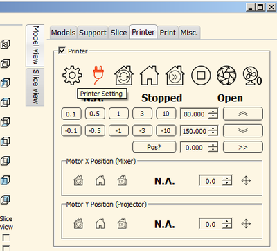

Pixel size; set your XY resolution ,
Thickness um; set your Z resolution
set your exposure timing settings
to set the build plate i manually lower the build plate by hand to zero (touching the fep) and set this position as my home value (at the printer tab)
other functions of monoware should be straight forward enough :)

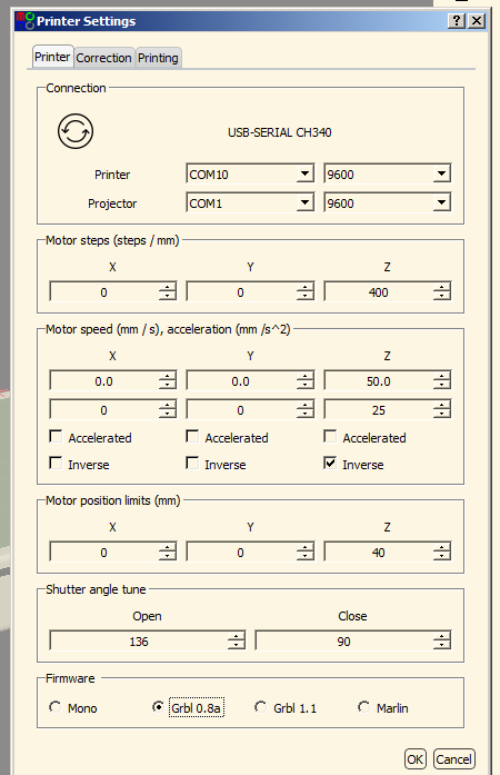

2017-10-08T07:58:02-04:00 2017-10-08T07:53:00-04:00 http://buildyourownsla.com/forum/viewtopic.php?t=8579&p=21942#p21942 <![CDATA[Re: MonoWare for LittleRPs]]>
NOTE: if you set these values incorrectly it will overwrite GRBL and you may have to reset the values again.
I have checked the INVERSE box because my Z is inverted please confirm whether your Z is inverted or not before printing.
motor steps; if you are using tmc2100 then 400 should be the correct value, if not the value should be 200
motor speed; you may set to your desired value
for acceleration; default value for GRBL 0.8A is 25.
motor position; you must set this value otherwise the limit would be set to zero and build plate will crash downwards after print instead of lift.

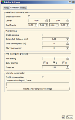

Anti-Aliasing; was recommended to set this value at 1 by the developer of monoware Yun, you can play around with this value and experiment.
Color Channels; must tick the R G B boxes otherwise nothing will be projected
GrayScale; 255
