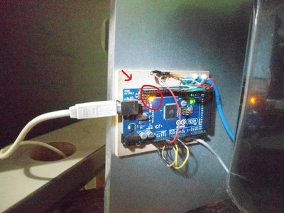

2015-02-27T18:38:10-04:00 2015-02-27T18:38:10-04:00 http://buildyourownsla.com/forum/viewtopic.php?t=2157&p=8591#p8591 <![CDATA[Re: How to move CW stepper motors?]]>
The LED that's always on is just a status LED. It shouldn't be affecting anything (unless you changed its pin).
Also, do you have your X and Z direction on the same pin? Or was that a typo?

2015-02-27T18:15:20-04:00 2015-02-27T18:15:20-04:00 http://buildyourownsla.com/forum/viewtopic.php?t=2157&p=8590#p8590 <![CDATA[Re: How to move CW stepper motors?]]> changed the pinspRAMPS-13 files - I uploaded to the Arduino, but this is with the LED always on.
See photo below, this LED does not turn off ever, and Will not managed to move the engines.
I put as I had here:
X pin 3 step
X pin 2 direction
Z pin 6 step
Z direction pin 2
Just do not put enable because I was not using.
Please see photo below.
