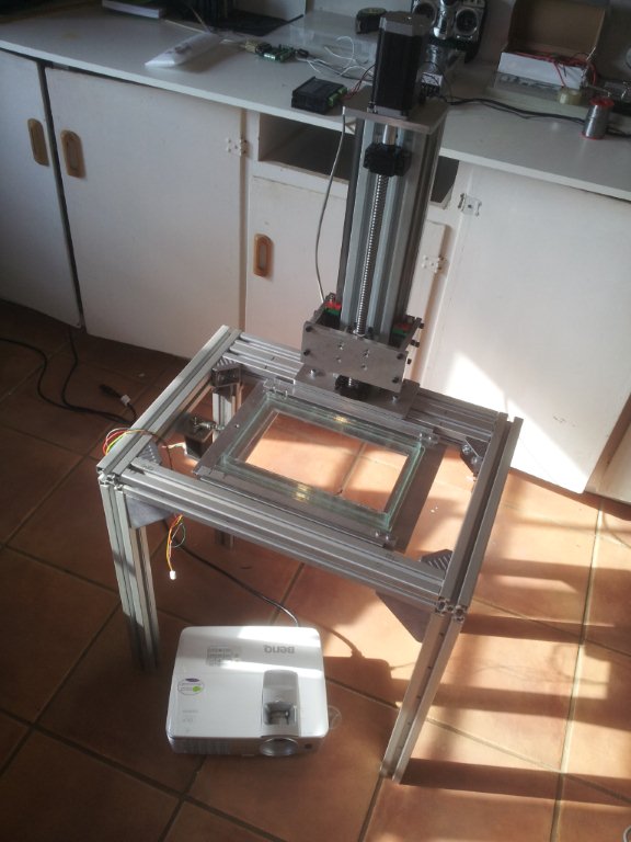

Steve, I have been following the progress on Demtris Ilios printer and have downloaded their Macro for Mach3 but so far I have not been able to get it to work.
I must be doing something wrong but I am not sure that he will be willing to assist me seeing as I have not bought one of his printers.
Perhaps I should ask him and see what he says.
I have also seen your blogspot about your printer project and am impressed with your machine and the good quality of your prints, well done!
Regarding using a ramps based controller like you mentioned, I am very keen to try that out as an alternative to Mach3.
Would you be able to give me advice on what I need to do to make a change to this system? I would be most gratefull if you could.
John, thanks for offering to send me your macro and outlining the procedure. I would definetly like to get a copy of it if you dont mind.
Maybe you could point out where I am going wrong if I need help.
I have uploaded a photo of my work in progress on my machine for all to see.
Greg
Statistics: Posted by gregcoles — Thu Jan 09, 2014 2:39 am
