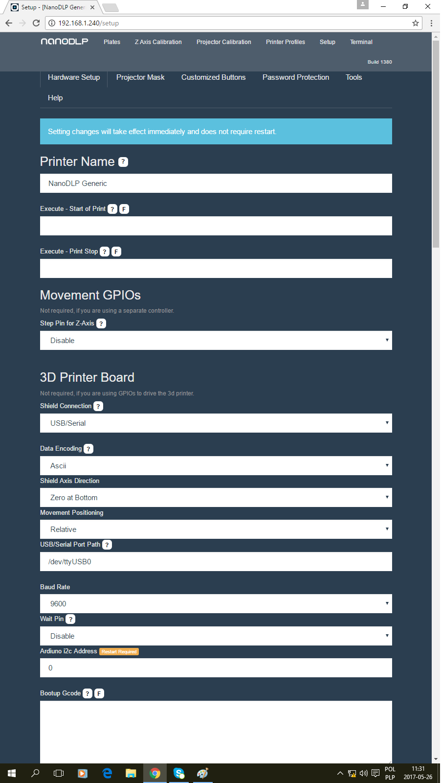

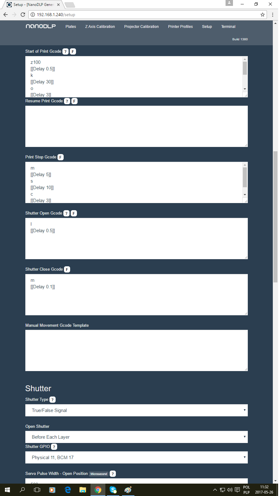

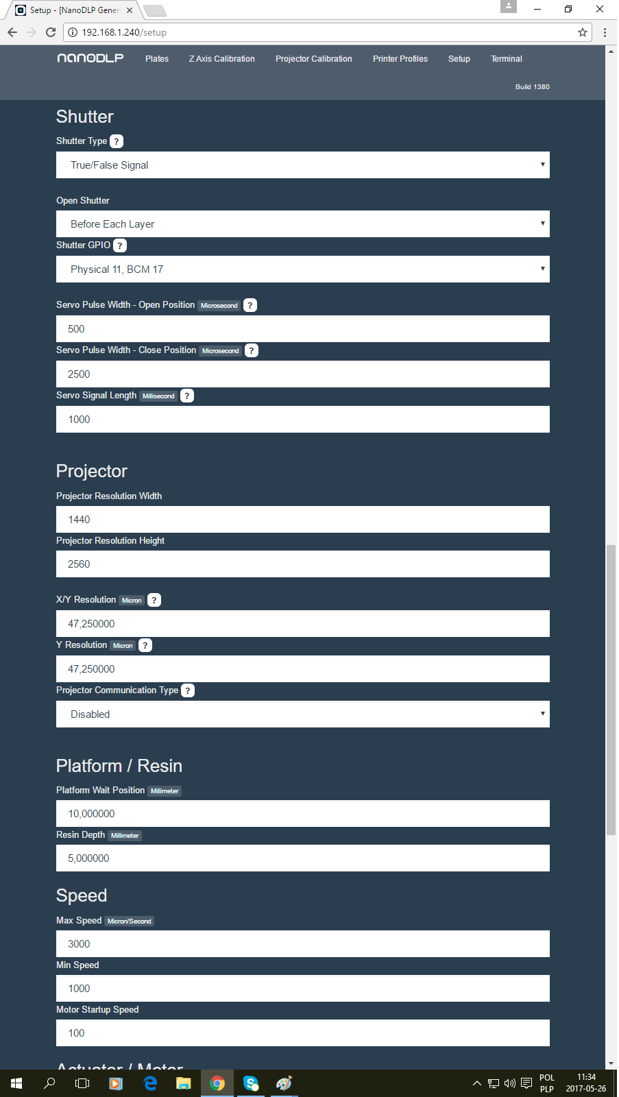

2017-05-26T05:55:28-04:00 2017-05-26T05:55:28-04:00 http://buildyourownsla.com/forum/viewtopic.php?t=5739&p=17988#p17988 <![CDATA[Re: Ez3dx X5.5s - 2k lcd SLA component questions]]>
It is a bit tricky for the Chinese driver as it does not use G Codes.
But it is still possible - nanoDlp is very configurable.
The only thing not easilly possible is to get is "end of movement" message, so there are delays instead.
Note that the resolution is 1440 x 2560 , XY resolution 47.5um
I have also fixed motor speed (100% "z100" or homing and 20% for other movements "z20" )
Start of Print Gcode
z100
[[Delay 0.5]]
k
[[Delay 30]]
o
[[Delay 3]]
l
[[Delay 2]]
z20
[[PositionSet 0]]
Print Stop Gcode
m
[[Delay 5]]
s
[[Delay 10]]
c
[[Delay 3]]
g40000
Shutter Open Gcode
l
[[Delay 0.5]]
Shutter Closed Gcode
m
[[Delay 0.1]]
GCODE Before Each Layer
[[Delay 0.11]]
g{floor ( ([[LayerPosition]] - [[CurrentPosition]])*1000)}
[[Delay {abs ( ([[LayerPosition]] - [[CurrentPosition]])*1.5)+0.1}]]
[[PositionSet [[LayerPosition]]]]
[[Delay 0.13]]
GCODE After Each Layer
[[Delay 0.11]]
[[Delay 0.13]]
