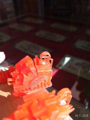

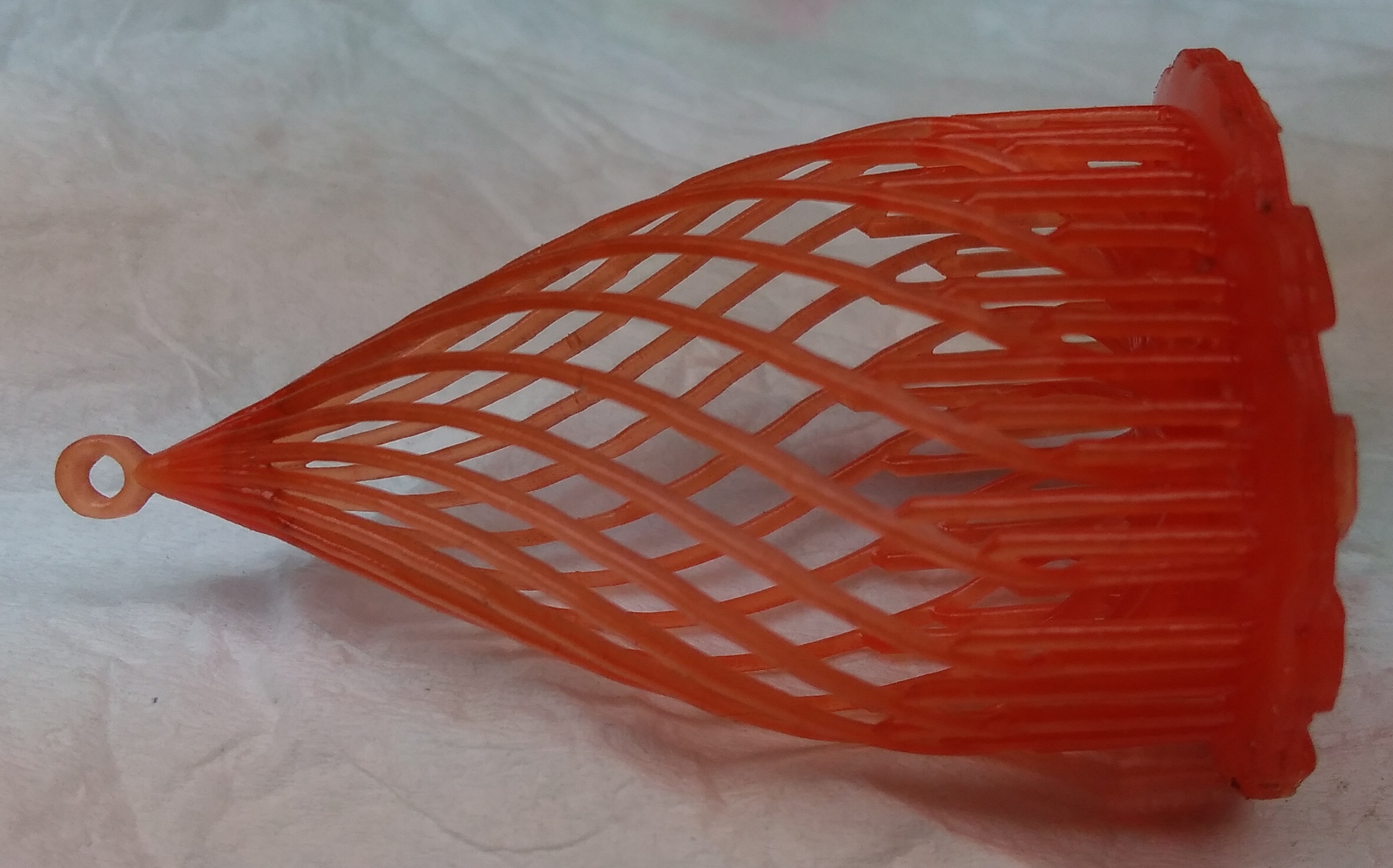

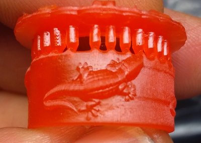

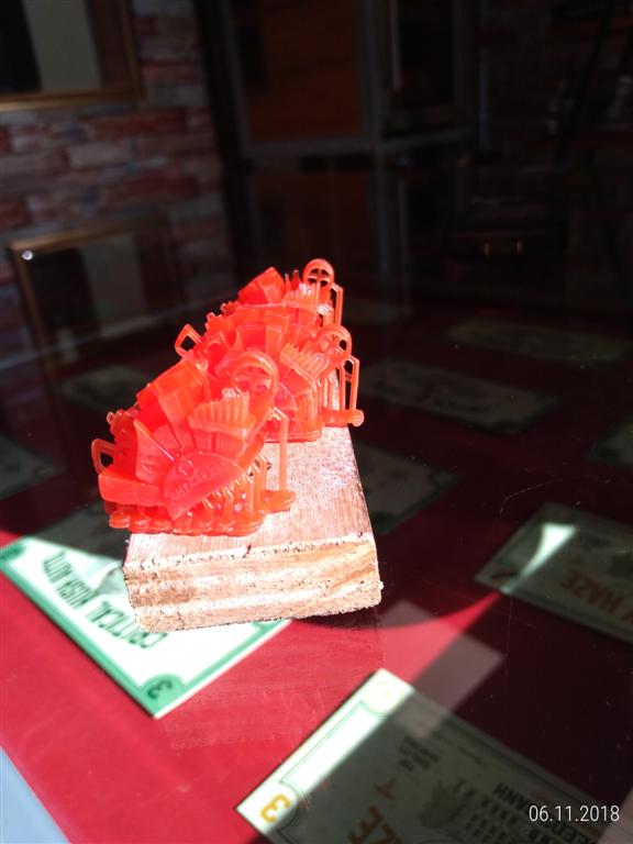

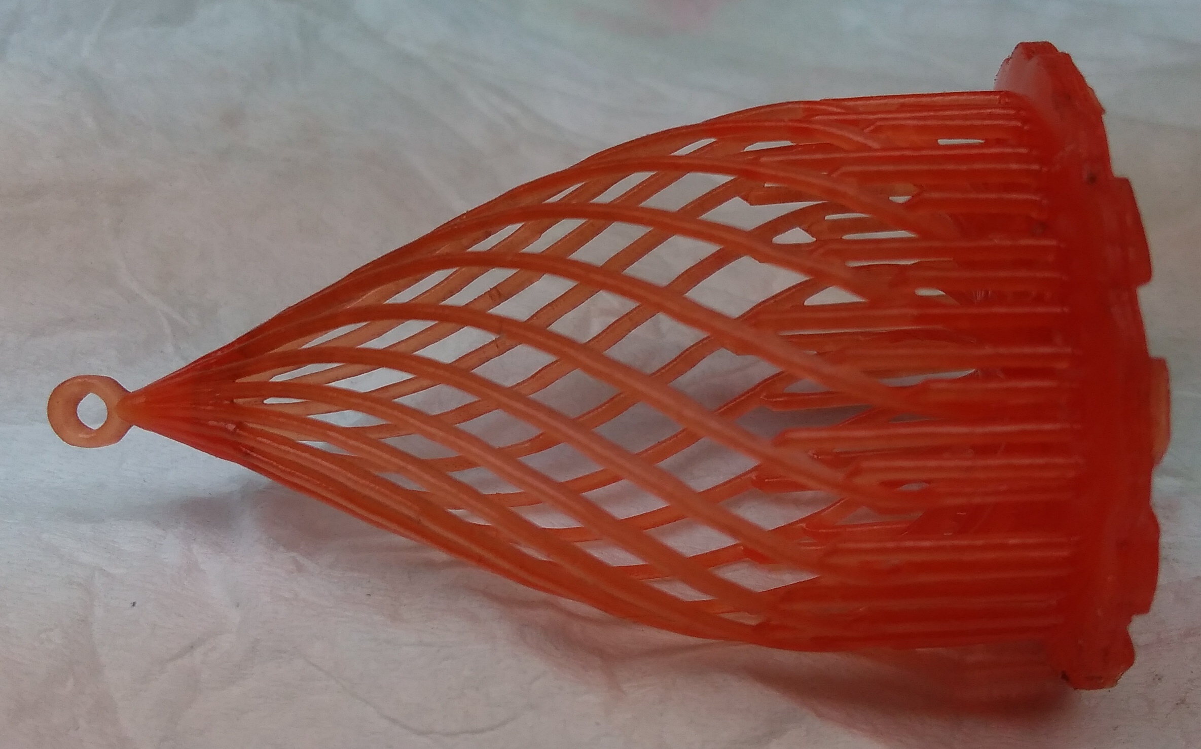

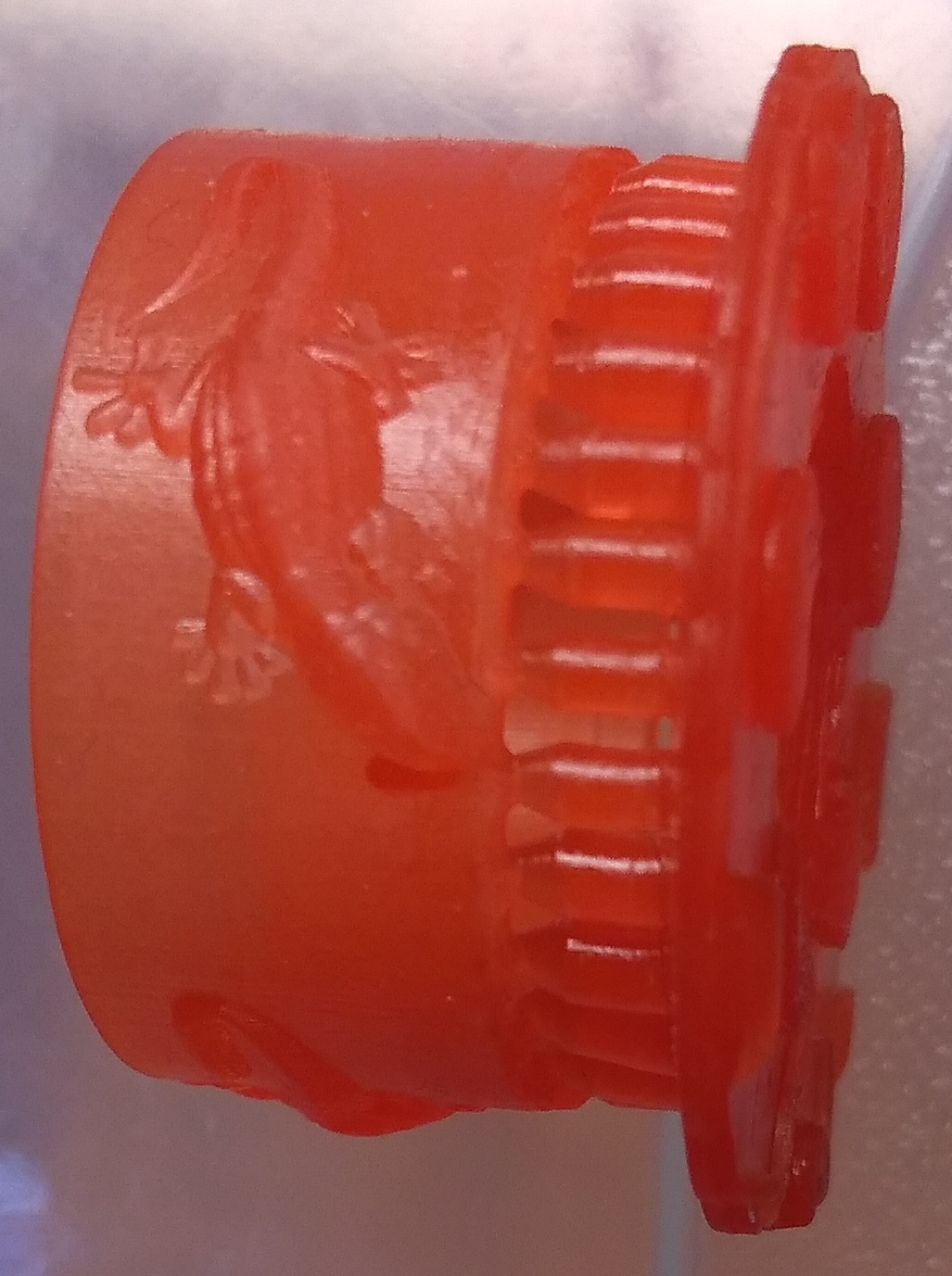

2018-11-06T08:07:15-04:00 2018-11-06T08:07:15-04:00 http://buildyourownsla.com/forum/viewtopic.php?t=12648&p=27527#p27527 <![CDATA[Hardware showcase / Build Logs • Re: 3D printer top-down]]>
Statistics: Posted by CAP257RM — Tue Nov 06, 2018 8:07 am

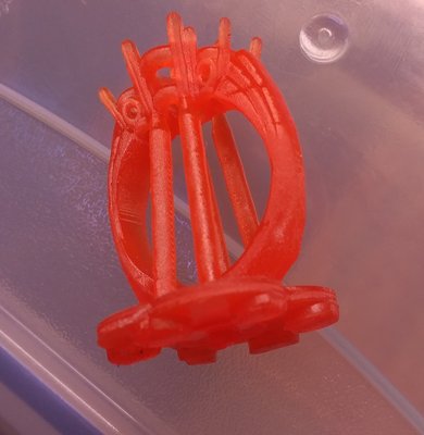

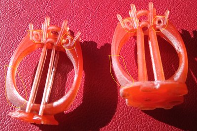

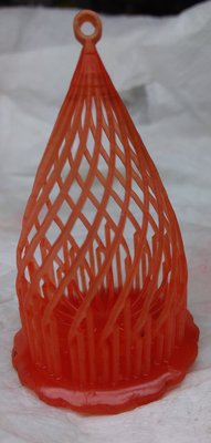

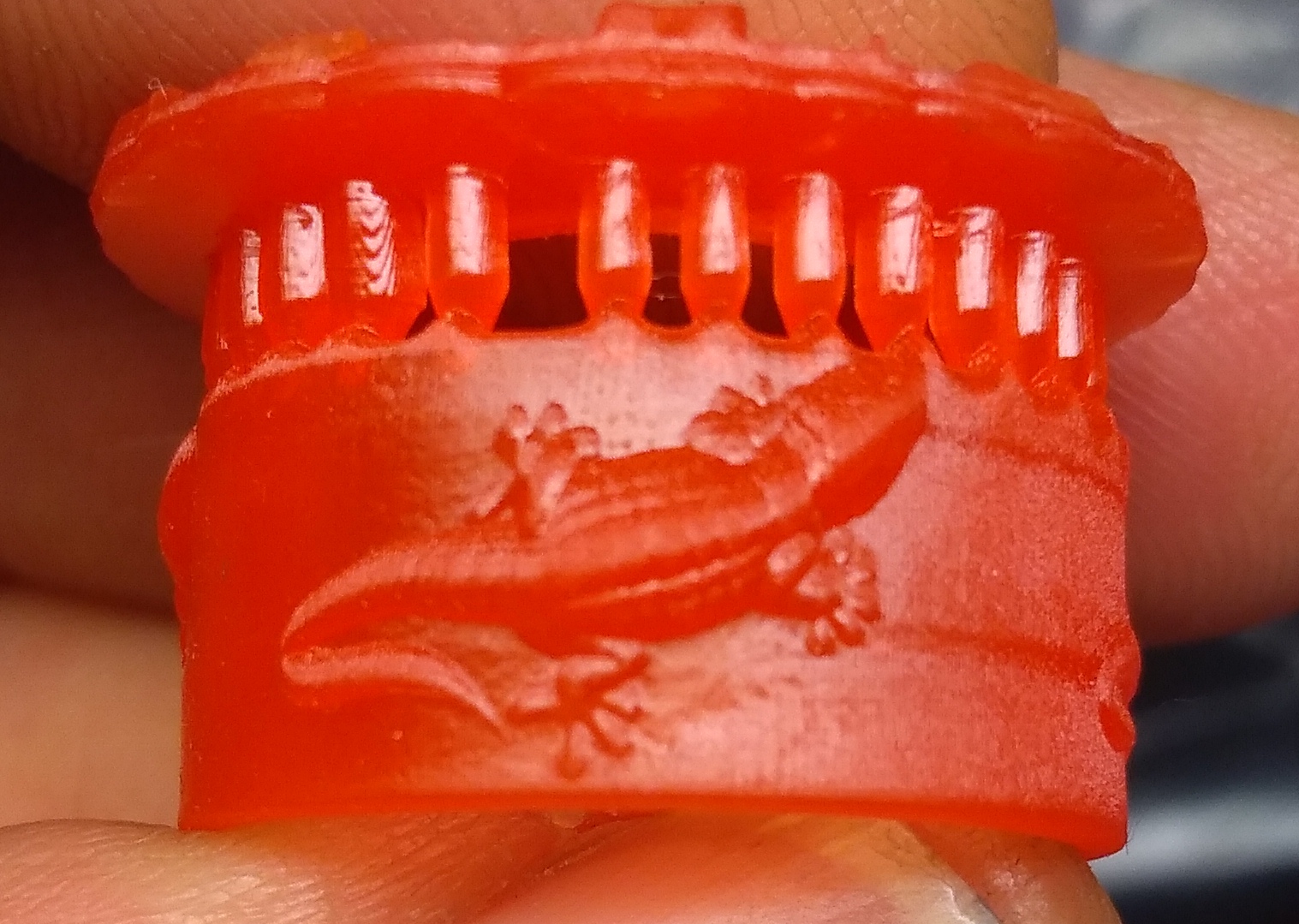

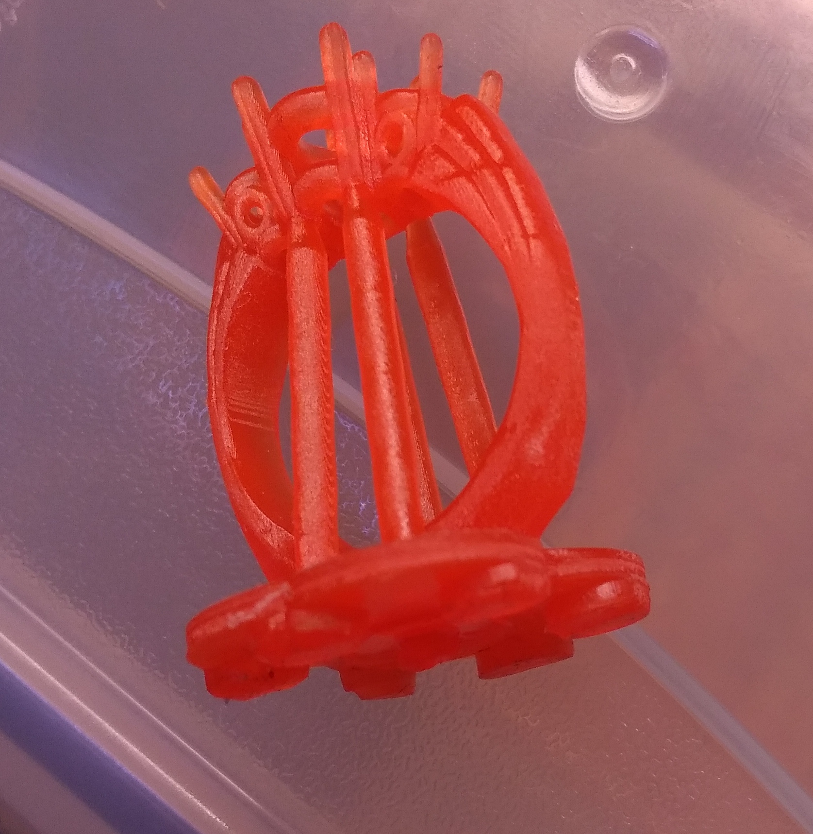

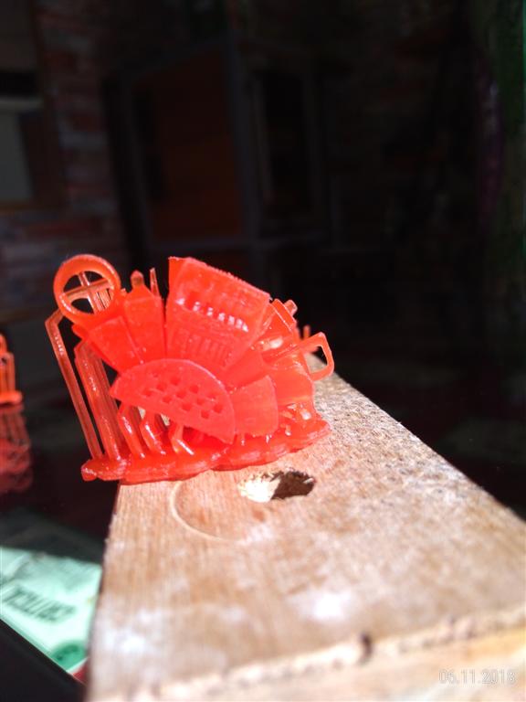

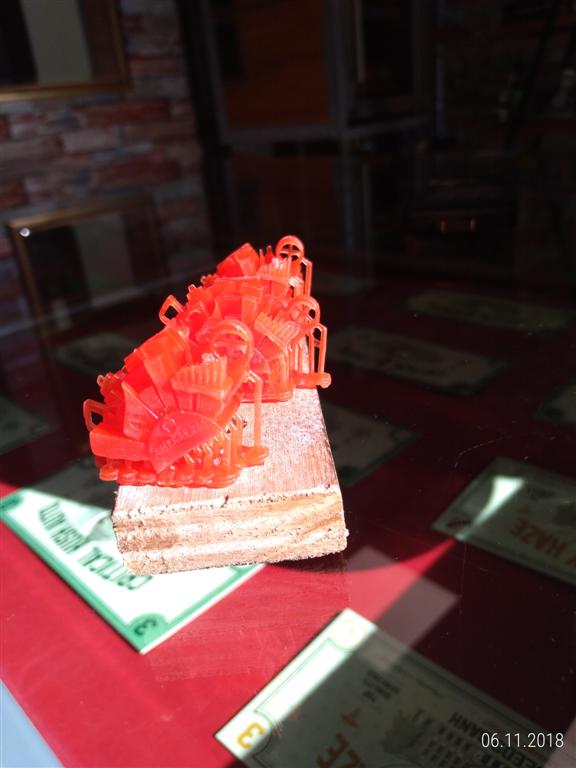

2018-11-06T08:05:28-04:00 2018-11-06T08:05:28-04:00 http://buildyourownsla.com/forum/viewtopic.php?t=12648&p=27526#p27526 <![CDATA[Hardware showcase / Build Logs • Re: 3D printer top-down]]>
Statistics: Posted by CAP257RM — Tue Nov 06, 2018 8:05 am

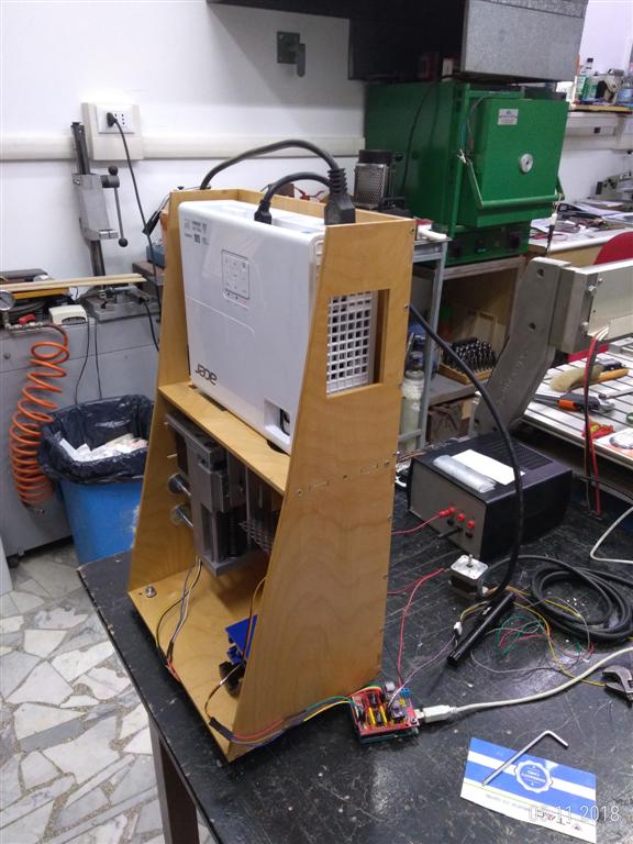

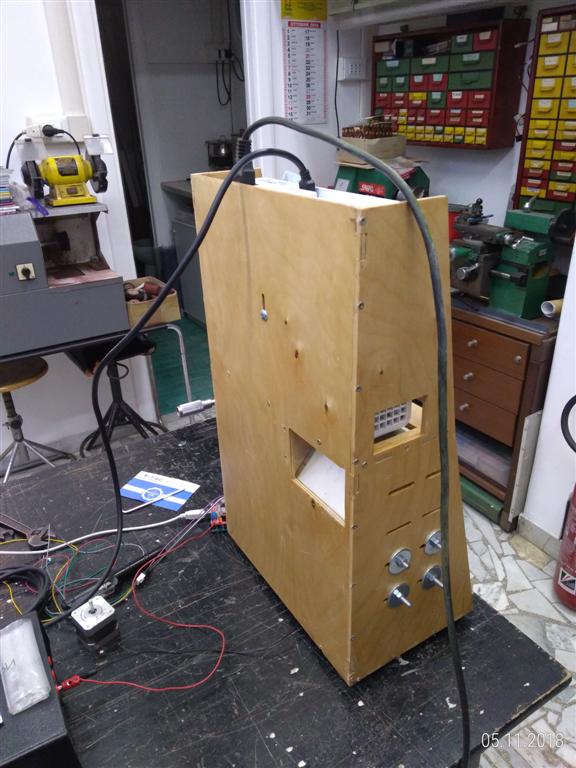

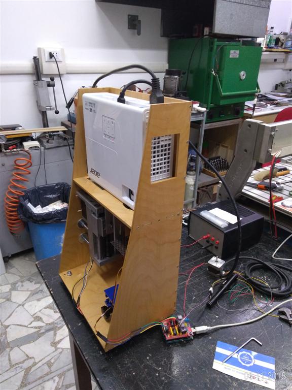

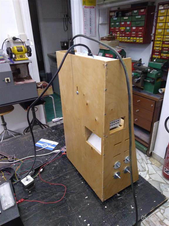

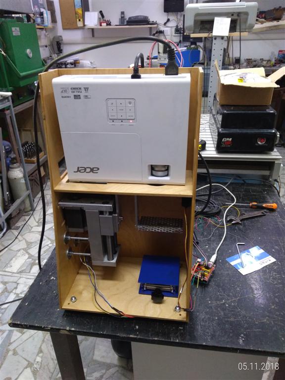

2018-11-04T09:21:16-04:00 2018-11-04T09:21:16-04:00 http://buildyourownsla.com/forum/viewtopic.php?t=12648&p=27525#p27525 <![CDATA[Hardware showcase / Build Logs • 3D printer top-down]]> For the realization I used:
Acer H6510BD projector + mask realized with https://www.patreon.com/GarageScience
stepper motor for Z axis
Z axis and construction platform made with cnc
Hitec HS300 servo (or other) as a shutter between slices
arduino 1 rev.3 + GRBL shield + grbl / servo controller (https://github.com/robottini/grbl-servo)
stepper motor for possible wiper blade installation
resin floating on salt water.
As soon as possible I enclose photos of details of the test prints
Thanks to everyone for the posts that allowed me to make the 3D printer.
Video: https://www.youtube.com/watch?v=398ueGoD7YA https://www.youtube.com/watch?v=63g55VcSehs
