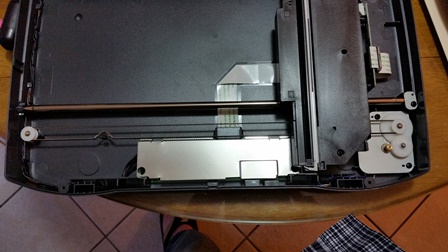

2015-07-06T21:19:02-04:00 2015-07-06T21:19:02-04:00 http://buildyourownsla.com/forum/viewtopic.php?t=3154&p=10886#p10886 <![CDATA[Re: First Build Top-Down getting started.]]> So, I've got grbl loaded on my boarduino and I've got an A4988 driver connected.
My stepper motor is a Neocene 2T354205 12V 5 Ohm 96 step per revolution.
It's connected through 2 gears to a belt drive in my scanner.
After enabling 1/16 step on the driver, and then setting Z=750 step/mm I measure Z300 == ~297mm
I also see the scanner has an optical sensor at the start of travel. Not sure if I want to try to connect that through grbl, since my top-down setup will be dependent on the fill level. Probably need to set the start point manually. Unless I set Z0 == bottom of VAT? Strangely, Creation Workshop won't take machine configuration on my laptop. However, I have a workstation I plan to use that seems to run CW properly?

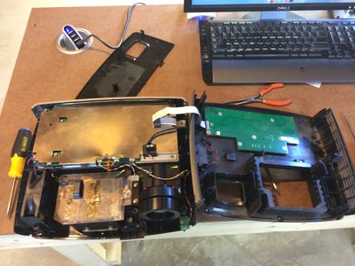

I was checking out me set-up and my projector seems to be switching off? Maybe because of the missing UV filter Glass. I wonder if I can remove the filter from the glass and put the glass back in?

Then one day I turn the projector on and I get a LOT of stuck pixels. I'm not sure it was just the projector, me stripping it down the the DLP chip which could have effected cooling or removing the UV glass and color wheel. I'm doing this on a thin budget, so I've ordered another 2104 and will have it tomorrow. I'll do the same, remove the UV glass, color wheel and add the spacers. I may leave off the cover and add a fan to help cooling.
As a note, after the 2104 failed I got a Dell 1409x. I did the same process and after running for about 5 minutes smoke started coming from the projector. It started to melt and burn the plastic in the assembly behind the lens assembly. In the trash with that one. Giving the 2104 one last shot, otherwise I'll need to save for a proven projector.

The stepper is 12V 5 Ohm with 3.75 step angle with two reduction gears for the belt drive. There is one round shaft that attached to the molded plastic case of the scanner. The scanner claims a resolution of 4800 over the nearly 300mm length of the scan area. I calculate that to be about 0.06mm per step but that's using the scanner. Haven't tried driving it directly yet.

2015-06-23T08:07:28-04:00 2015-06-23T08:07:28-04:00 http://buildyourownsla.com/forum/viewtopic.php?t=3154&p=10614#p10614 <![CDATA[Re: First Build Top-Down getting started.]]> Got the UV filter off because I've heard the IN2104 won't cure Makerjuice with it on. Haven't touched the color wheel. Just hoping I don't need to.
I can get the projector to focus sharply down to approximately 6-7 inches wide without modifying anything else. Guess I need to get some Makerjuice now and start testing exposure times and resolutions?
