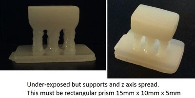

Projector focused well. My build plate sandblasted so it is matte. I cannot add pigment because i cannot find. I said my suplier to increase pigment of resin. Now, im trying to decrease intensity of light with projector settings and increase exposure times.

2015-05-10T16:46:49-04:00 2015-05-10T16:46:49-04:00 http://buildyourownsla.com/forum/viewtopic.php?t=2972&p=9909#p9909 <![CDATA[Re: Printing Poblem (Help)]]> Anyway I had many leak problems at first, main causes are often excessive exposure time, insufficient pigmentation, and support plate reflection. Just try one little change at each print an you'll find the cause.

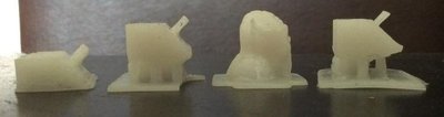

I made my own setup. Acer P1500 projector, Flex bottom VAT (With FEP film). But i have few problems with printing. I use Turkish Resin suplier (oo-kuma).
While printing the light is spread. When i decrease exposure time the problem is not solved. Could you help me please?
