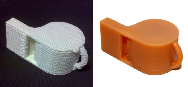

I like to use this photo for comparison (yes the FDM print is exceptionally bad).
