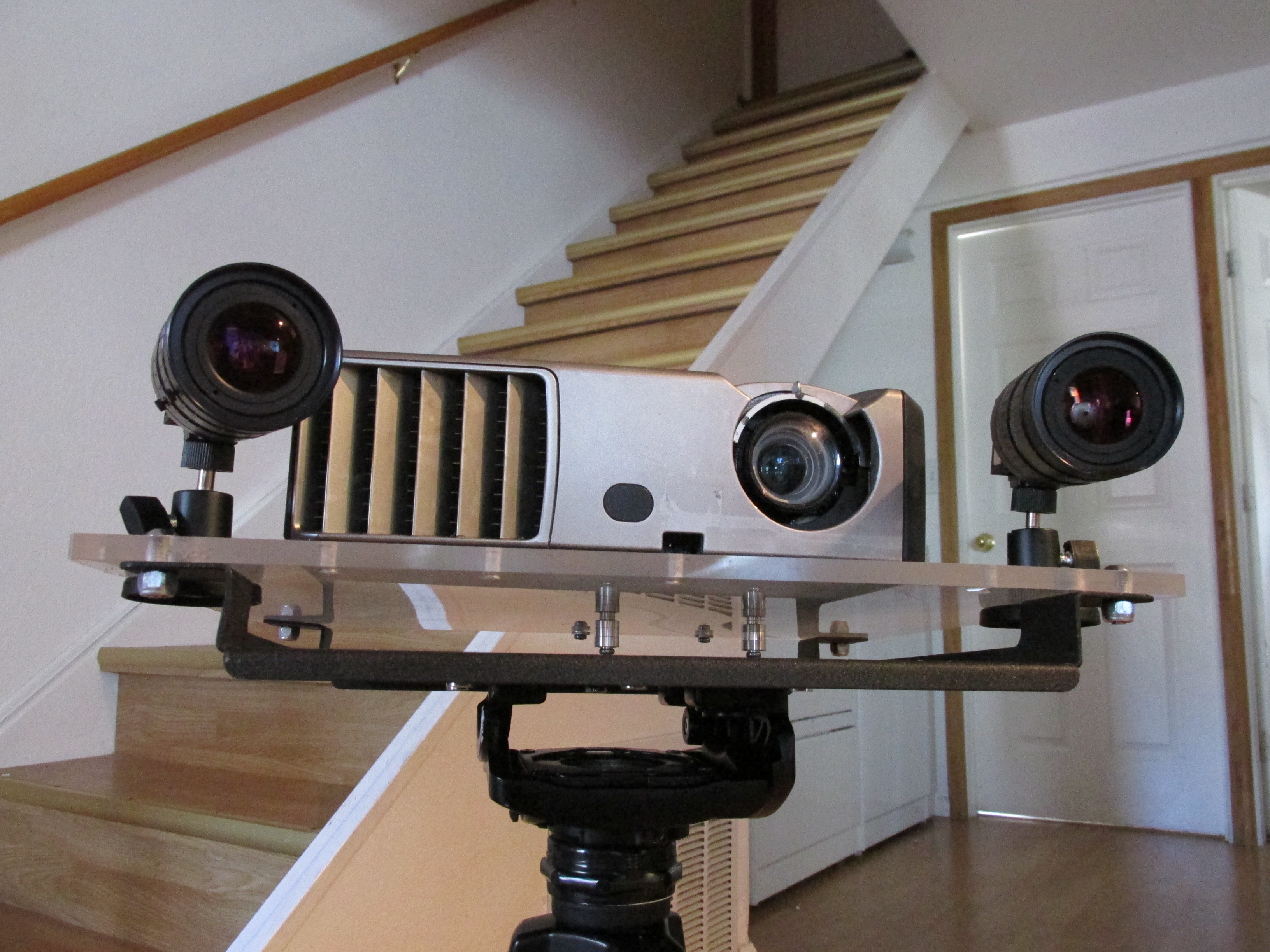

Re: 3D scans.
Finally, my fully assembled structured light 3D scanner.

Re: 3D scans.
do you have any scans you could show us?

Re: 3D scans.
So far the only scan I've been able to do with this configuration for lack of time is this one:
Hopefully I'll be able to run more scans this week.
