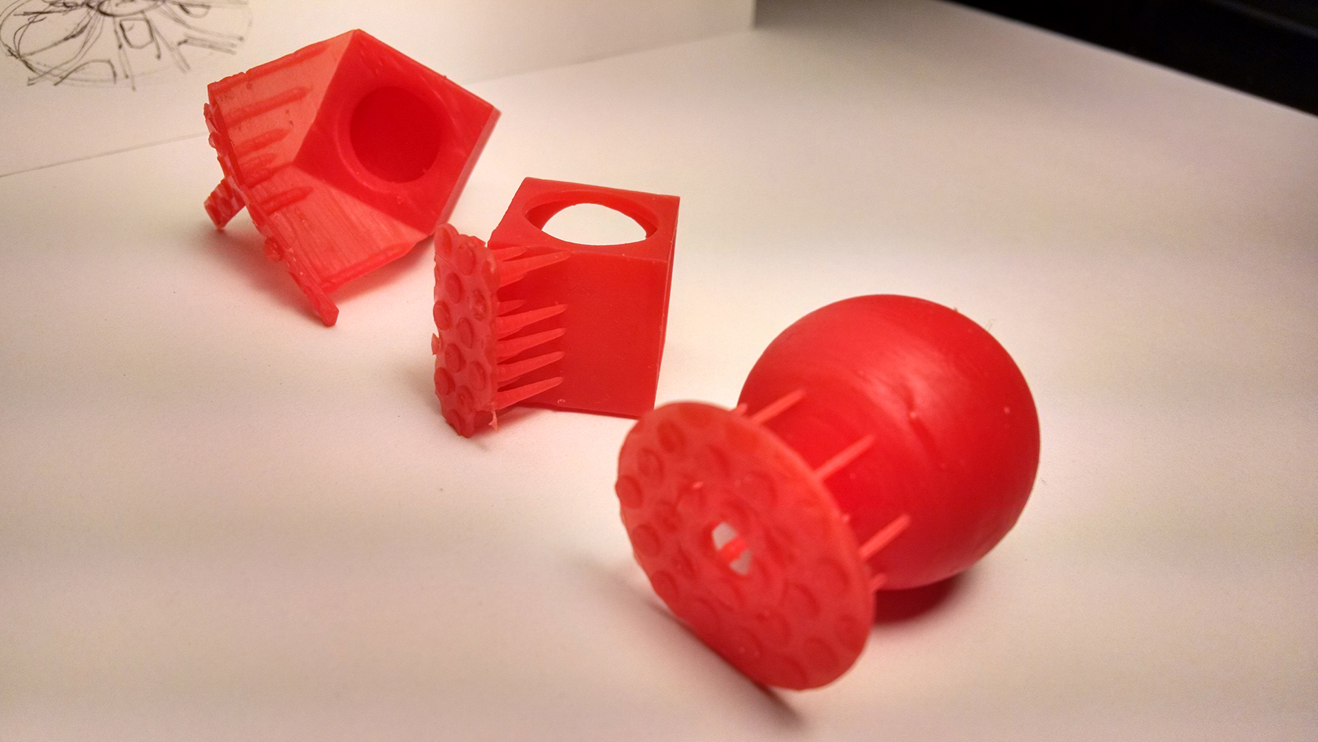

Hi all, I'm running a homebuilt Top down DLP over saltwater and have been struggling with sagging...top sides of my model look perfect but the bottom sides droop down :(
I've tried curing times from 10s down to 5s and it doesn't seem to ever get sharp
Anyone have tips for this?
Thanks,
Vaughan

Thanks for the tip...I've tried adding tons of supports but anything facing down still looks...mushy in general

When you say "droop", does that mean that on the bottom side, there is more solid material cured than you expect?
You may be experiencing overcure/light bleed where the light for a layer is penetrating through and curing the previous (lower) layers.
If so, there isn't really a settings-based solution for that. The only way to mitigate light bleed is to add pigments to the resin mix to make it more opaque and reduce the amount of excess light penetration.

Exactly JKAO. Isnt it weird that its only happening on bottom sides though? Tops side looks very nice and crisp

by jkao
