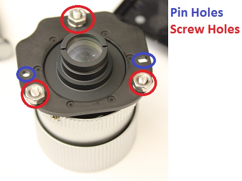

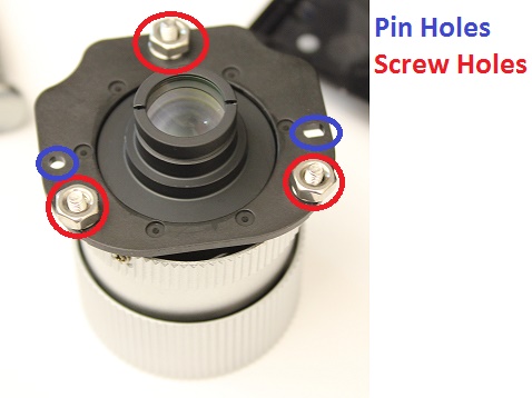

First of all i remove the lens. There are 3 screw hole and 2 pin hole.
I extend them upward for 3 mm. The top screw hole exploded. Then i reinstalled it.
So projector lens is shifted down for 3 mm. Now the light goes out (nearly) center of the projector. So top distortion is decreased.

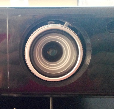

Top hole used but hole is now 'U' shaped.
I captured a photo if it seem.
