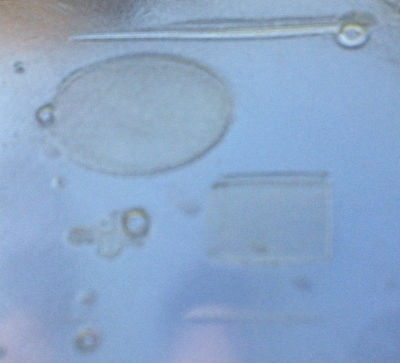

Result of the very first archaic test, just "one layer"...
It sounds promising.
You can see a allipse, a square and a sort of "+" sign on the left, under the ellipse

Hi dpizzle,
Please note, this is the very very first test, very far from the Phiffe status...
But...this is a color TFT LCD ! from my old stock (like the ones you can find to connect with Arduino shield)
For the test I made a 9 leds 3W array, 405 nm, with the built lens.
I did not measure time to cure for the moment, but I think about 2-3 seconds.
As I said, this is the very first test. I did not work at all about improve wavelength, lenses, etc. But I think that by improving these points it will be possible to make something work.

Nice results Barill,
I had similar with my initial color LCD tests, but I was using a 400w bulb and it took about 15-20 seconds for something like that.
I should go back and test color LCD with LED arrays.. Do you notice any banding, missing spaces in the print?
Even with my monochrome LCD I can see a slight banding from the space between the pixels, looks like a grid on my print bottom. Cant see it on the surfaces though, just the bottom of the layer.
How thick is the cured resin? is it fully cured or is it still soft?

I can see the pixels shapes but all spaces seems hard cured.
For the moment I only made "one layer". I don't have yet Z axis, the aim was to see if it was possible to get something with color display.

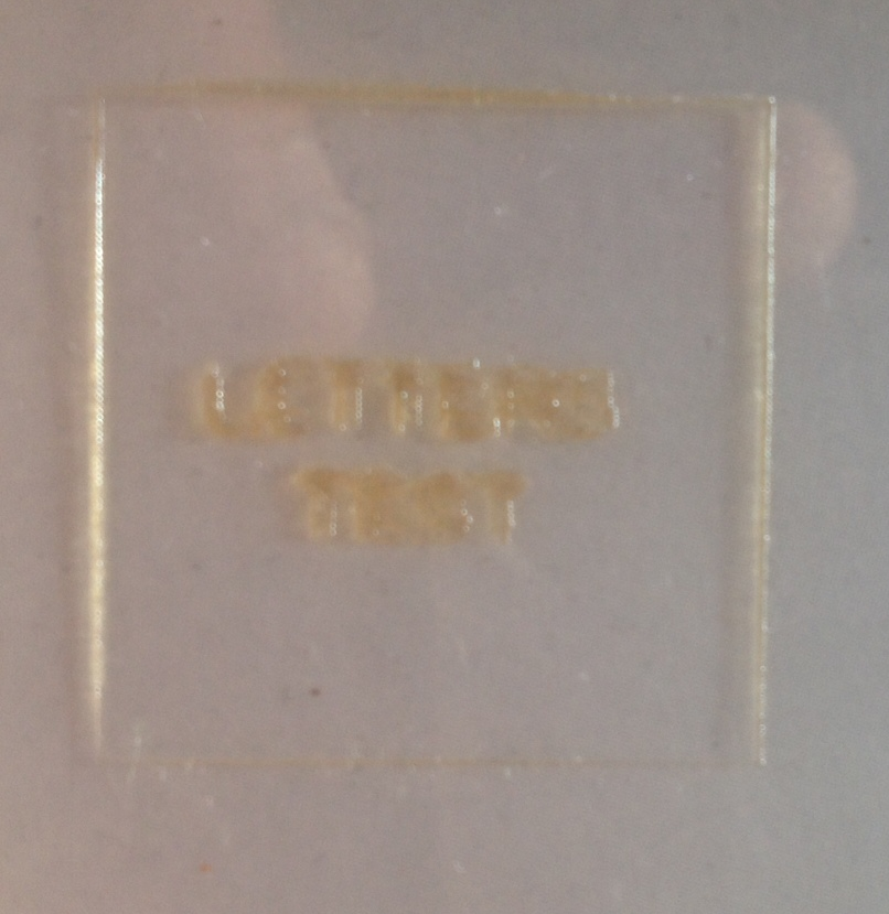

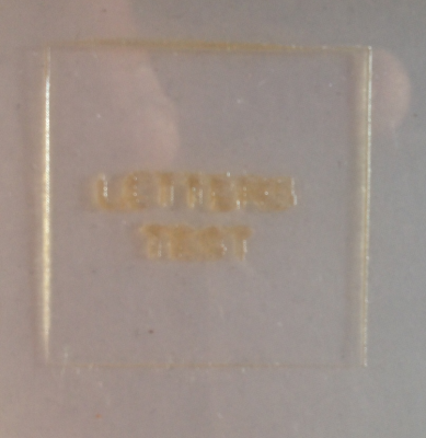

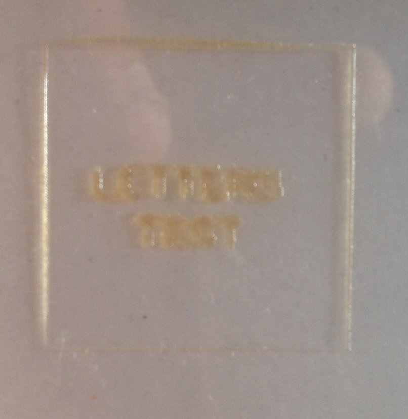

a other test.
Can you guess what it is wrote ? Not easy !
Otherwise, the squre is well done.
I have to work on exposure time, I think to much here, about 3 seconds.
