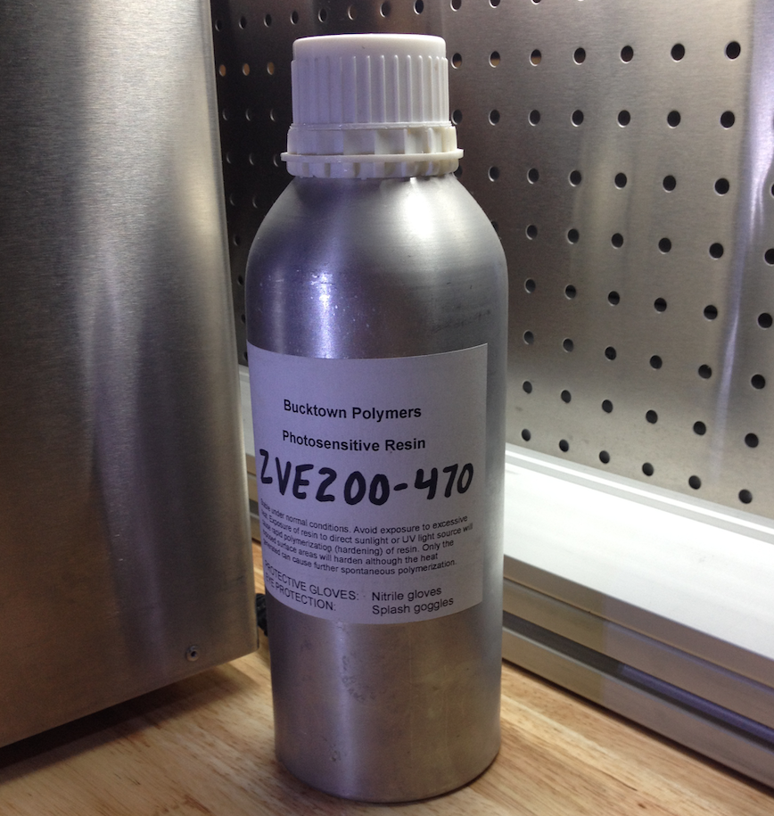

I was just looking at the Bucktown Polymers listings and noticed they offer a resin that cures at 470nm . I wonder if this wouldn't work with the retina ipad display. It might require stronger LED's but in the higher blue spectrum which might transfer through the ipad screen better.

The iPad screens are not good enough for the Bucktown Polymers. US Dollars two hundred for one liter; plus the fifteen dollars shipping charge to los angeles.

Interesting to see that someone actually has some of the 470 resin. When you say the screens aren't good enough is that with the standard backlight or with LEDs through a stripped display?

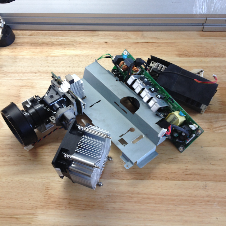

I have gone through nine iPad screens, stripping down in various combination. and few other ones. Light source, UV arc lamps, UV pulsed source, UV 395/400nm 100 Watts COB Chip with Optical Condensers. LED Collimating array 375nm 120Watts. I have couple BARCO MFGD 3420 medical monochrome monitors, I started to strip one and had put it on hold. As I am waiting on friend of mine to come over to my place, so we can strip it down together.
Based on what is accessible and can be easily modified is the DLP projector conversion to UV makes more sense.
