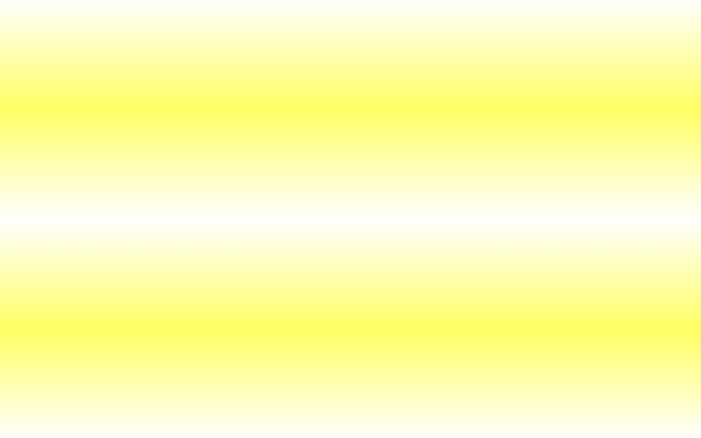

I gave up on UV LEDs and went for direct sunlight and tanning lamps. Little did I knew the polarizers block below 400nm (a spectrometer would've been handy with my 365nm LEDs). The best flat surface i've been able to print was by drawing yellow masks so light spread evenly between subpixels.

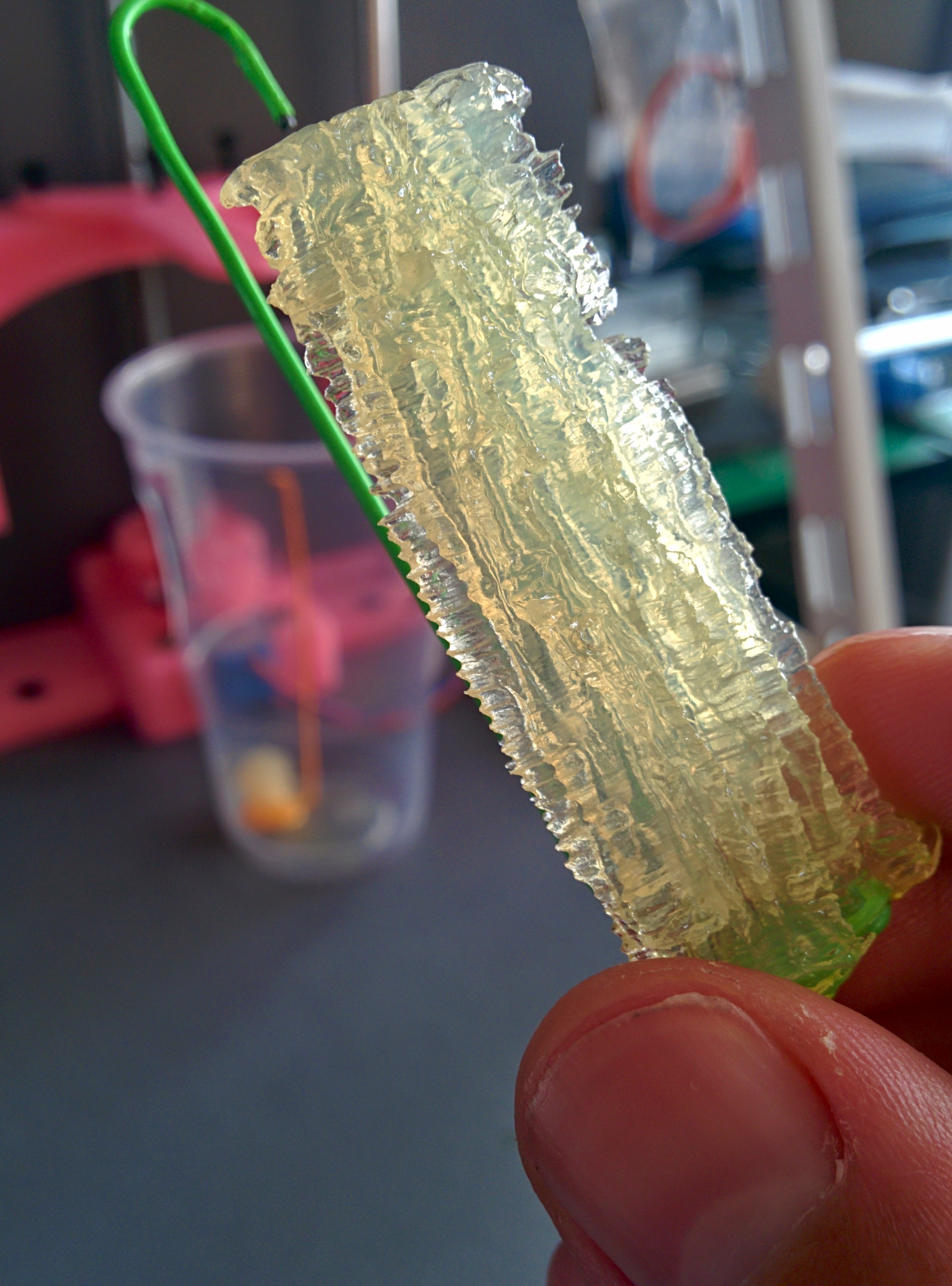

1/ to get clean resolution on the z axis when printing downwards, looks like the resin (old makerjuice) takes too long to "flow" over the object (pic 1),

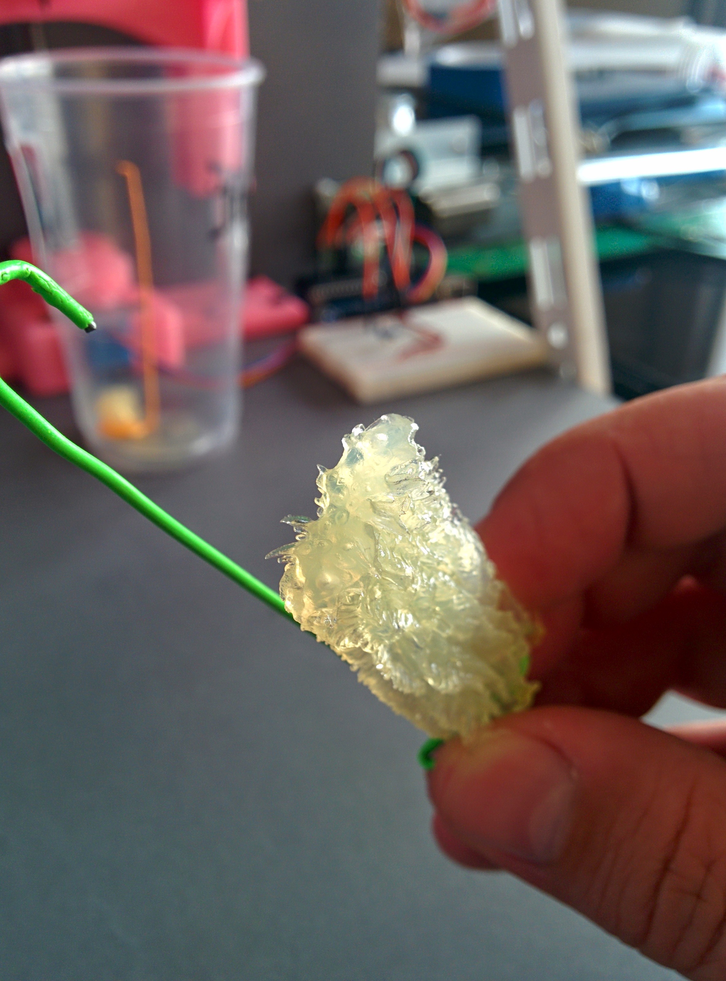

2/ get the resin within 1mm of the LCD to avoid scattering on x and z axis (pic 2) without touching the screen...

How are you collimating and evenly spreading the light from your lamps? I spent months trying to get a lamp, reflector and lens system working right, it just wasn't even enough and the wrong wavelength of light to cure resin correctly. 405nm LED seem to be the best so far, above the 400nm block and still enough near-uv power to cure resin quickly.
I thought about trying to add another fluid between the LCD and resin, but i havent got around to trying.. it might work I know that adding a fluid allow you to extend the in focus range of the LCD as long as the fluid is touching the LCD.
As for resins, I have tried a few. Most work fine, I like the Spot-A LV resin, its almost like water. It comes perfectly clear and very low viscosity. I add a bit of black dye. Ive also used the FTD resing with much success.

- Sample mask
- mask.png (2.95 KiB) Viewed 30980 times

Yeah, youre gonna want to do away with that light setup, you'll never be able to collimate it. And Im not sure why youre using a yellow mask, its not going to help you cure resin faster.
