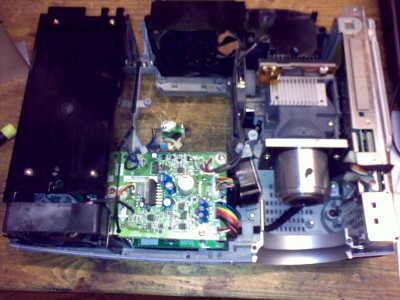

Dear John,
I disassemble a projection lens totally, tried various combinations, none of them minimize throw.
Please see the attached image, it is a schematic section view of my projection lens.
Hope you have some advice,
Kind regards,
Vlad

First of thank you for your reply, any advice is better then none. I found out that placing a flashlight in front of lenses and tried various combinations may teach about the way projection lens are working. Even simple flashlight from smartphone will do the trick. It's my first time addressing Steve, so I would like to thank him personally for the great job on his great contribution to our community, that partially at least owes its existence to him.
As to Steve's advice, moving the projection lens a few mm further outward from the frame created a blurring corners at offset projection lens. Lenses that had used in nontelecentric architectures projectors, like mp2800 projector.
Best regards guys,
You Are Great Aspiration!
Vlad
