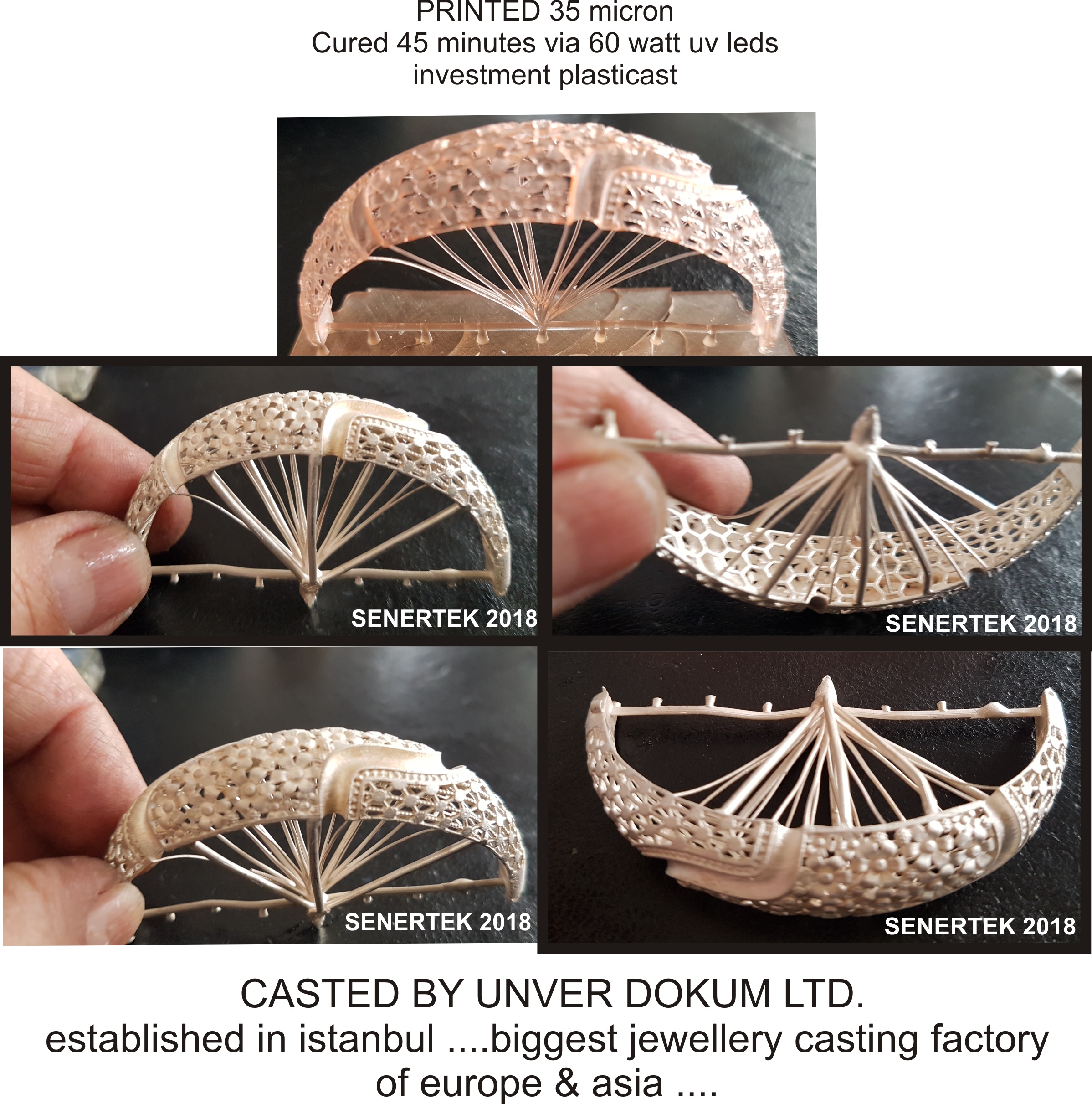

How many ours do you cure the rings under the UV light. What wattage of UV do you use ?
Can you also post a picture of the all the way cured model to see the color

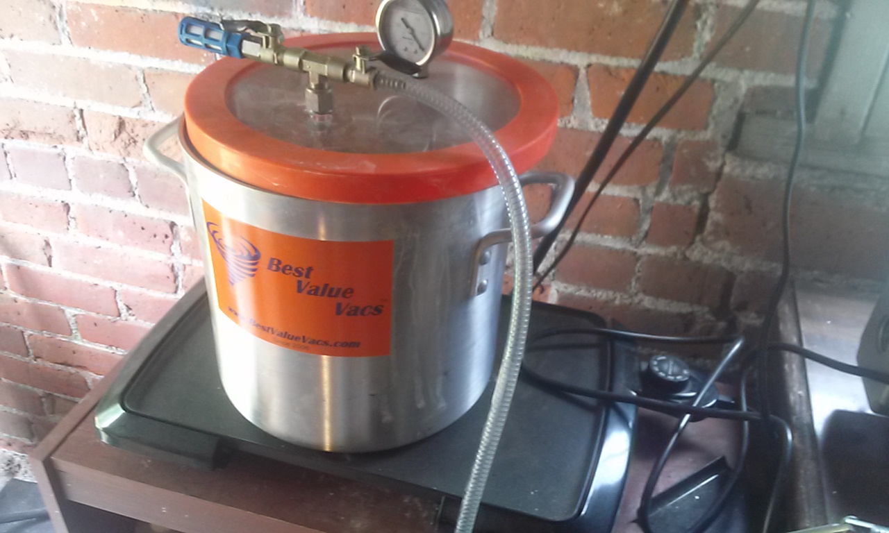

I cure my resin with heat, an old heating element, at 200 degrees in a vacuum chamber for 2 hours. Cures the resin all the way through not just on the surface like U.V. does.
Re: Resins For Investment Casting
Interesting. I don't see why the vacuum is needed though. Can you explain this aspect?

from the biggest jewellery casting factory of europe & asia...
