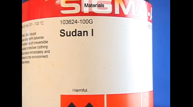

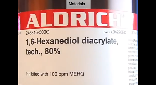

Greetings to all;
An interesting Video Link floating resin; http://education.mrsec.wisc.edu/309.htm
