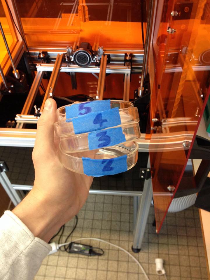

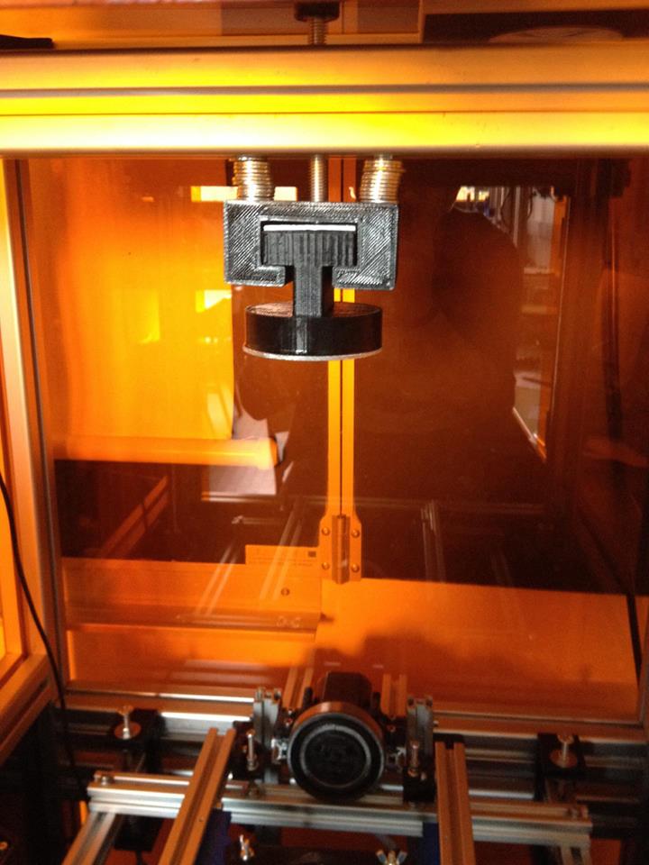

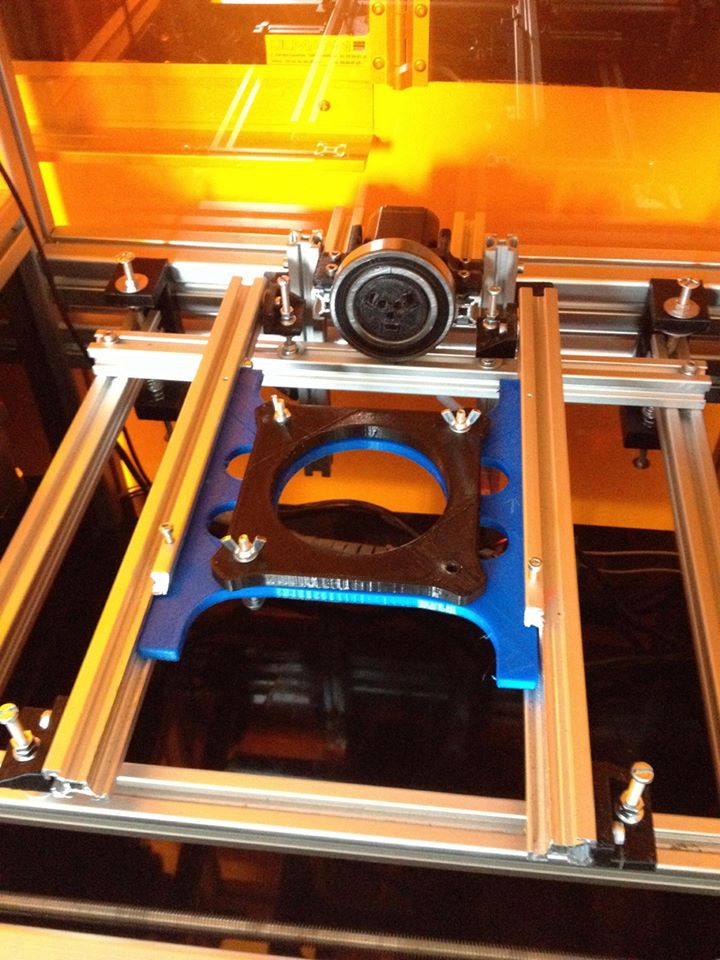

L.E.: I have just uploaded some photos of our 'devices' :
[low-cost RESIN] SLA Printer
