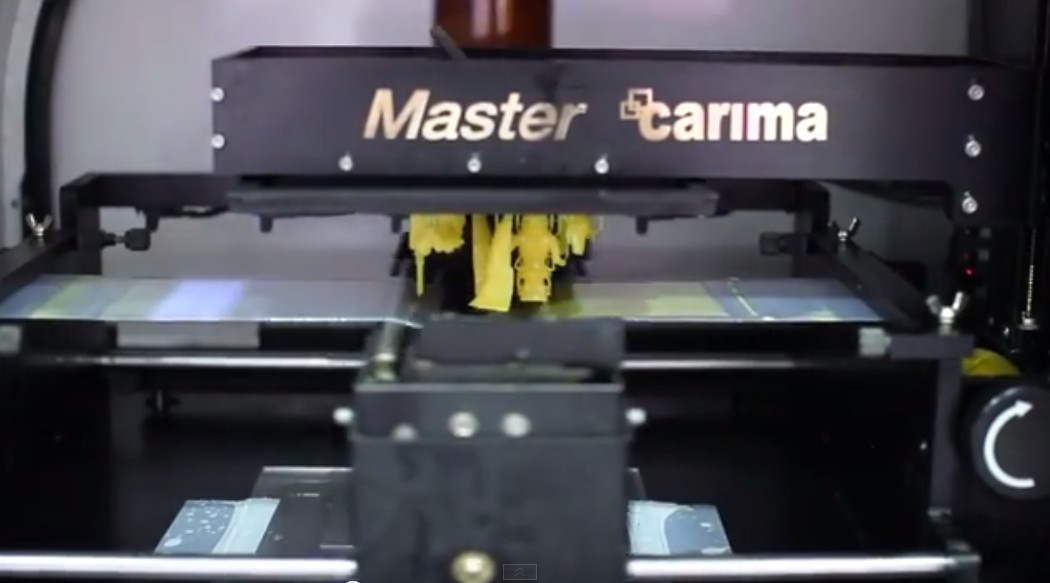

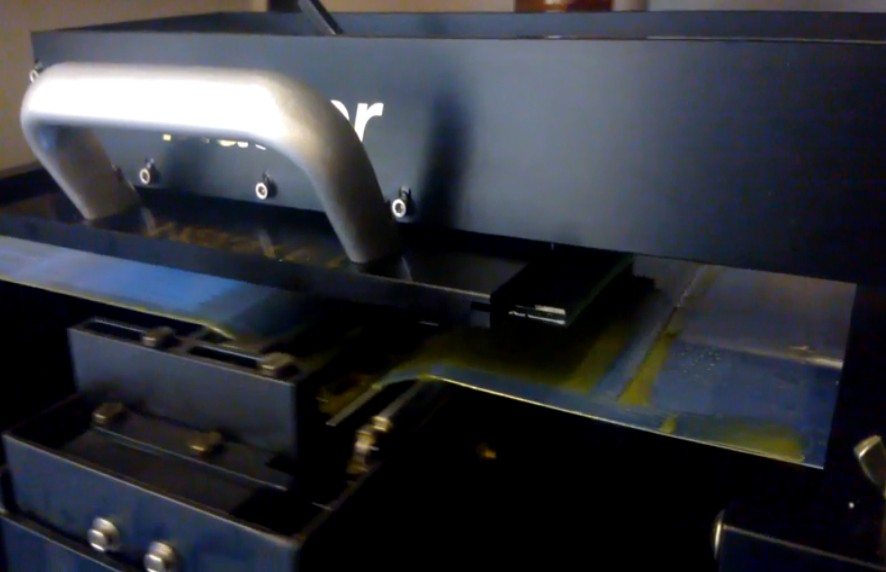

A method that eliminates the vat, it builds the object on top of what looks to like a Teflon membrane that is recoated after each layer.
What are your thoughts on this technology, is it some thing you want to try, advantages/disadvantages?
I'm looking for more information on this separating/coating arm.
Almteq Master Plus 3D Printer - DLP Printing
http://www.almteq.com/nl/gallery/videos/
8:30 min into this video is a clear picture of it.
http://www.youtube.com/watch?v=2MkLD7pY0sA
Carima (I think this is using it)
http://www.youtube.com/watch?v=ow6P-d96f6U
Acetat membrane with a resin film recoater, eliminates vat

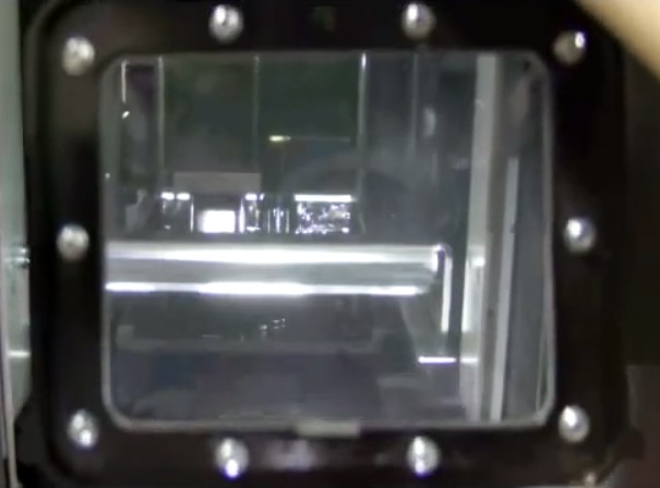

A clear view of the acetate film DLP printer.
You can also see there is a take up roller on the right to present a new surface to print on.
