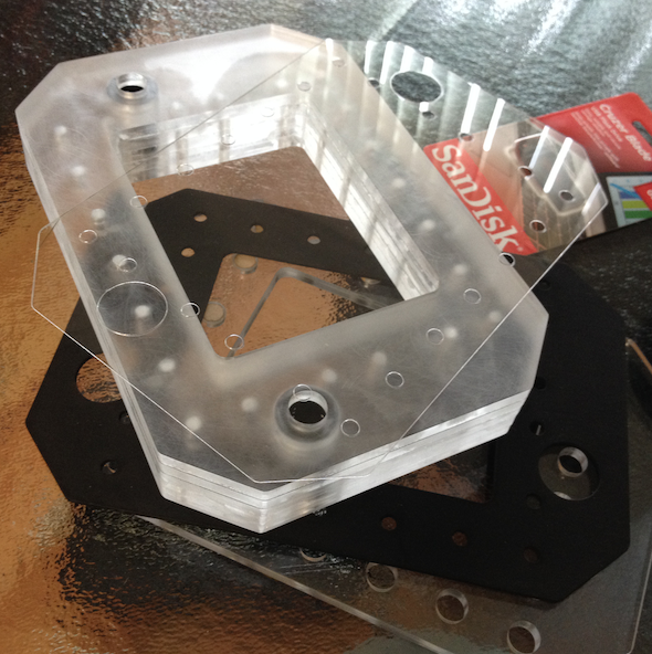

Kindly post the estimated time of availability of your product, I am interested in purchasing about three pieces in about larger than 150 x 220 mm size. I have attached couple of photos; This is my interchangeable universal VAT frame.
Warm Regards
