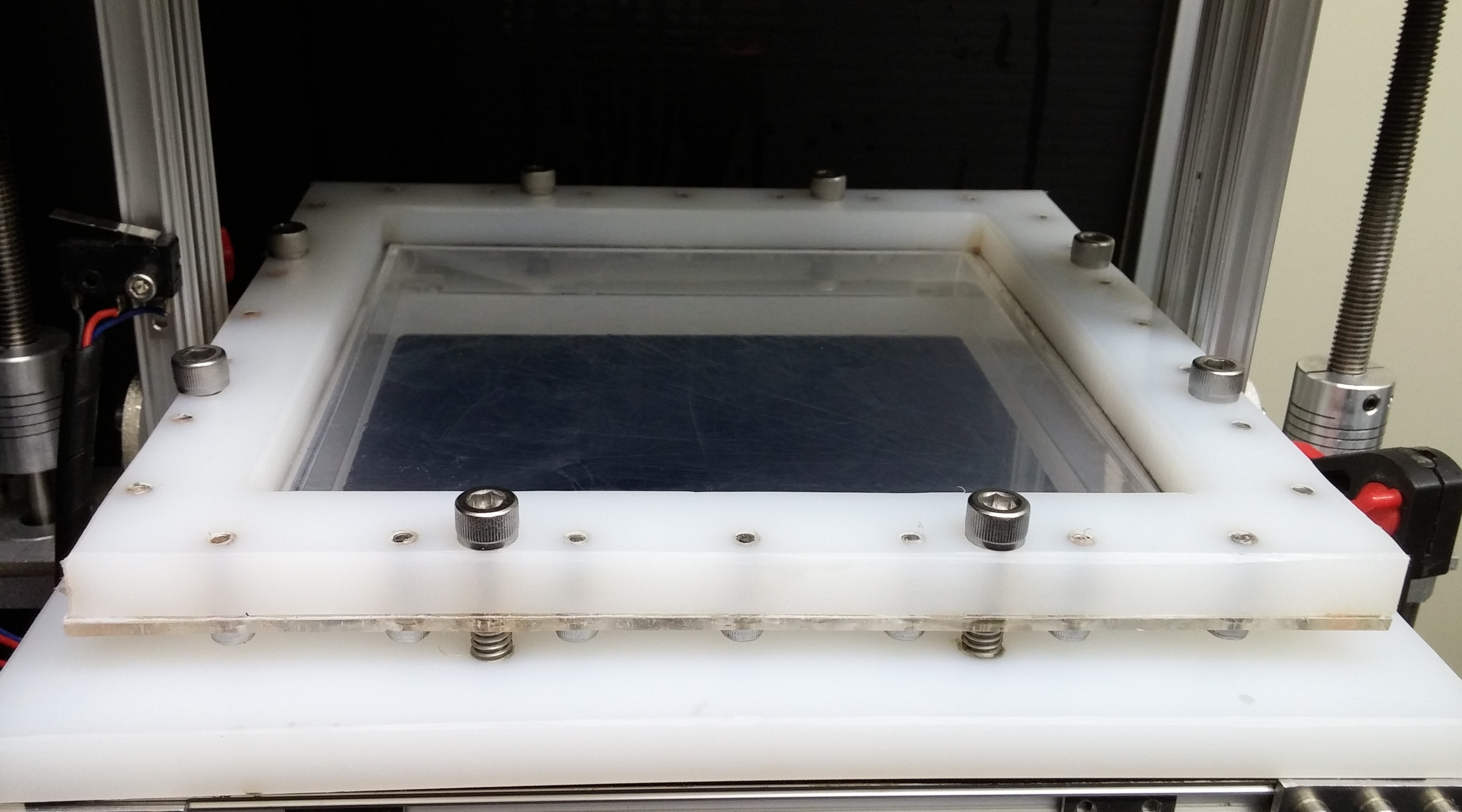

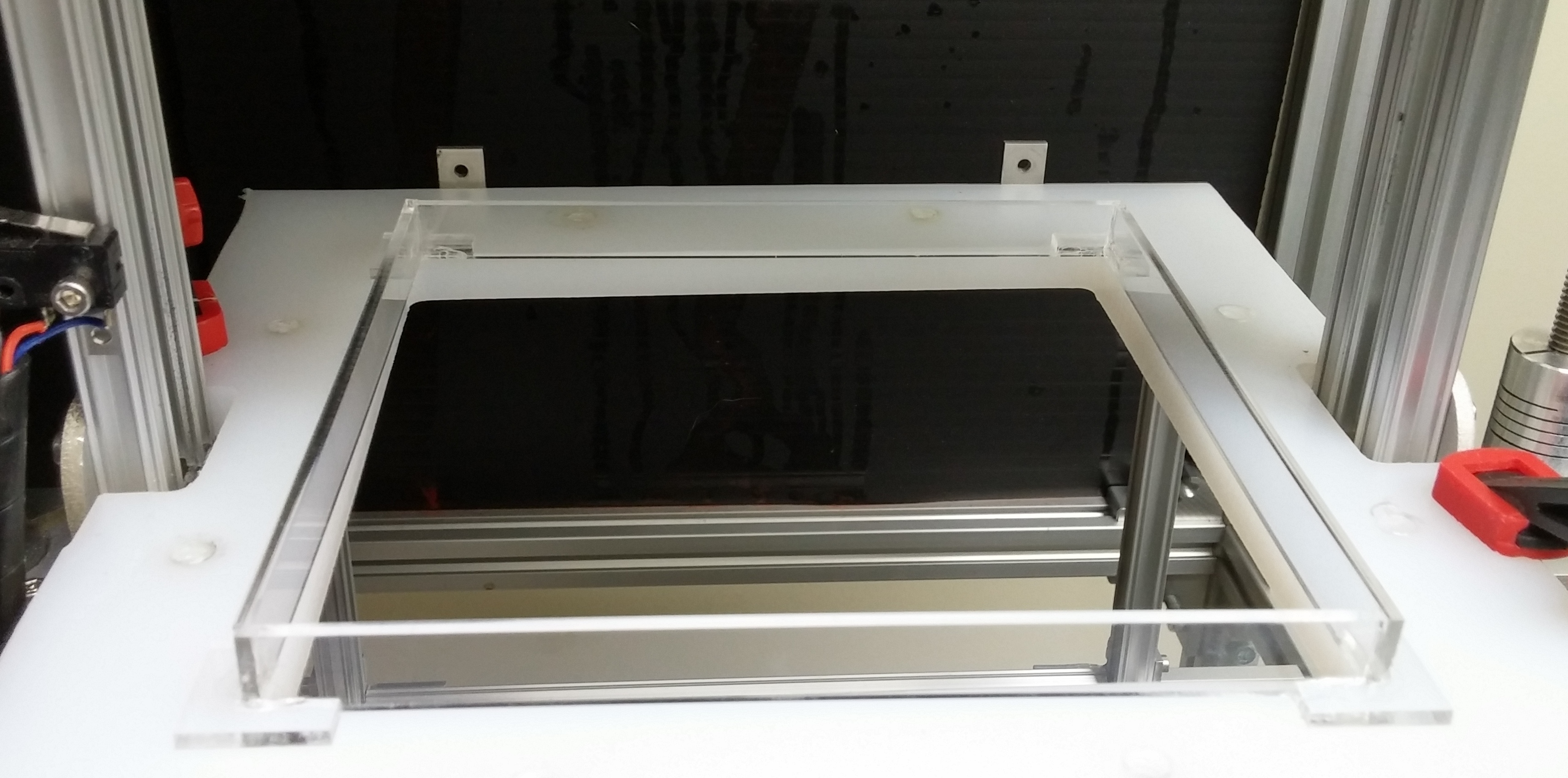

Here is my version on a mUVe DLP. It is a work in progress so don't look to close. The first pic is the lower portion showing the acrylic tension walls. The second is the complete assembly with the 0.005" FEP pulled down taught. I think a tension system is a must. I'm still playing with exposures as they are too high at the moment (16s). I removed a PC sheet I was using for protection but that didn't seem to help much. I have to look at my projector settings next. Once I have the exposure set correctly I have had no issue with sticking to the FEP. This FEP sheet has seen about 25 parts and has a few scratches from poor cleaning procedures.

Re: Flex bottom VAT
im going to give this vat a try looks nice and easy
watch the you tube vid
viewtopic.php?f=9&t=2044
16sec on exposure time seems a bit hight iv only done one failed print (due to crappy vat) but it seemed to be good around 3s
