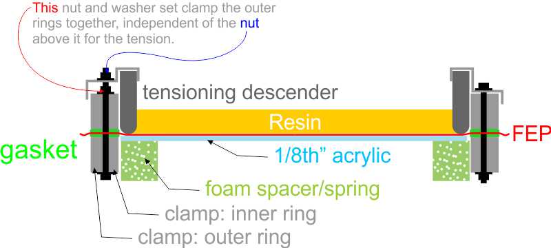

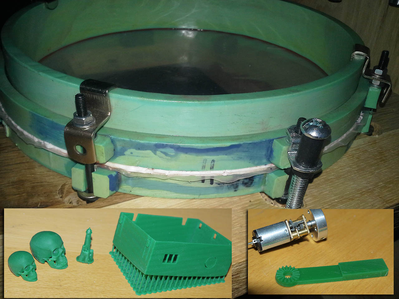

Hello, I've attached a diagram of the flexvat I've built with the material HTL sent me. Before I get into the details, my gratitude and hat-tip to that gentleman...he's been very generous in his contributions to help further the DLP printing revolution.
The graphic and pix should explain most of it. Here are my notes:
Made with the smaller diameter and bell-end (although a coupling fitting would work as well) of 8” blue PVC, approximately 1/4” thick wall. The “outer ring” is cut in sections, heated and conformed to the inner ring before being glued. It serves to bulk-up the clamp section. I used one-part silicone sealant as a gasket material, but there may be better materials for this. My design goals: no laser cutting, simple machining, hardware store parts (the tensioning clamp is a mirror bracket I modified), use both sides of FEP without having to dismantle completely, easy tensioning, no center sag, future modification: rotate vat with each layer, possibly as part of the peel or to promote even wear...
Plans for version 2: rather than outer tabs for the bolts, I'll use much longer sections for better surface-area adhesion to the inner clamp ring and greater surface area for gasket material to hold the FEP. I'll also add more bolts for more even tension pressure (I've got 8 total, with all 8 clamping the FEP and half those serving to hold down the tension ring.) Investigate effective lids for vat for resin storage...will help to reduce labor and resin waste that occurs from frequent cleaning.
I like the round design; it offers a greater reservoir volume. Was getting unreliable prints until I added a circular piece of 0.10" acrylic with gentle foam "springs" pushing it up against the bottom of the FEP/tensioning descender. Also, I drilled small vent holes in the acrylic so when the FEP is drawn up as the build platform raises, the vacuum, if any, is released.

The projector: Acer's H6510BD. For 100 micron layers, exposure set to 7500ms with the exception of the first two layers, and those get 20 second burns. A note about the one-part silicone sealant as a gasket material: It needs to be trimmed so the edge is slightly less than flush because as the tension ring descends, it can work to pull on the gasket if it catches. It's pretty soft stuff, not sure if it's optimal. Got some shoe goo to try. Henry's approach for making a gasket is best, where he made a mold and used a two part rubber/silicone that can have a higher durometer if desired. It's tidier, removable, and one could make it with a lip to help it maintain its form if desired. I was lazy...
I'm also getting mild waves in the Z, and I think it's because there's a slight misalignment between my stepper and the ball screw. I thought the damper and rigid bearing/rails would be enough to counter that, but no so.
