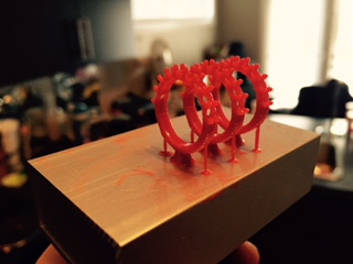

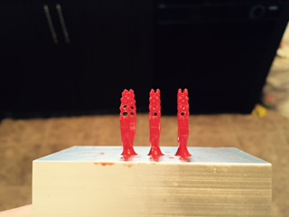

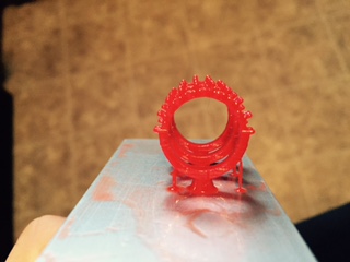

tried using your prints with the 1:1 mixtures and a exposure time of 8 secs i got the following, got alot of bleeding and the prints where really sticky

Interesting results, you might try putting a print in water / ipa then setting out in the sun. The liquid may help fully cure the print and remove the stickyness whereas air may be preventing the surface from curing.

I increased my exposure time from 9 to 20 and it comes out ALOT better
only problem is it has a 50% chance of not having enough force to unstick from the vat, its a work in progress lol
