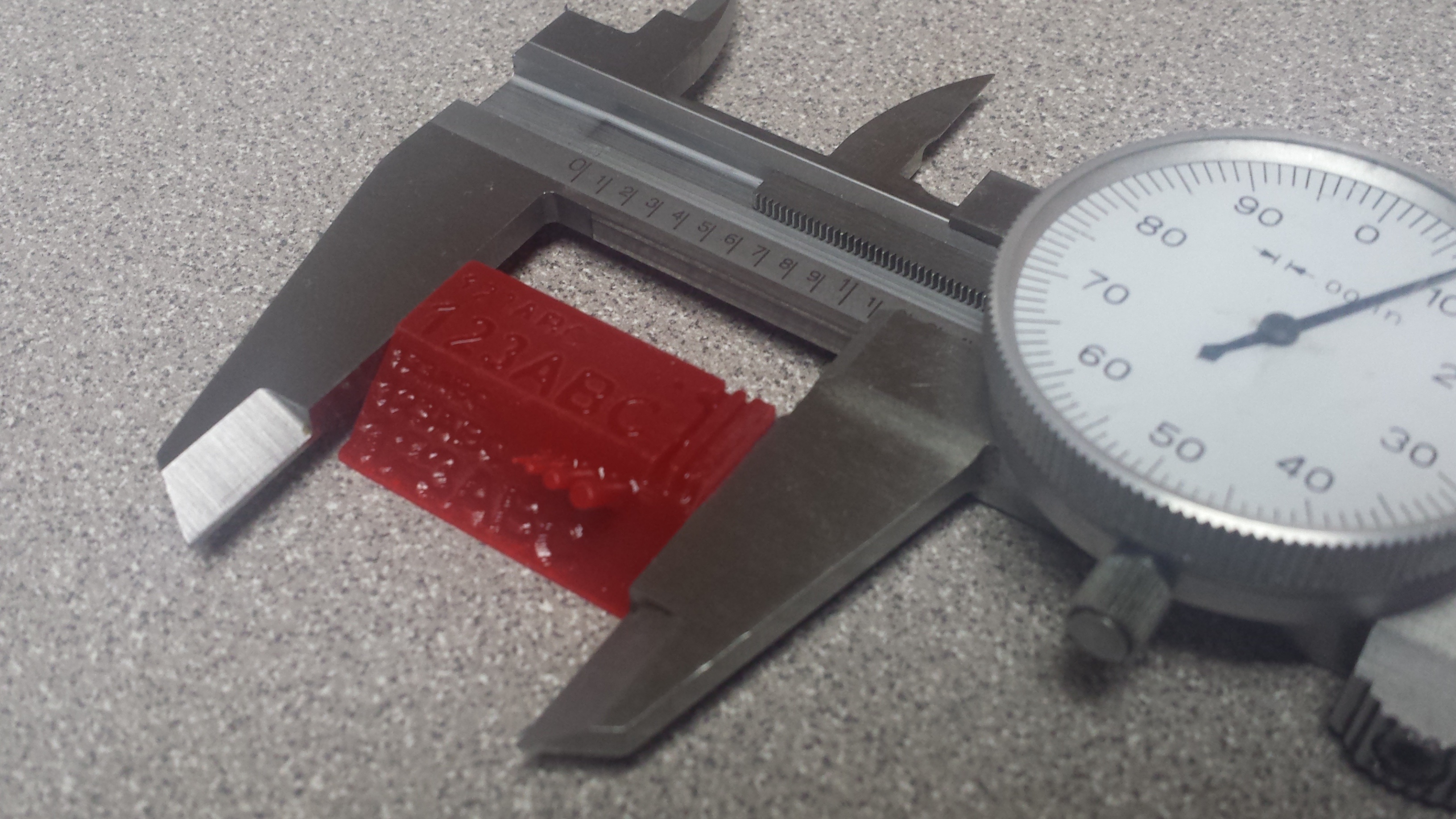

I have recieved my LittleRP Kickstarter printer and have it fully assembled and JUST printed out my first print. YAY!!
Anyway - I printed the calibration target block with the numbers and letters inset into it with the ramp. I measure the length of it and it comes in at 1.108" - if I am right the block is suppose to be 25mm long (1.020") - how do I correct for this? Change the "Build size" in Creation Workshop? I'm searching this forum for a bit more understanding. Thanks!

Re: Calibration?
Yes to both
changing the Build area size changes the size of the objects to get the size right
current size / expected size * build area = new build area
My build area in cw started at 102 and my first print measured 29.4mm of the 50 it was supposed to be so 29.4/50 = .588.... Multiply that ratio with the build area .588*102 = 59.976 I then just used the aspect ratio for the other length

I was just finishing up another test print when I saw your post. I did the math - but like a bonehead I did it backwards. lol Oh well. I used the new print as a basis - did the math on it, double checked it with the first print and my initial settings and it comes out really close. Tomorrow morning I'll run another print and check my new settings. Thanks for the help! I'm new to it (obviously), but I have been reading and think I get the general idea of everything, I just need some experience and perhaps a little guidance.
