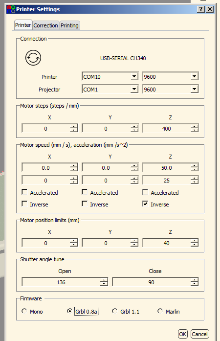

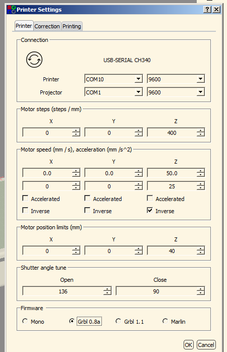

i have printed successfully with monoware with the following settings;
NOTE: if you set these values incorrectly it will overwrite GRBL and you may have to reset the values again.
I have checked the INVERSE box because my Z is inverted please confirm whether your Z is inverted or not before printing.
motor steps; if you are using tmc2100 then 400 should be the correct value, if not the value should be 200
motor speed; you may set to your desired value
for acceleration; default value for GRBL 0.8A is 25.
motor position; you must set this value otherwise the limit would be set to zero and build plate will crash downwards after print instead of lift.

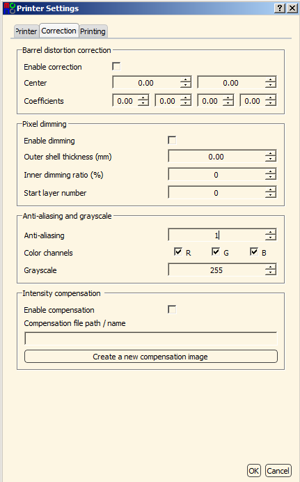

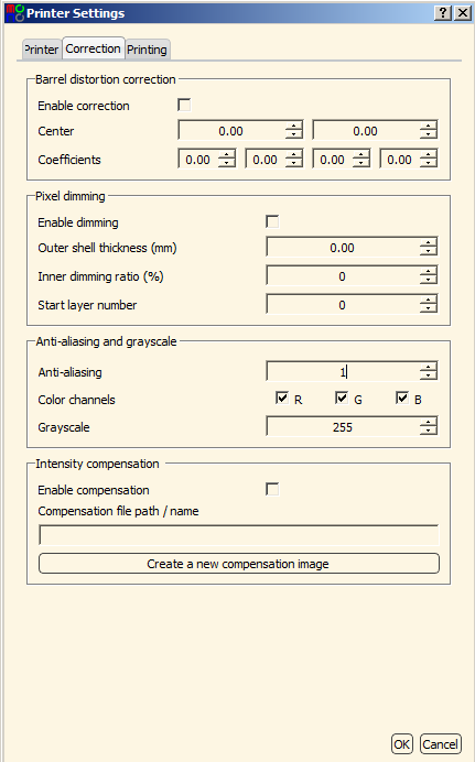

Anti-Aliasing; was recommended to set this value at 1 by the developer of monoware Yun, you can play around with this value and experiment.
Color Channels; must tick the R G B boxes otherwise nothing will be projected
GrayScale; 255

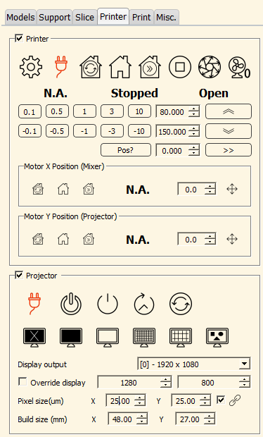

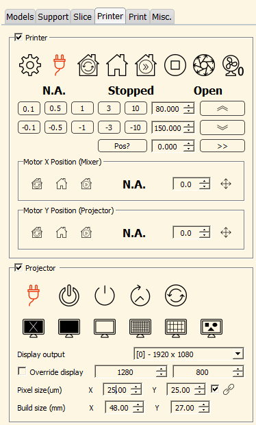

Pixel size; set your XY resolution ,
Thickness um; set your Z resolution

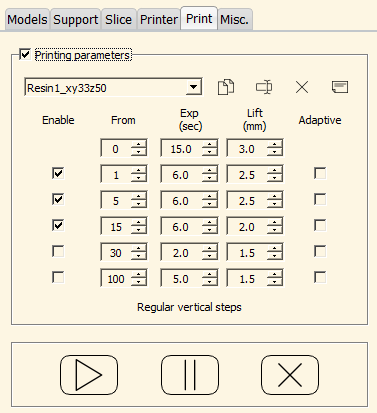

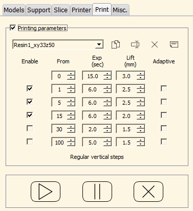

set your exposure timing settings

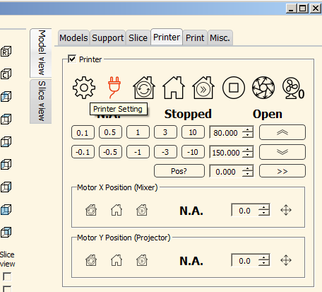

to set the build plate i manually lower the build plate by hand to zero (touching the fep) and set this position as my home value (at the printer tab)
