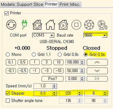

Hey Corey,
I've implemented Grbl 0.8a firmware g-codes too, but I'm not sure if this works okay with LittleRP2 since I can't test myself. Please let me know if the codes work fine or generate some issues.
To work with LittleRP2 properly, you should change the screw rod information and COM port baud rate as shown below.
Thanks.
Yun
