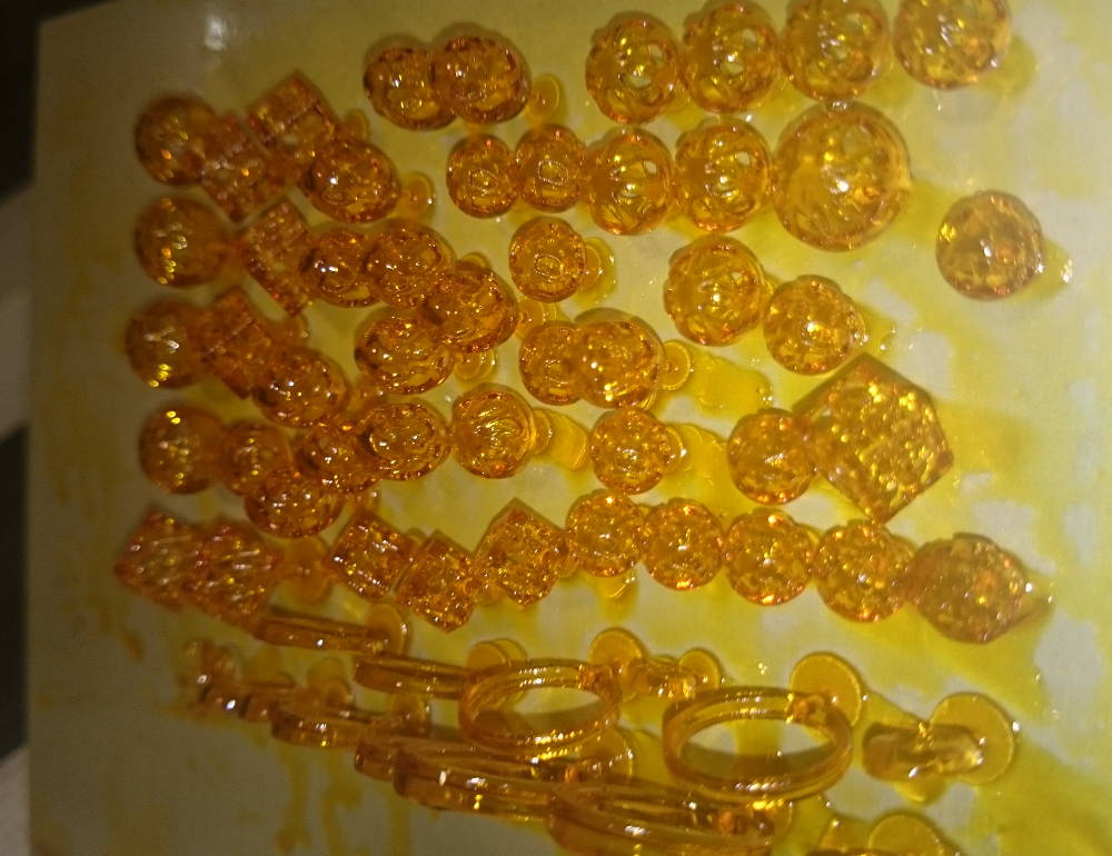

Re: raspberry pi Silent boot
Pi Running Headless & Webserver controlled
so after switching from python subprocess to sockets and modified the c code a little i am now able to run some slices images for a periode of time controlled via a httpserver running on the RPi,
so basically what you seen on the film clip is.. a c code controlling the frambuffer and accepting socket connections. and my httpserver(python) accepting commands and executing them to the c code program.
have a look:
have a look:
