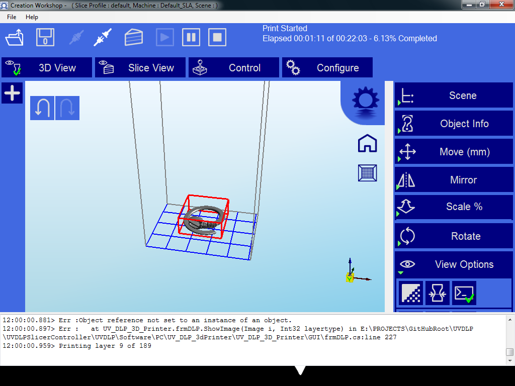

erro no cw

What machine are you using, what's the size of the projector? It sounds like a mechanical projector offset issue.
