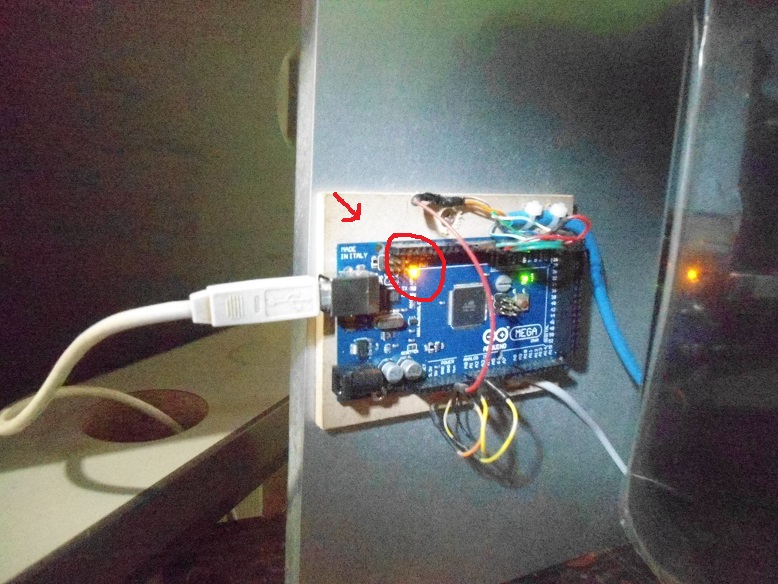

changed the pinspRAMPS-13 files - I uploaded to the Arduino, but this is with the LED always on.
See photo below, this LED does not turn off ever, and Will not managed to move the engines.
I put as I had here:
X pin 3 step
X pin 2 direction
Z pin 6 step
Z direction pin 2
Just do not put enable because I was not using.
Please see photo below.

Did you change the pins_RAMPS_13.h file? If so, please upload it to [url=pastebin.com]PasteBin[/url] so I can check it. Sometimes changing the pin definitions can things weird. I'd recommend that you change your wiring to match the original pins_RAMPS_13.h file, not the other way around.
The LED that's always on is just a status LED. It shouldn't be affecting anything (unless you changed its pin).
Also, do you have your X and Z direction on the same pin? Or was that a typo?
