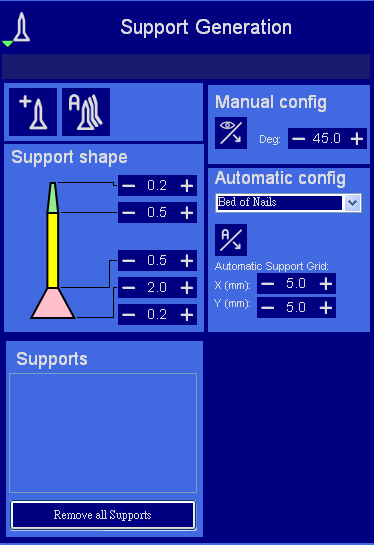

I am new to Creation Workshop and this forum. I really like the support generation feature.
In RC5.1, I only find one support type, I don't know what's the right word for it, I just call it the "straight pillar" type (see attached straight_pillar.png). However, I saw another type of support in Envision Labs website. Again, I don't know the right name, I just call it the "slant pillar" type (see attached slant_pillar.png).
Is this kind of slant pillar support a future feature? Or RC5.1 has this support type? If so, how could I used this type of support?

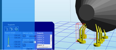

The second picture you have is CreationWorkShop with the supports it produces. You just have to place them to the side, double click the support hold shift and place where you want. Hold down Crtl and left click where you want the support to contact the model and it will angle the support. Alternatively you could use B9 Creator software to place supports (there are a few options) save off and open/slice in CWS.
