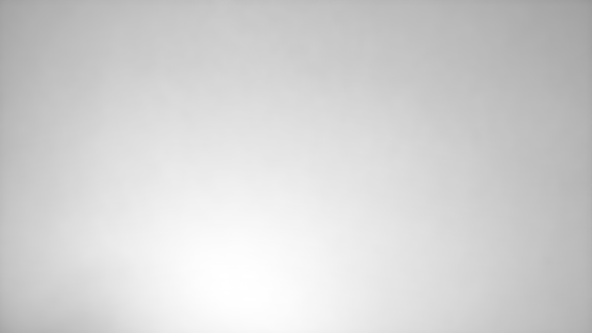

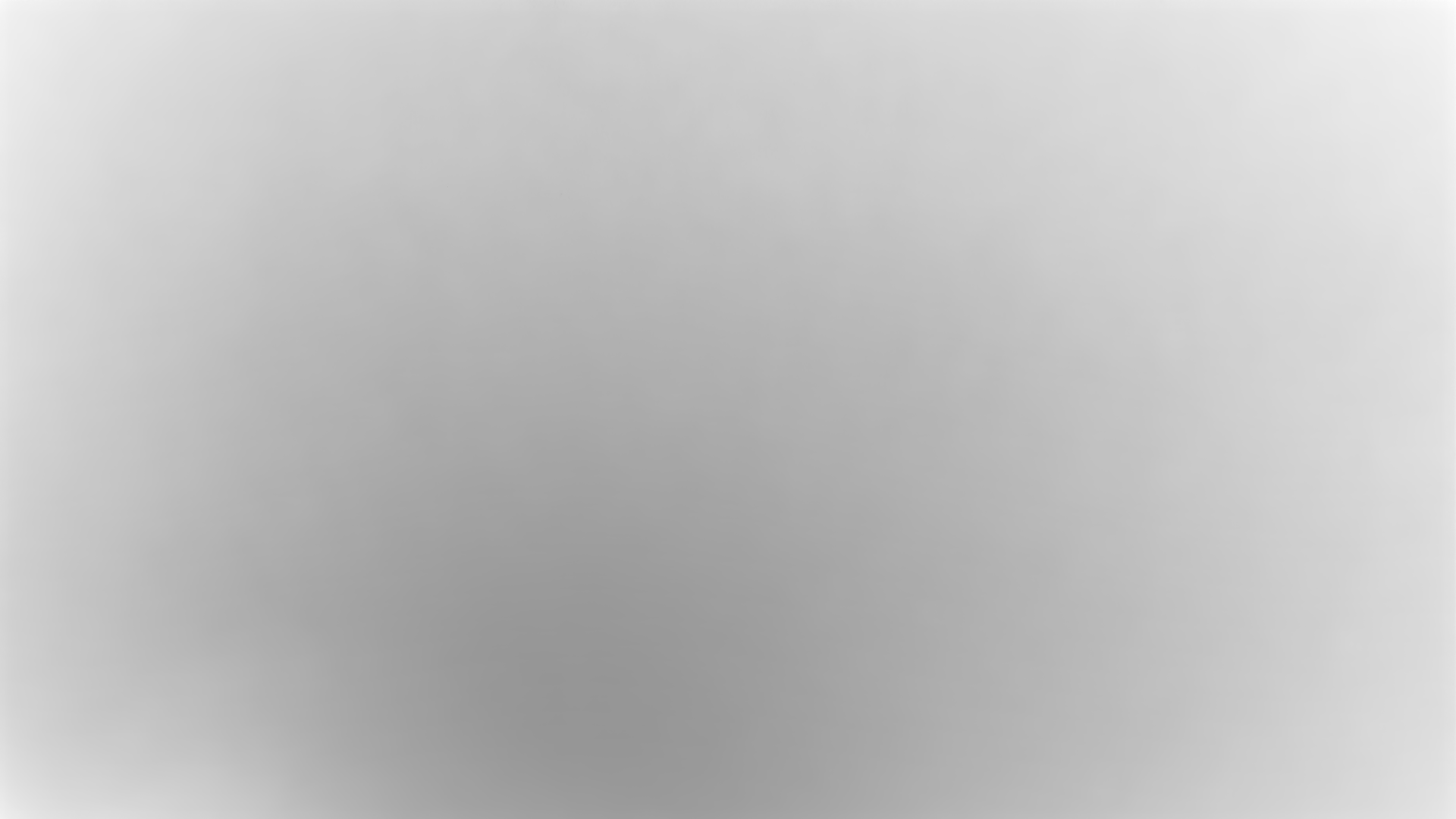

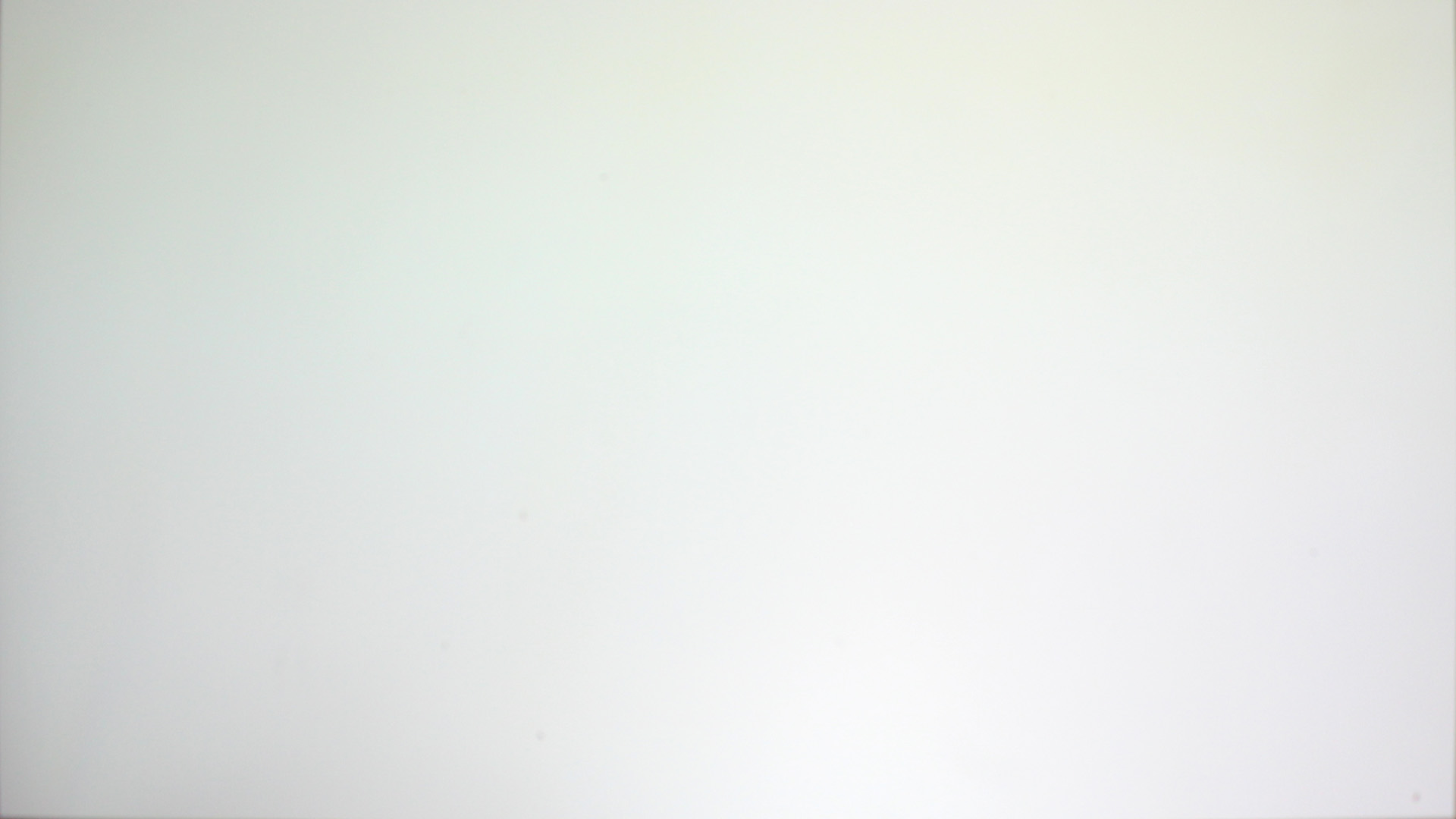

Hello
I made a mask but, could you help me about which file format i have to save?
Is PNG ok?
Projector Light
Mask
Masked Light (Multiplied at Photoshop)

Postby PacManFan » Thu May 28, 2015 3:45 pm
That looks about right, it should be in png format as a multiply mask.

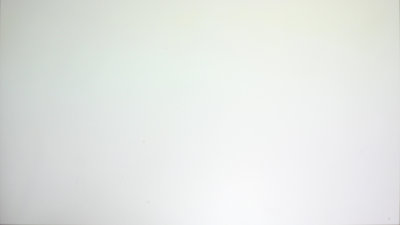

hi cihanalak,
im lost getting a correct mask. can you describe the exact steps to get your second image?
i load a photo taken from the projected image ( your first posted image ), but i dont now how to proceed to next step.
everybody say mutliply in photoshop, but when i try to create a new multiply layer, nothing happen ... :(
this is a photo taken from my projector.
if i duplicate layer and apply multiply , i only get a image a bit darker than original. clearly im doing something wrong ... :(
