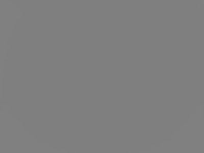

I made a picture to illustrate what a mask does:
So the mask evens out brightness imperfections in the projector output.

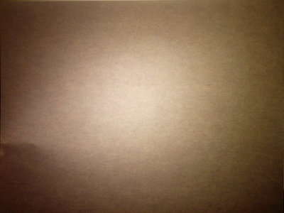

i just did a test. a white paper in front a lamp. it could simulate the uneveness if the light. take a photo.
- sumulated light output

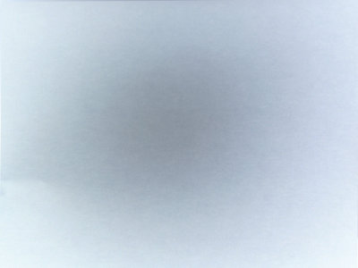

i load this image to photoshop, invert it in a second layer and apply a 50% transparency.
- inverted
The result image is perfect even grey image.

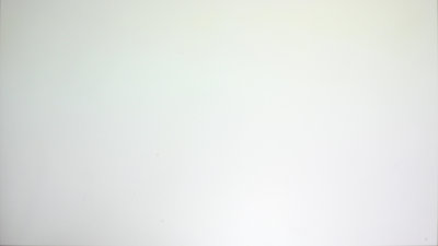

- photo taken from wall projection
this is photo taken with my dslr from a white image projected in a white wall. can see clearly the hot spot, and how brightness decreases to the borders, especially the left side.

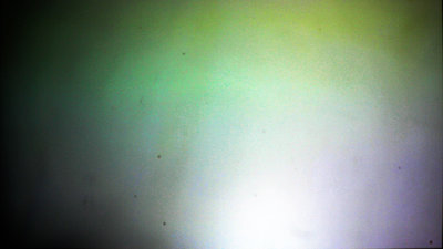

- automatic levels from photoshop ...
this photo is photoshoped with automatics levels, and the degradation is more visible.

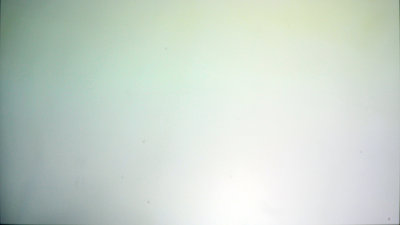

- equalize filter
with this filter, is much more visible, not realistic, the brightness diference.
now, i guess, i must invert and convert some of these images to apply the mask.
