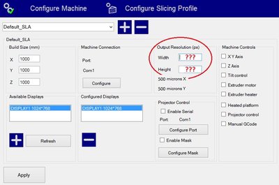

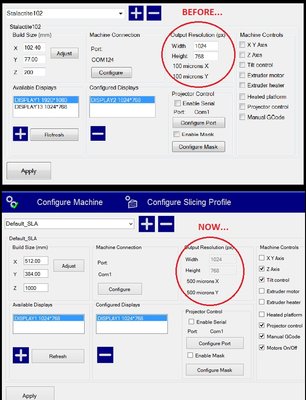

Why the 1.0.0.41 version is the last one with custom and editable Width and Height..??? It was a very very very important option for all of us using prototype machine...!!! Please restore it. Good job... ;)

screenshot
Re: Custom resolution option
Posted: Fri Apr 10, 2015 10:06 am
by miki71ita@libero.it
I have a prototype 1m X 1m X 1m machine and I can use a 500 microns extruder to build big 3D models...! But I can't setup the Width and Height in CreativeWorkshop to have 500 microns in the output PNG slices. It's not important for me if any PNG slice is very very big... it's ok for me, I need this...! Can you solve it...? If we can setup every custum Width and Height we want (and it's not important the real Display's resolution!), then everything is very easy...! ;) ...

Posted: Fri Apr 10, 2015 11:53 am
by PacManFan
I'll see about adding this feature back in. One thing you can do with the current version of the software is open up the machine configuration file in a text editor. You should be able to manually edit the output resolution values as well as the monitor X/Y size.
