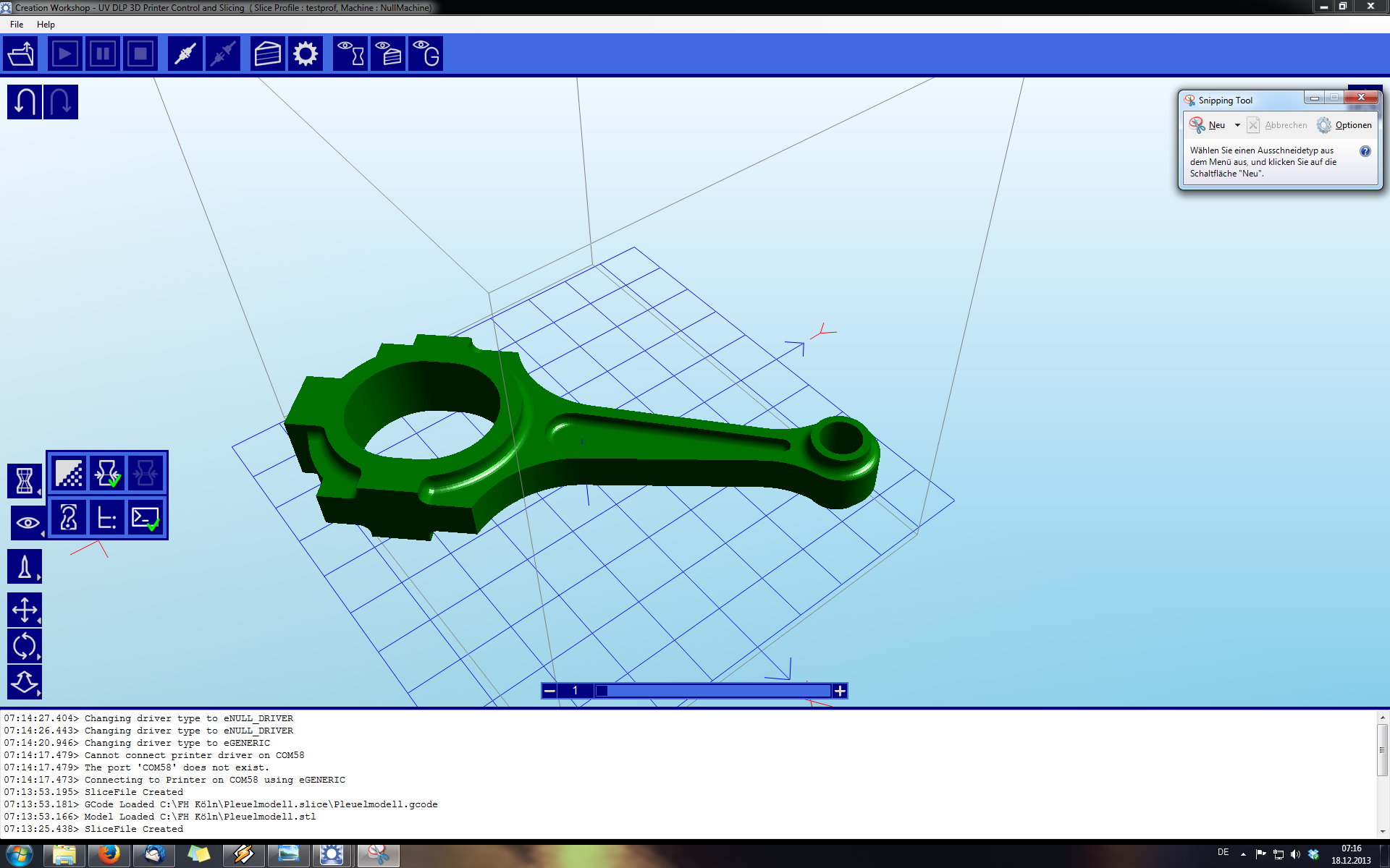

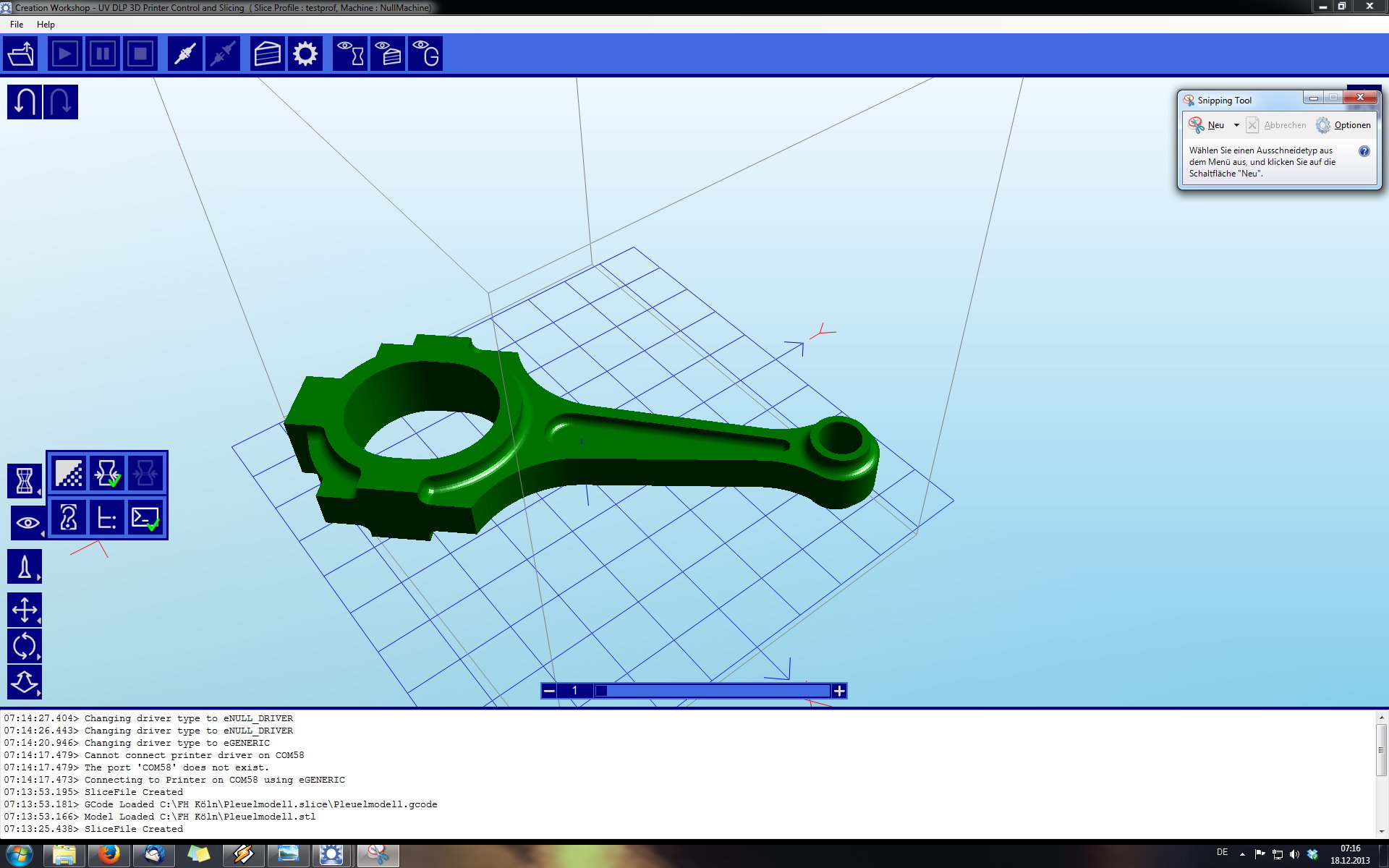

RC1. I will try RC2. Maybe tomorrow. I'm beat. On RC1 I got the same thing that Leinad78 shows in his screen shot.

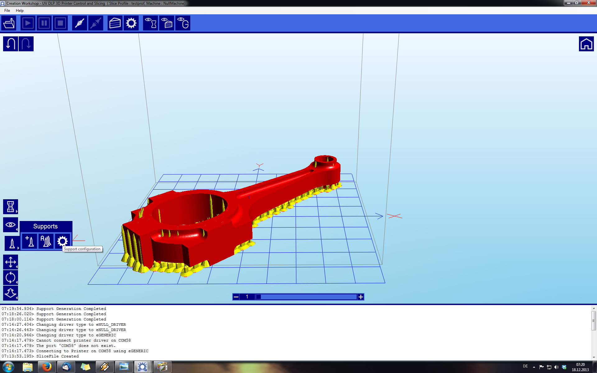

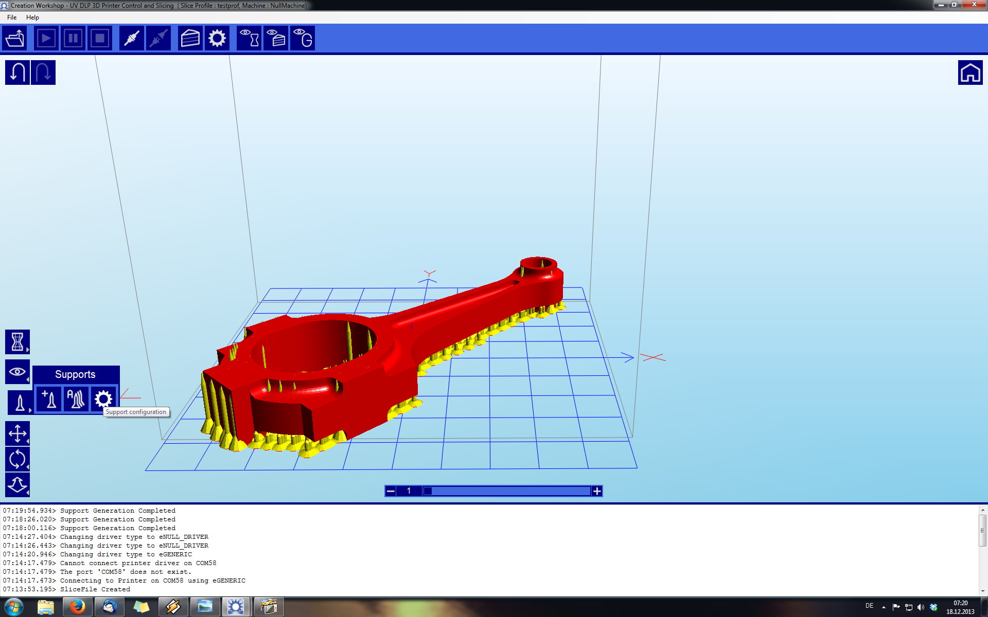

i´ve been playing with RC2 right now and i ran into some small issues:
there is no explanation popping up on the lower right icon with the green "check" sign.
i haven´t found a way to remove support structure after it has been created in the case i don´t want it.

I may be wrong here, but to delete an item, select it in the tree, right click, remove.
it would be nice to delete multiple supports, instead of one at a time.

I should really update the user guide.
In order to delete a model, you can double click on it and highlight it, and then press the delete key.
You can alternatively select it from the tree view, right click and select delete.
In order to remove all supports, go to the tree view, right click on the '3d Supports' node, and click the 'remove all supports' menu item.
