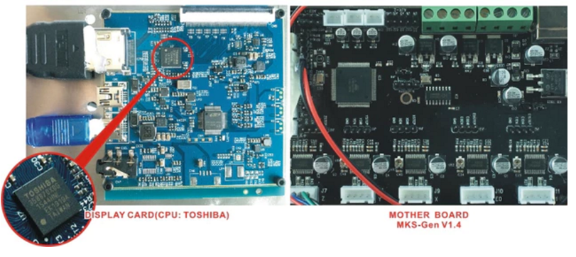

Postby hp_ » Wed Nov 30, 2016 2:43 pm

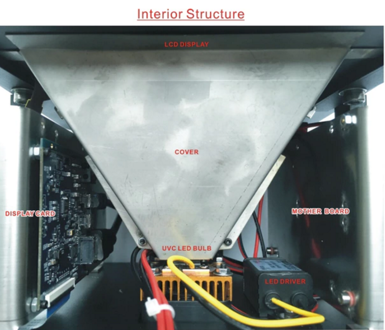

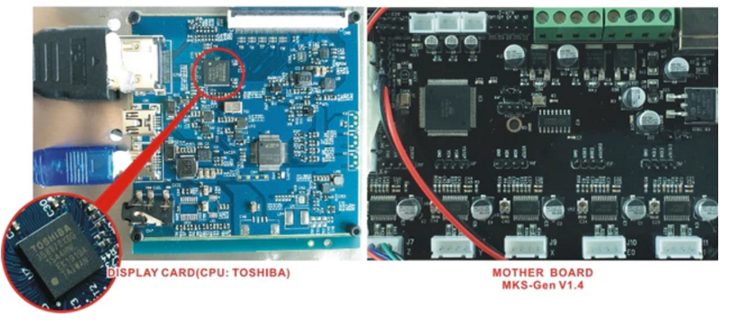

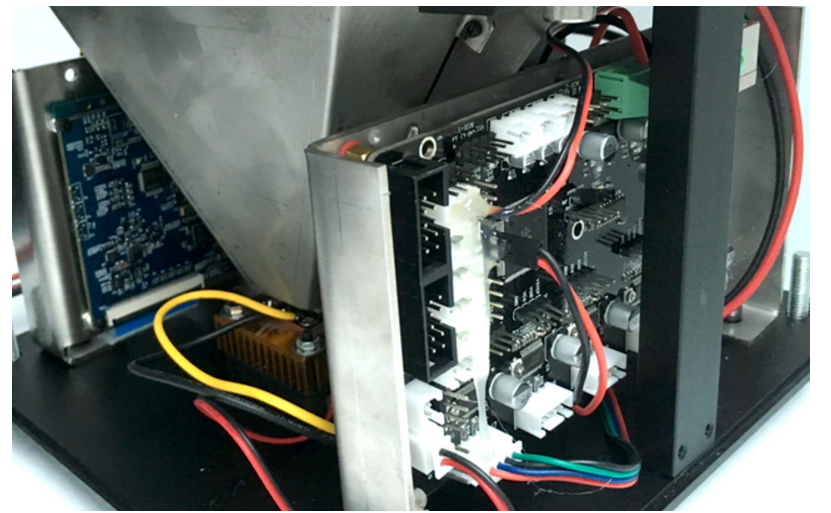

Some internal photo's(from another site(Kickstarter)

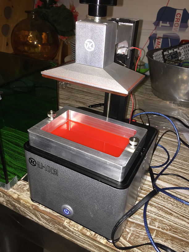

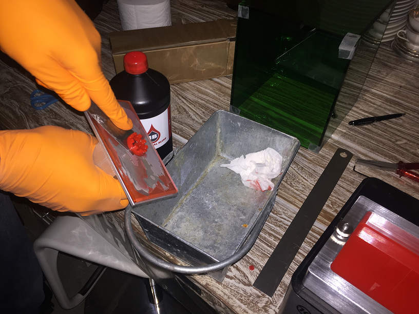

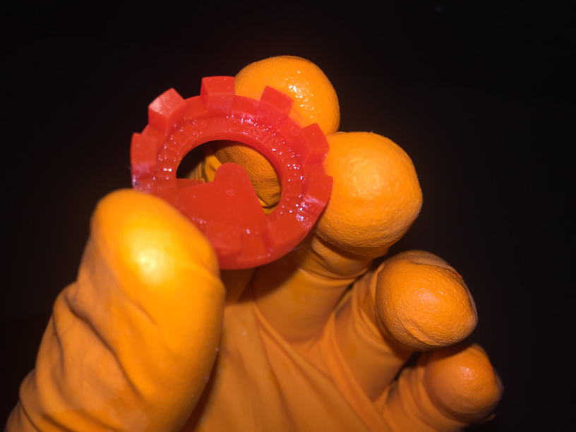

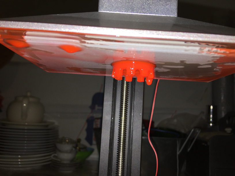

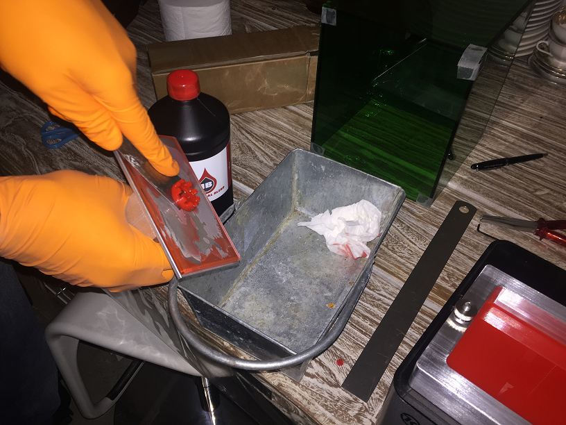

Postby hp_ » Thu Dec 01, 2016 1:26 am
My very very first print with the LCD printer was a great success.
resin: fun-to-do industrial resin.
first 2 layers - 84 sec
rest of layers - 14 sec
slice: 0.05mm
print time 54 minutes
I have just started another print, but in the mean time here are the results sofar

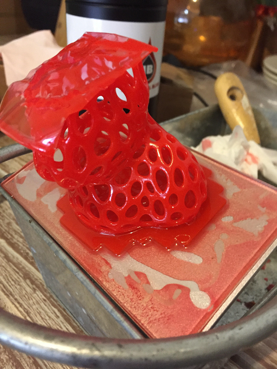

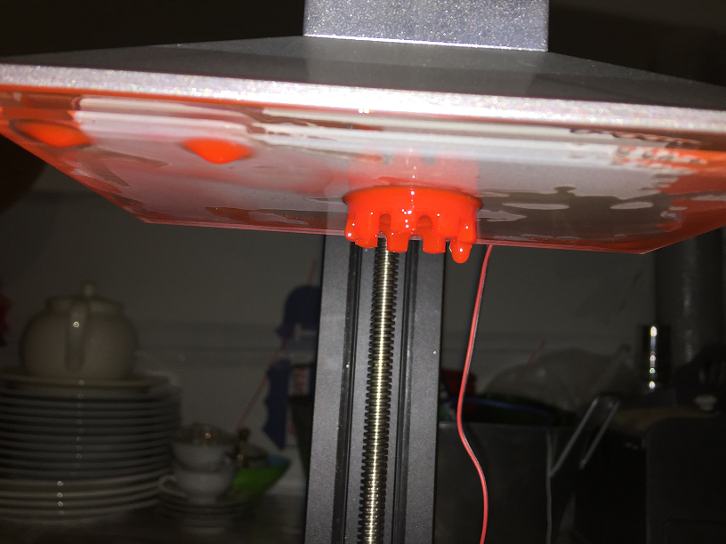

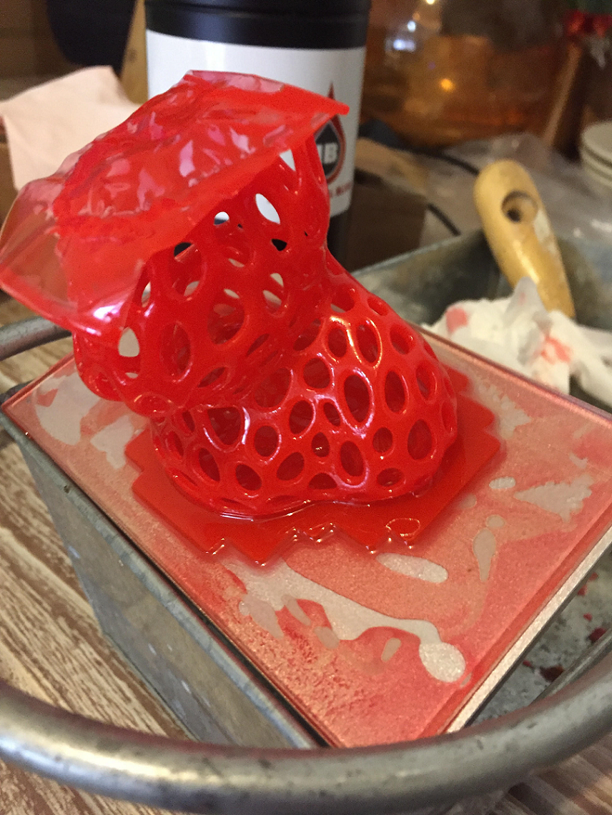

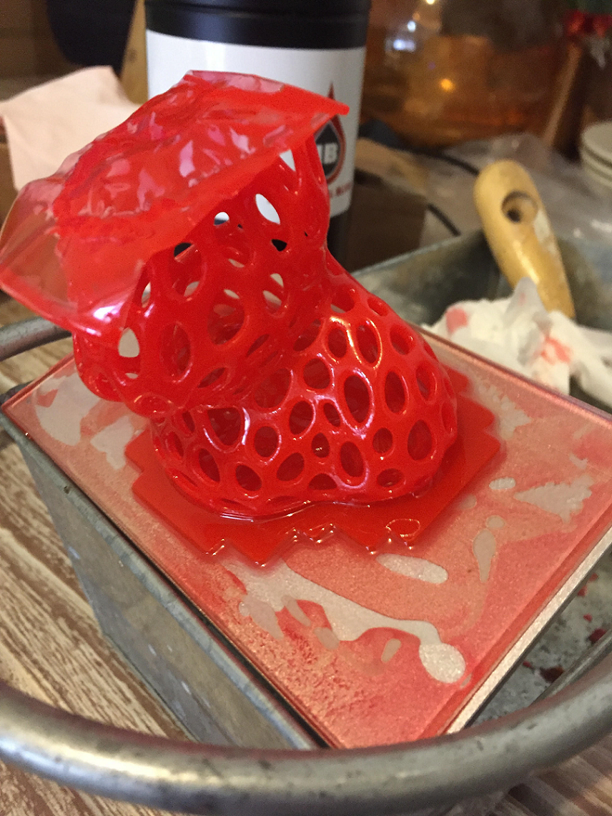

Postby hp_ » Thu Dec 01, 2016 12:38 pm
My biggest part yet,
the print would take 8+ hours
resin: fun-to-do
base layer nr: 3
base layer duration: 80+ seconds
normal layer duration: 10 seconds.
printer stopped printen when my laptop decided it wanted to install windows updates!!! arg!!
MOAI veroni piece

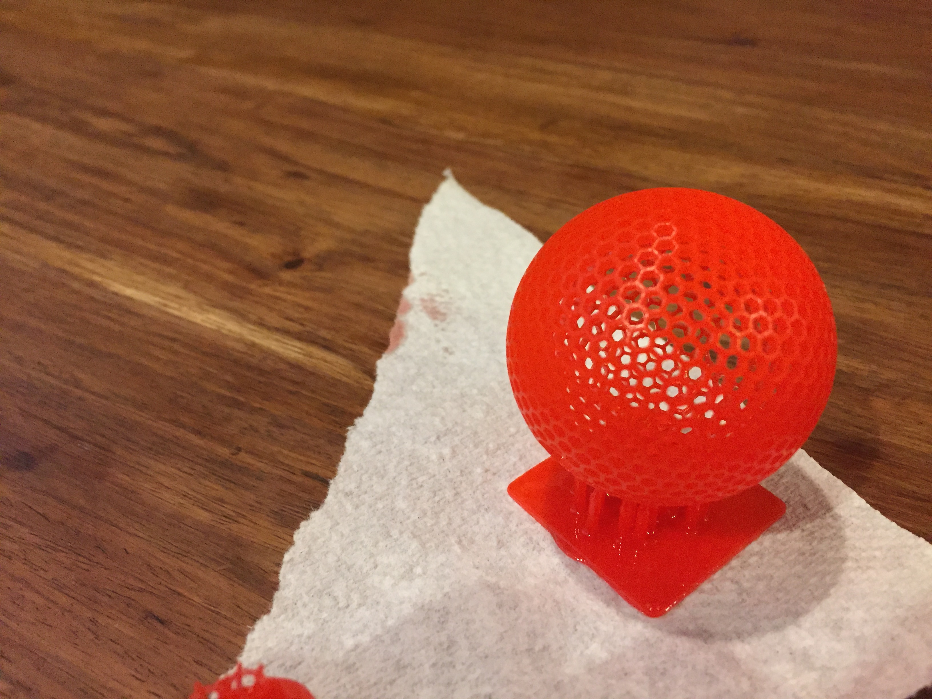

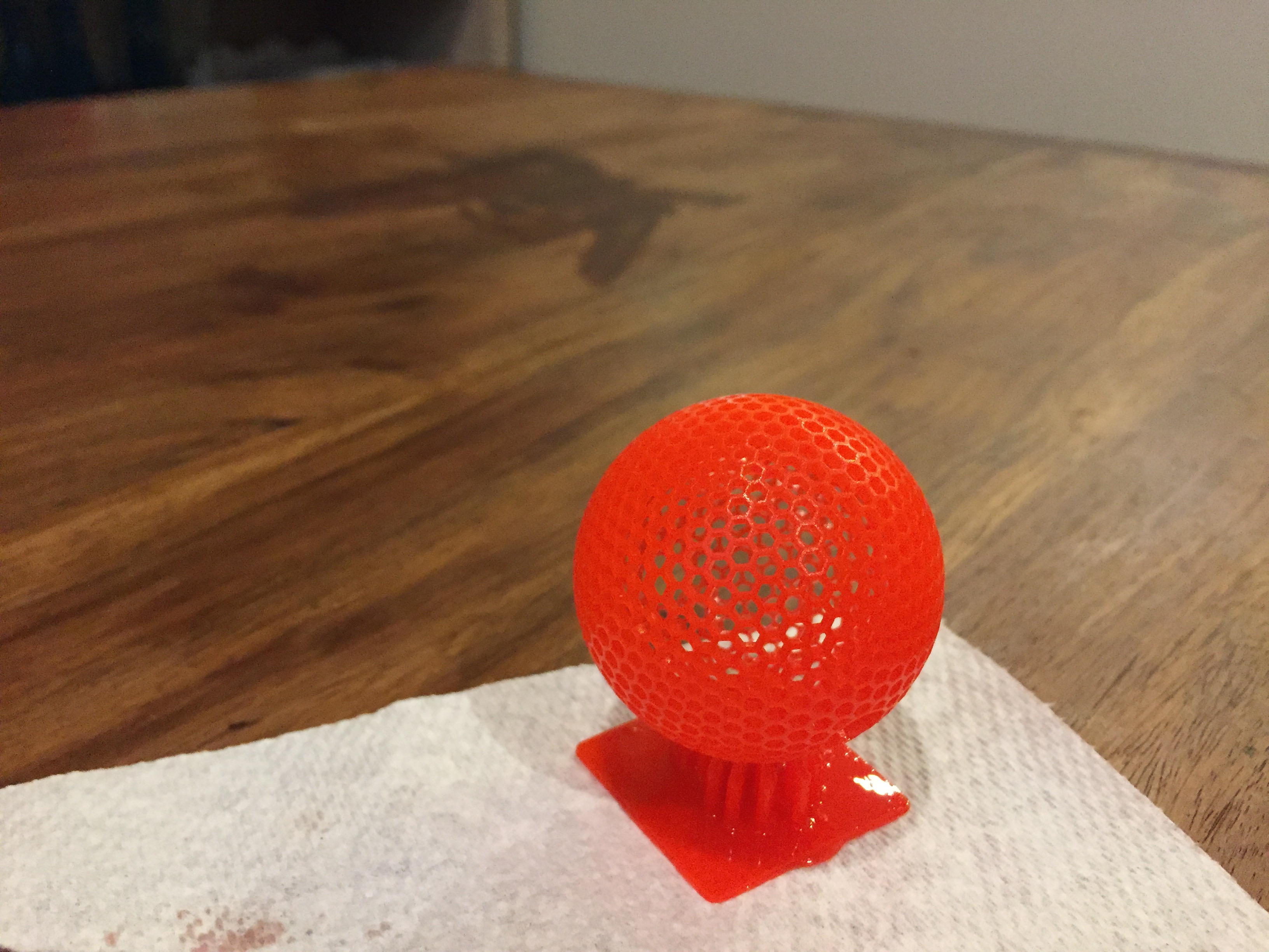

Postby hp_ » Fri Dec 02, 2016 12:00 pm

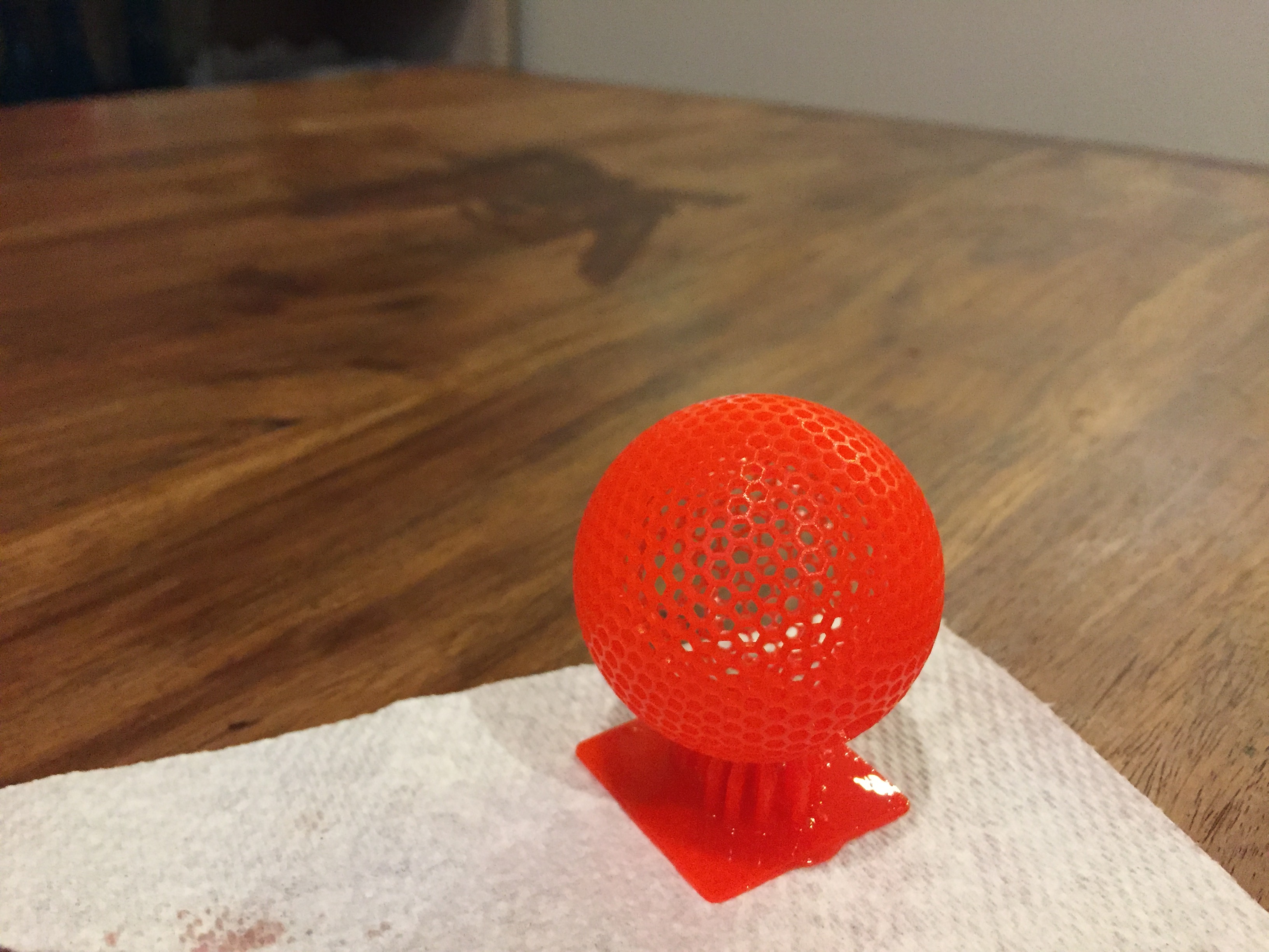

some new results on the printer, and I was not disappointed. really great results.
i've printed the hexball from , math model

Postby hp_ » Fri Dec 02, 2016 4:36 pm
Sodium,
7 seconds per layer can work.
I've now increased to 7.8 seconds to see results. mainly i want to check results in the corners of the print area. to see the weakness
I also want to try the daylight resin soon see speed on those..
honest expectation of the daylight resin, cutting the layer time in half.. hopefully getting to 3.5 seconds..
but i'm really ok with 7 seconds the printer just prints and has a nice build area
