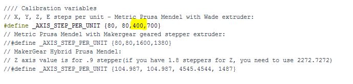

[quote="mandrea"]Good news on the front " Z axle ": I modified the shaft with a pitch 2, I added a screw anti backlash with amazing result, no more waving effect ...
Does it have the same step ?
mandrea
- Posts: 36
the original screw makes a z shift of about 3 mm per revolution, I use one that makes 9 mm per revolution

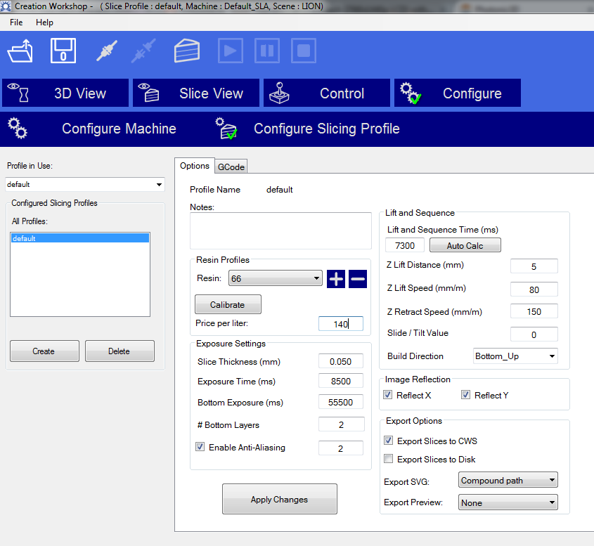

Hi all. I'm new in this forum and new user KLD-LCD1260 with Pi3 from Mongolia. Sorry for my bad english. I used first time SlA printer. I bought maker juice castable resin. i have some question.
1. some one used this resin?
2. how to setup printer to resin?
3. how to setup first layers time and next layers?

Hi mandrea,
I have one of these: https://www.amazon.co.uk/gp/product/B01 ... UTF8&psc=1
, but after connecting it only a does a slight movement and never anything more.
Do I need to set something in sprinter?
Thanks in advance.
