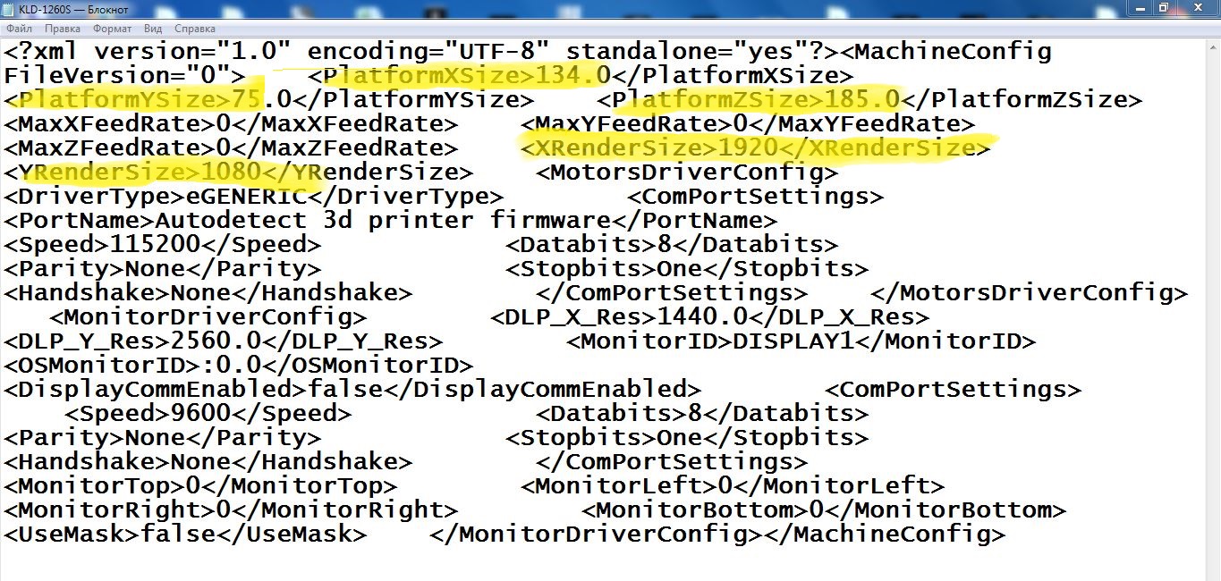

Hi
Creation Workshop does not see the printer. I have an updated version with Pi3
Resin sticks to the platform and Teflon
From the LogBindle file in the printer.
Not the correct settings in my opinion
