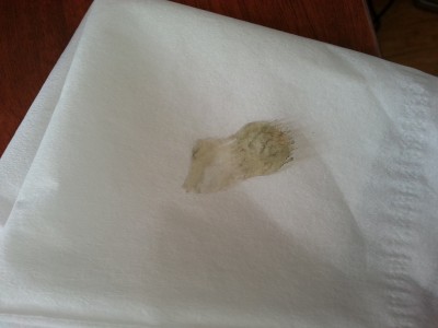

This is the first layer of the cured resin, it should be two circles. You can see the laser goes beyond the circles.

I'll look into why only the first layer is displayed. For now, I would recommend using the 'preview slice on display' checkbox to display the image on the laser. I'm going to put in additional debugging information in the debug log view to help see what's going on.
