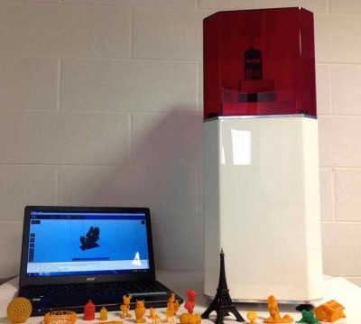

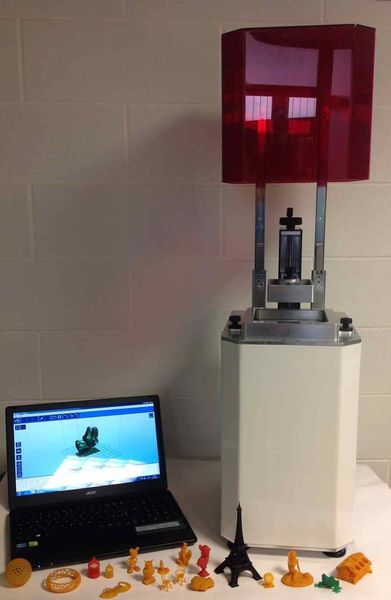

I'm Jody and I'm italian and after one years of work and test i made my 3d printer, called Totem3D.
the dimensions are 280 x 700 x365 cm and weighs 21kg. is made of machined aluminum with CNC machines and plastic outer cover.
the max print size are 102x77x130mm and i use a 1024x768 DLP projector.
the resolution is 0.1mm for x/y and 0.05mm in Z.
the vat use a little rotation slide for help the detachment of the piece and fep film in the bottom of the vat.
Totem 3D printer
- Posts: 277
Re: Totem 3D printer
Wow very nicely built, looks very consumer grade.
Do you have any details on the build or a blog? Would love to see how you went about building it. Thanks for sharing.
