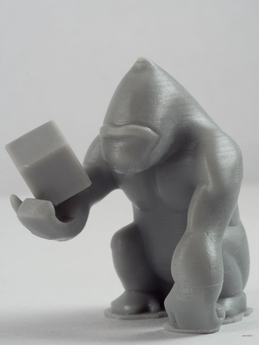

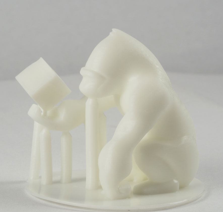

Here are a couple new prints using a true white and grey. Printed at 50xy 38z - Macro shots...the surface is very smooth!

Wow! the quality looks amazing on the print!

I am also impressed! What is the size of the printed object?

Thanks!! As the US distributor of Fun To Do resin I have the opportunity to test a few things, this one has me super excited. Strong and light, feels like plastic. Surface looks rough due to a macro lens, it's smooth!
Both are about 30 mm tall. There will be more goodies tomorrow, you'll really be impressed with the gray

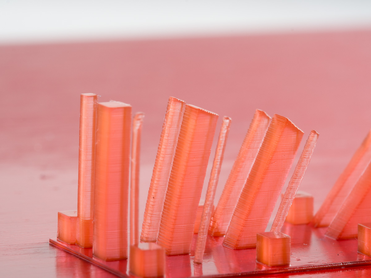

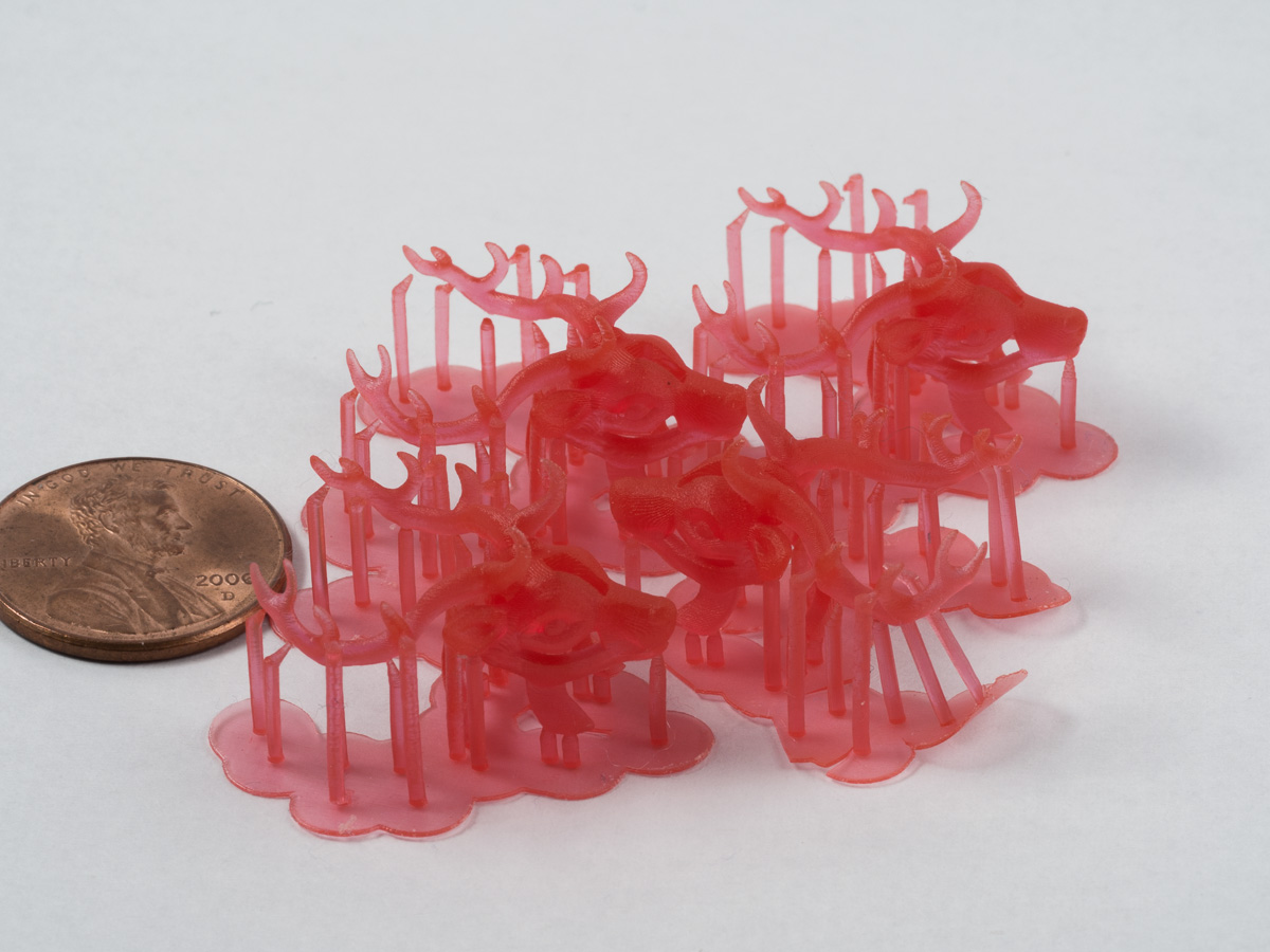

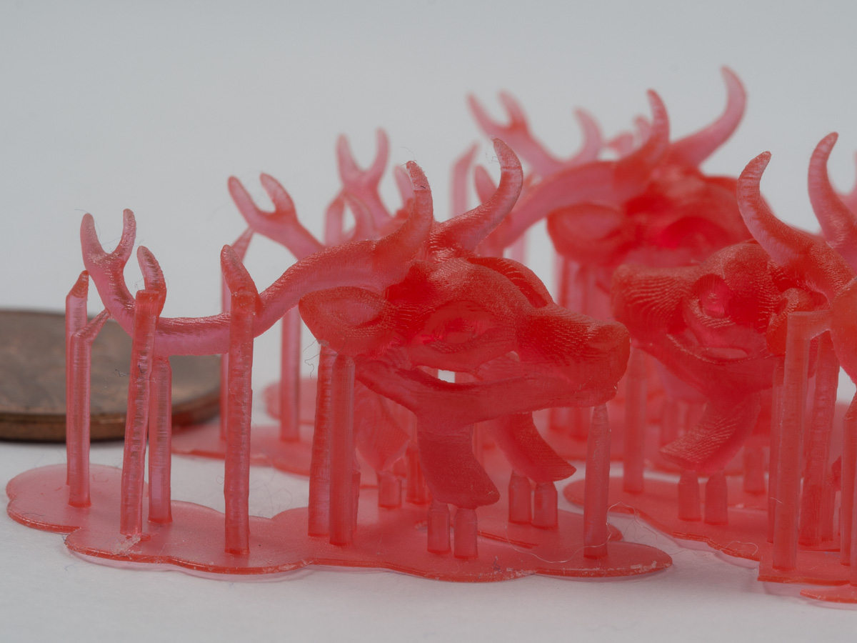

@adambx - I'm using both the IB and CB exclusively right now. I've got a large project underway which involves investment casting - printing pieces in IB for vulcanized molds and in general stronger pieces.
50um z slices work very well, attached are images using the SB Red straight out of the bottle, hopefully these will give you a better idea of achievable resolution without adding pigments. I believe all of these are at 50xy 50z.
