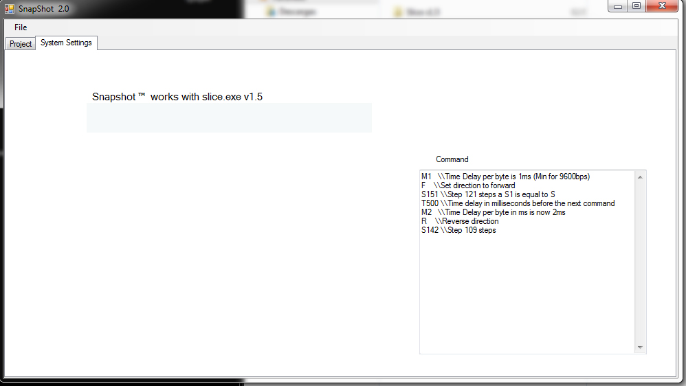

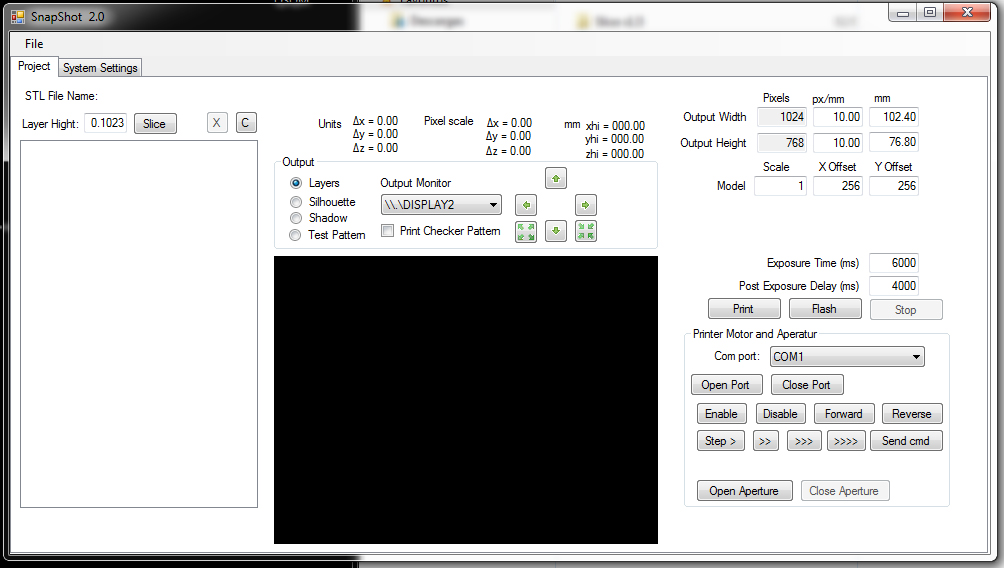

Looks like a standard Nema 17 motor and standard A4998 driver.
Not sure what firmware they run but you could put Teacup on there and should have no problem at all connecting with CW since Pronterface is used in this build with the same board/setup.
BTW that looks like a total rip off of Ron's software Flashpoint. Actually the whole printer looks like a clone of sorts.

Woho Actaully after looking through my bookmarkes it is an exact rip off of Ron's printer so if your just looking to get this up and going with new firmware here is a link to the docs on the Sedgwick. You might want to email Ron and let him know this company is cloning his printer just so he knows.

Does your printer use the belt drive for the Z axis as the Sedgwick does? If it does I believe the gearing on the belt drive limits the resolution so your simply not able to get any better resolution than the 100 micron it defaults to.
I just opened the Flashpoint software to look at it and it seems to work very similar to CW just without a bunch of the extra features and GUI interface. It should still easily print what you need with the limitations of the printer you have.
