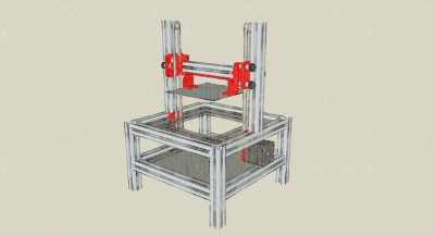

Hi Everyone
This is my first post. I'm in need of some help with my set up. I've built a few fused filament reprap machines and wanted to have a go at an SLA. The overall design has been done in Sketchup :-
I have connected up all my electronics, a cheap chinese 20K galvo connected to a LaserShark board and RAMPS 1.4 :-
and I have had the galvos moving. My issue is that I'm not sure it's moving correctly. There is a video here :-
http://youtu.be/OUbGrBGLUHA
I would appreciate it if someone could have a look and see if it looks o.k. The laser is a red one as my blue one hasn't arrived yet. I know I can't use it for actual printing but it should serve to test everything out. Any comments would be most appreciated.
Andy
