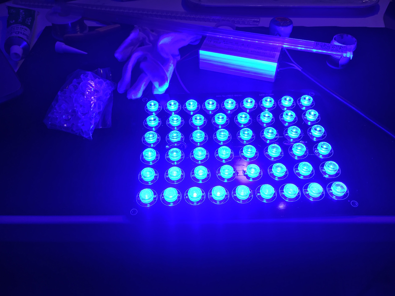

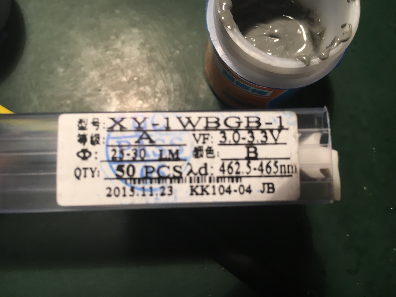

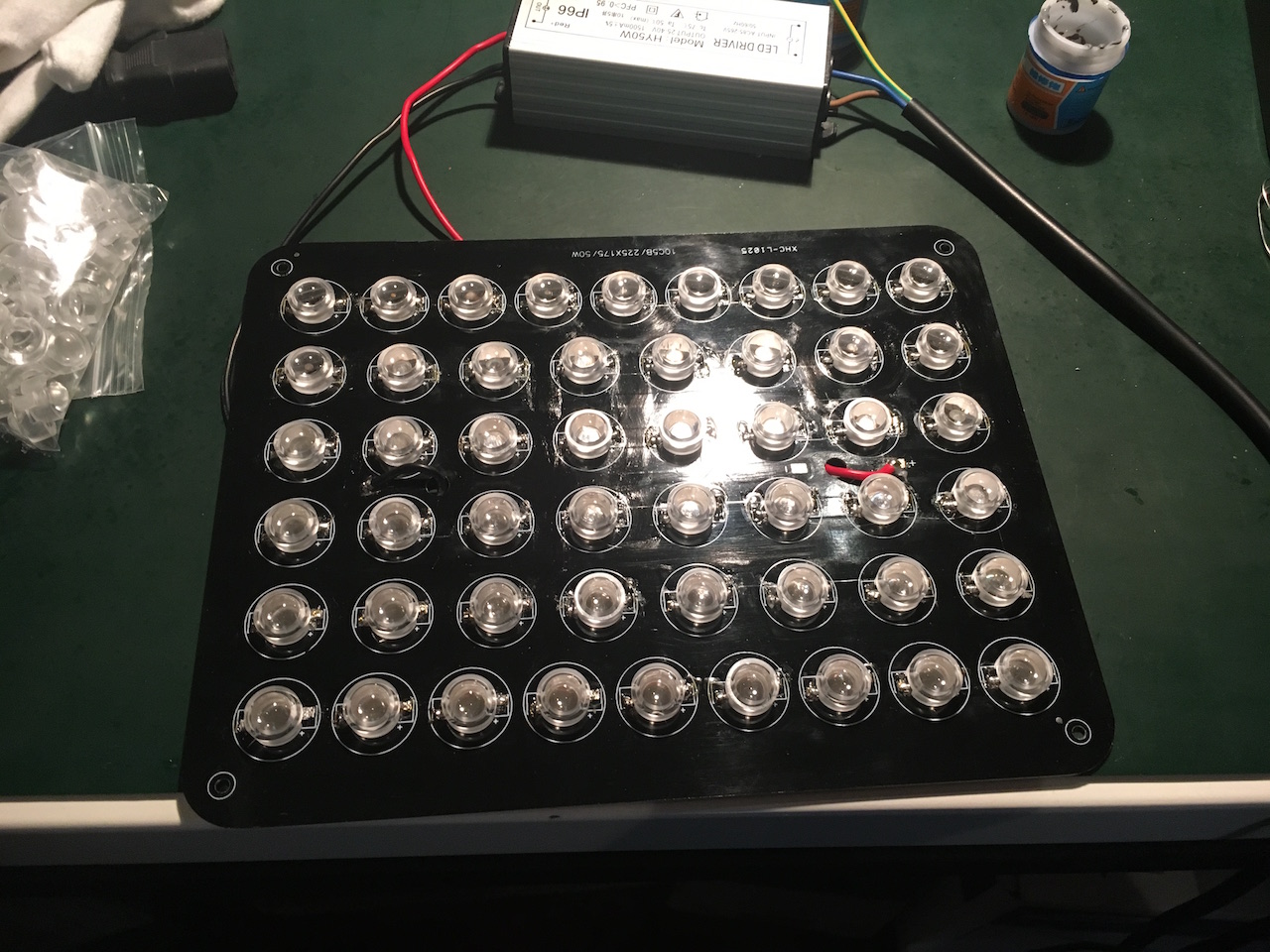

no supply problem here , just bought 4 pcs this morning .
I did also bought LEDs and lenses , soldering al afternoon here's the result
Next step , stripping one of my display , and wait for the resin to arrive to China ...

oliveenchine, excellent work!
My only worry is the spacing between the LEDs and getting an even cure across the surface of the LCD without hotspots. This is why Phife eventually had to make his own PCB with his UV setup. There are no off the shelf PCBs that have tightly packed LEDs.
It all comes down to array to screen distance and diffuser at this point. Since this resin cures with unmodified screens (that have diffusers) I doubt it will be an issue. Again great work and keep us updated.
