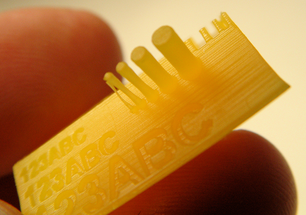

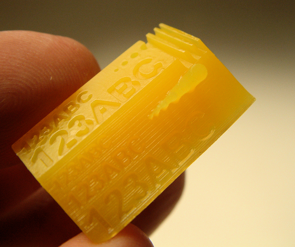

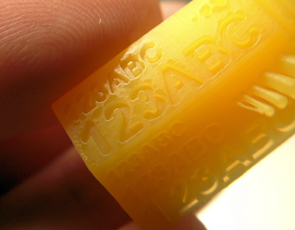

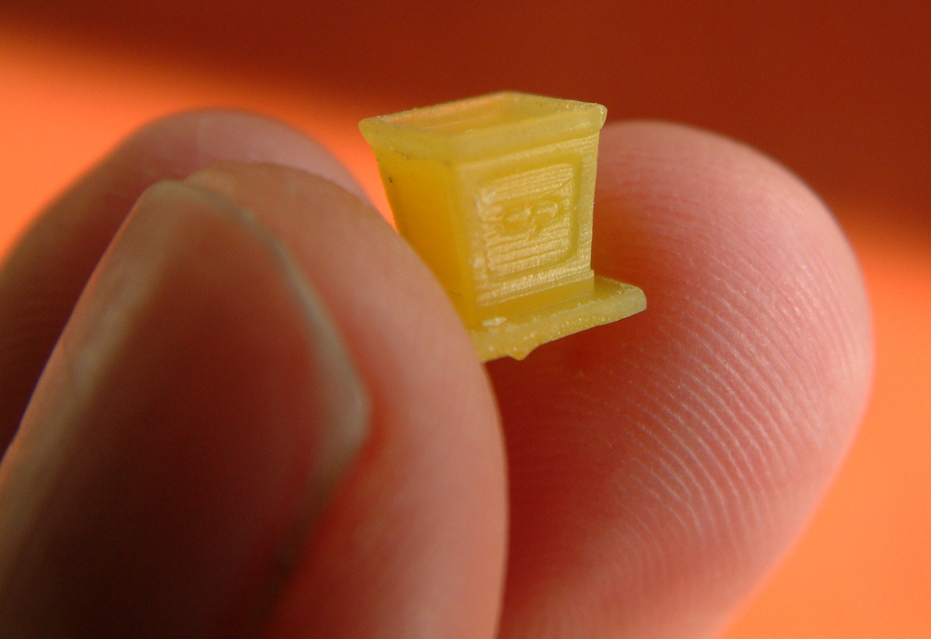

I'm using Spot A GP resin, the mix for the B9 and results are encouraging so far. I had some problems with base adhesion and I'm working on that right now. Yellow is not that great to photograph but here it is:

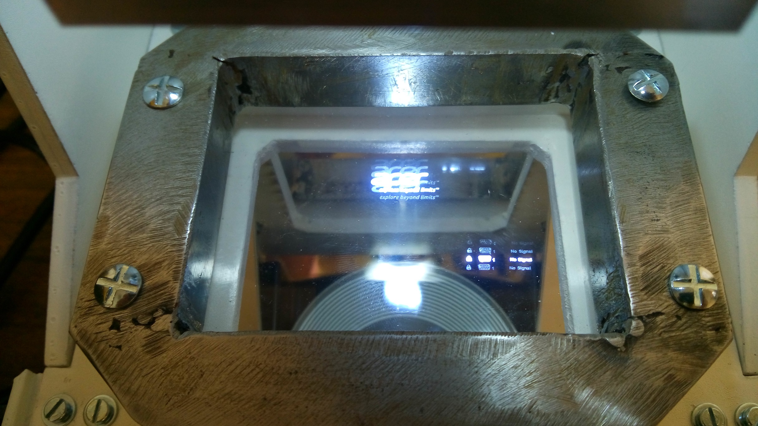

2015-09-03T12:33:58-04:00 2015-09-03T12:33:58-04:00 https://buildyourownsla.com/forum/viewtopic.php?t=3712&p=12190#p12190 <![CDATA[Re: [BUILD] My LittleRP clone "Snow White"]]>

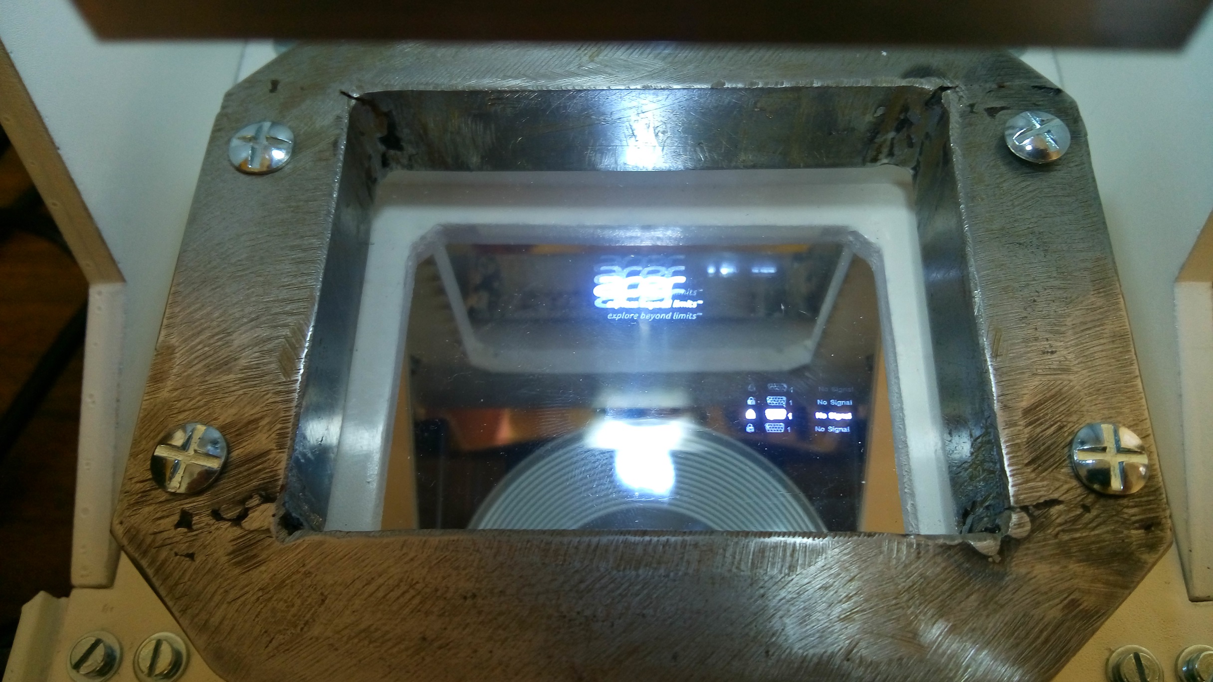

Unfortunately there's still one issue to adress, I have ghosts on the image projected in the vat. There's the main image an then there's 3 or 4 other images! I bought the mirror at a speciality house, it's a regular glass mirror, is this the problem?
Statistics: Posted by nalmeida — Thu Sep 03, 2015 12:33 pm

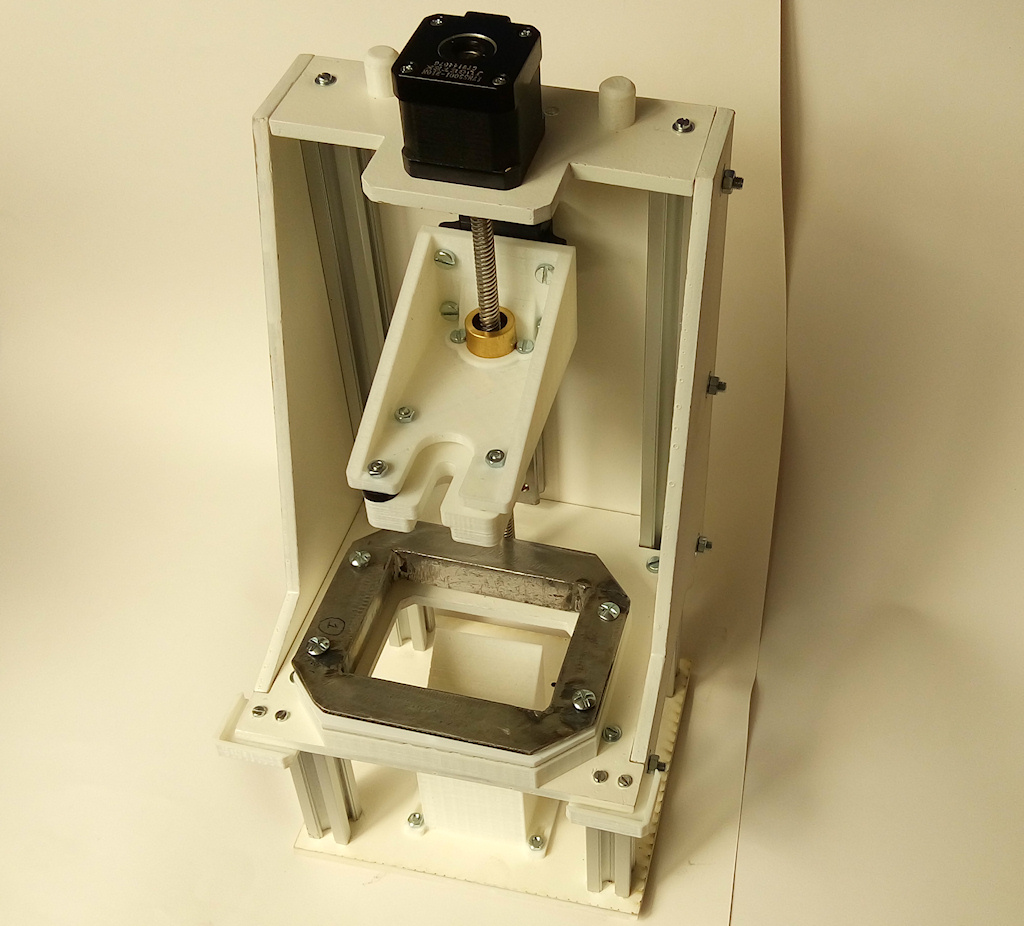

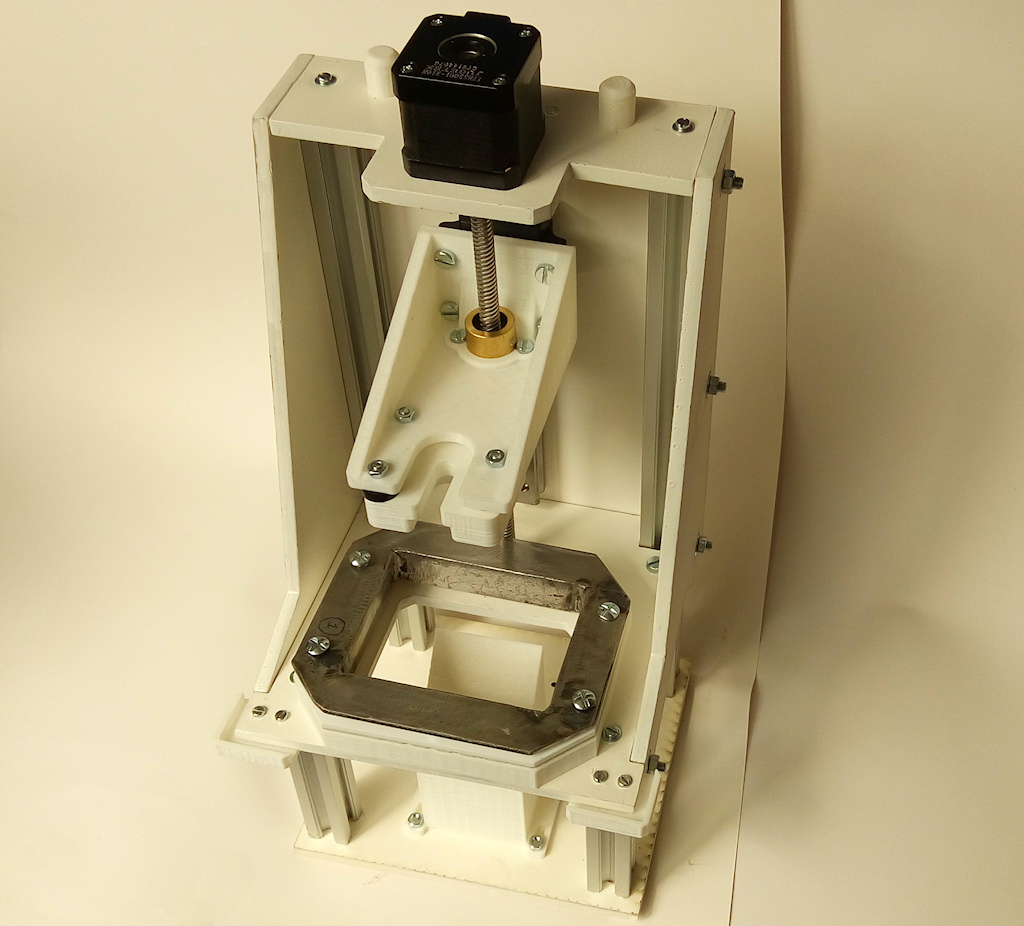

Still waiting for the PCB to arrive from the States and the motor from China, both are on the way here so hopefully this week I can progress a little bit further. The online store where I ordered the Acer 1283 messed up my order and sent me a Acer Travel C205 which is a Led projector and will not fit the project. Now I'm waiting for the replacement :-(

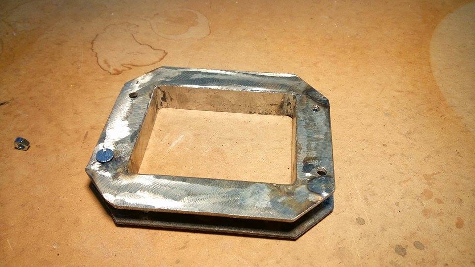

Meanwhile I worked on a vat design, since today I was on the mood I decided to grab some iron and a soldering machine and decided to do a metal vat, I will still print a part with PLA (the bottom part in which direction the FEP will tension). I decided to go with Nate's route and it's the upper part of the vat that will press the film to the bottom, this way the film will be approximately at the same height as the petri dish in the original design.
Here is a picture of the progress, still have to sand it:
Statistics: Posted by nalmeida — Mon Aug 24, 2015 5:54 pm
