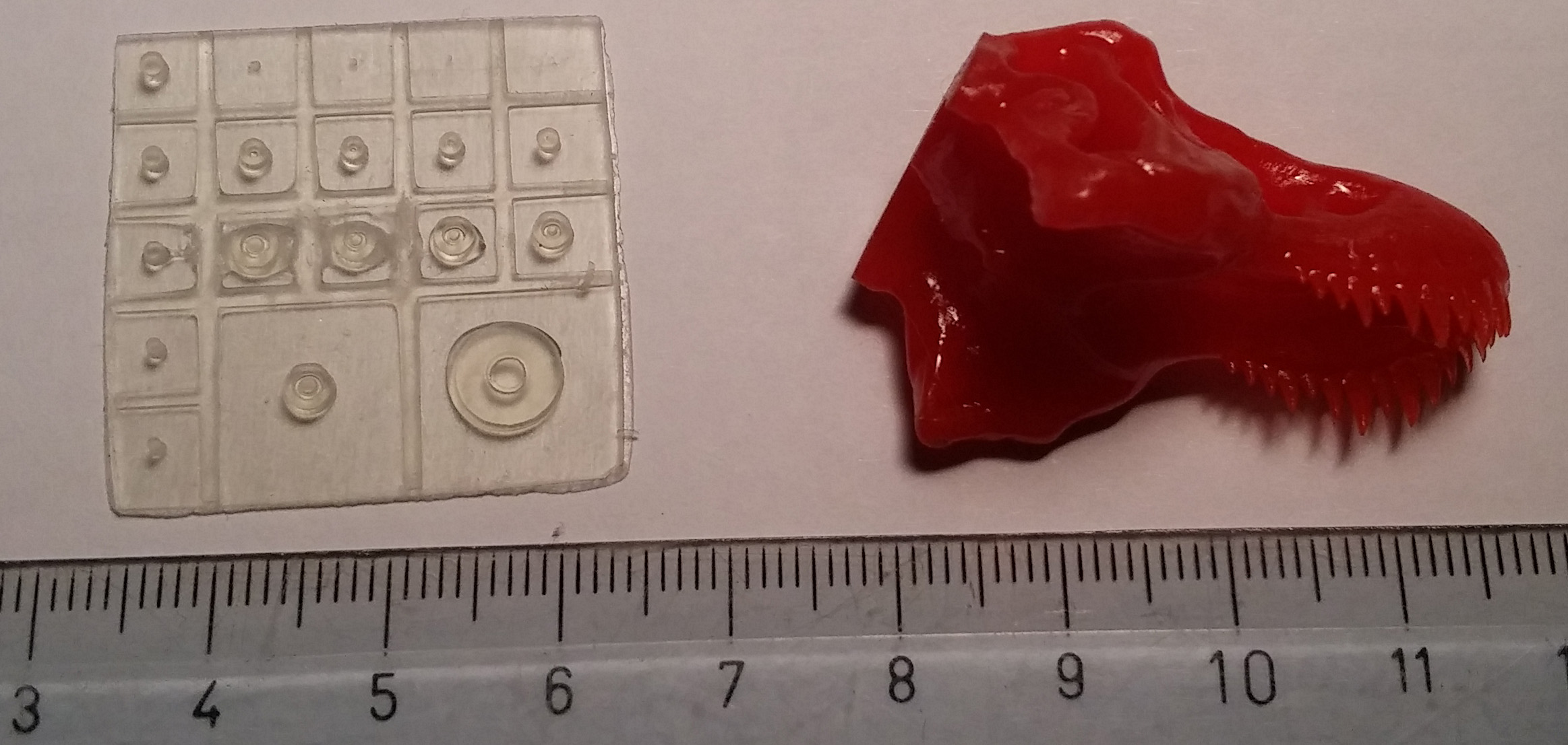

So the Machine profile changes the machine settings, i.e. everything that's controlled by the controller board, such as lifting the build plate, tilting the vat, operating a shutter, whatever, and the Resin profile relates to the projector, which is controlled by the computer, so exposure, bottom exposure, outlines and such.
As for the SolidRay, I have to say I'm quite happy with it; here's a pic of a couple of prints with MakerJuice (clear) and FunToDo resins (red):
As you can see, the Makerjuice resin is still a bit wonky but the FunToDo is fine with the kitprinter3d guys settings.
