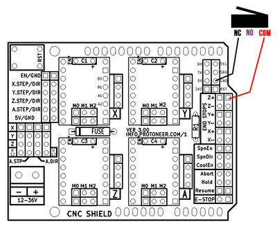

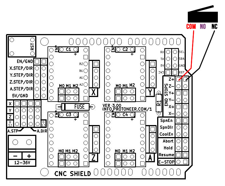

The first thing I would suggest is not using a limit switch at all, for two reasons:
1) The limit switch behavior in Grbl is a little bit weird, and will some times lock up all motion when it shouldn't.
2) It's extremely easy to manually home the DropLit. Push the build plate all the way down until it is touching the vat, and that's it! As long as you've removed "G28" from your starting Gcode, this should work perfectly.
If you are determined to use a switch, I can at least point you in the right direction. You're first configuration is definitely correct. The second one may work, but it's a bit unorthodox. You also might try switching to NO and ground -- it could be that your firmware settings just has that logic reversed.
Good luck, and let us know if you solve the problem!

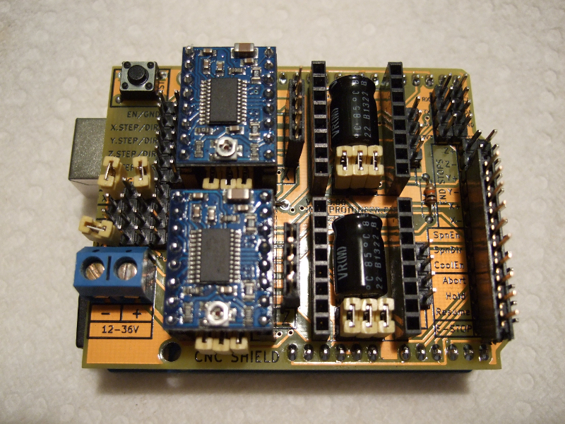

2014-01-09T12:13:24-04:00 2014-01-09T12:13:24-04:00 https://buildyourownsla.com/forum/viewtopic.php?t=4&p=266#p266 <![CDATA[Re: grbl firmware]]> I wanted to use a shield also but decided to order an EasyDriver, which looks pretty easy to set-up as well. While I waited for it, I set up a standard Stepper Driver I had laying around.
The greatest difficulty was configuring CW to work with my configuration, turns out some of my settings were wrong and now it is working like a charm on preliminary tests at least.

I have opted for grbl running on a uno for my dlp printer, with blue ice stepper drives and a protoneer shield, this makes for a small controller that can fit in a small corner somewhere, the only seller I could find for the grbl shield was from new zealand, only took 6 days to arrive in the UK.
As the PC must be connected to send images to the projector, no point having sd card support, or temperature stuff with ramps type boards,
