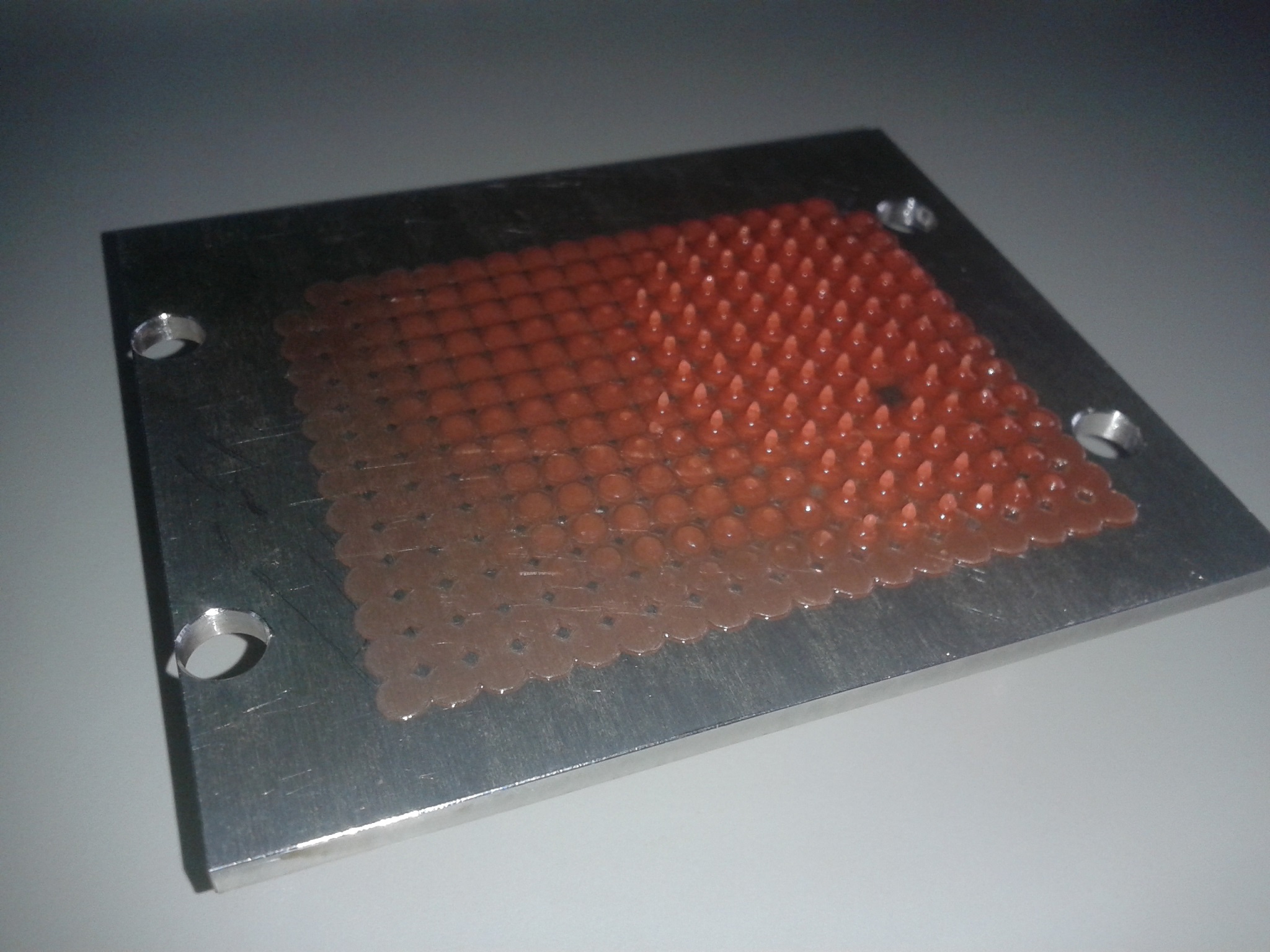

Build Your Own SLA/SLS A forum dedicated to helping you build your own SLA/SLS-based 3d printer 2014-05-12T11:08:15-04:00 https://buildyourownsla.com/forum/feed.php?f=9&t=1449 2014-05-12T11:08:15-04:00 2014-05-12T11:08:15-04:00 https://buildyourownsla.com/forum/viewtopic.php?t=1449&p=3590#p3590 <![CDATA[Re: Mysterious prints]]> ))
as I print pretty vast objects and this problem drives me mad...

2014-05-12T02:30:45-04:00 2014-05-12T02:30:45-04:00 https://buildyourownsla.com/forum/viewtopic.php?t=1449&p=3587#p3587 <![CDATA[Re: Mysterious prints]]> I'm going to try to generate a mask and show the result here.

2014-05-11T18:25:37-04:00 2014-05-11T18:25:37-04:00 https://buildyourownsla.com/forum/viewtopic.php?t=1449&p=3581#p3581 <![CDATA[Re: Mysterious prints]]> As I can understand all they have some sort of brightness concentrated in the middle and fading away to corners.
I couldn't do anything except for increasing cure time, but this unfortunately will probably burn your center area of the projection ...:*(
If you or anyone will find an alternative solution, this would be awesome to share here.

2014-05-09T09:49:00-04:00 2014-05-09T09:49:00-04:00 https://buildyourownsla.com/forum/viewtopic.php?t=1449&p=3559#p3559 <![CDATA[Mysterious prints]]> I'm trying to enlarge my printer. But now I have mysterious results. My prints are skew and so I tried to figure out the problem. I build just the supports of a plate but the result looks not very nice.
The only idea I have is that the power of the projector concentrate on the middle because the higher supports form nearly a circle.
Does someone have problems like that or an idea to handle it?
I'm using a Viewsonic pjd7820hd with 3000 Lumen.
The shown plate is 100mm x 120mm but the projector exposed an area of 268mm x 161mm
Regards Toby
PS: Sorry for my bad english ;)
